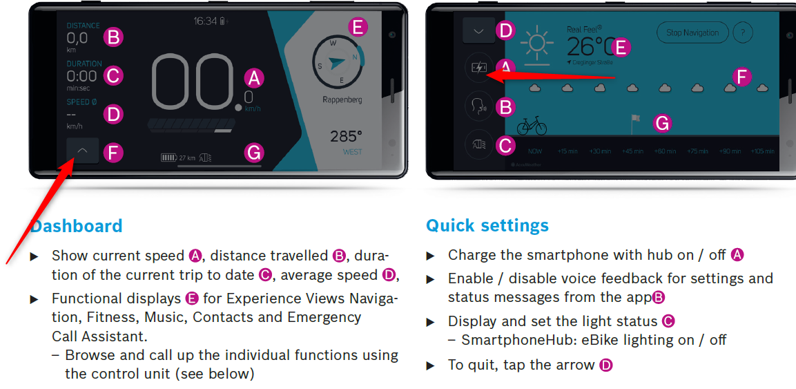

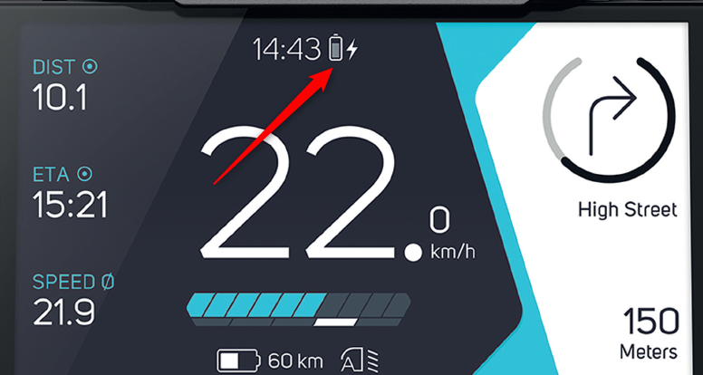

I have a new Trek Allant (ordered in April and delivered 30 days ago) and an iPhone 11 in a very thin silicone case and my iPhone in its silicone case fits fine in the Bosch bracket. The short charging cable that came with my Trek fits fine in the Bosch bracket as well as into my iPhone and I turn on COBI and the COBI app works fine. HOWEVER, the short iPhone charging cable "does not" keep my iPhone at charged while riding. I always start with the iPhone at 100% charge and when I finish a 46 mile ride, my iPhone battery capacity is down to 15% remaining charge - on a shorter ride of 34 miles, the iPhone has only a 35% charge remaining. Thoughts?
It sounds like the charge port in the Cobi.Bike app is not on. Check the two attached photos and ensure you are getting the charge icon illuminated when the phone is plugged in.

OK thanks a bunch - I did that. Will the "Charge Icon" now stay illuminated every time I open the app, or will I need to turn it on each time I ride?

The charging setting should remain constant now that you have turned it on in the app.
