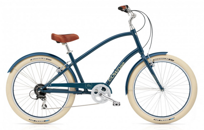

Townie go is reputed good for short people with the crank set forwards by I can't pry dimensions out of the website. https://electra.trekbikes.com/us/en...s/electra-e-bikes/recreation-e-bikes/c/EB280/ One reason I bought Yuba. They are so proud of the short people market they deleted my model.

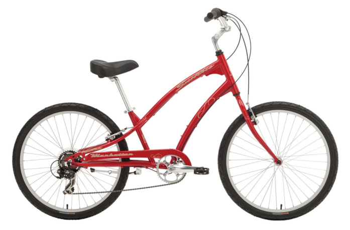

A Flatfoot AKA Crank Forward Bike will use your actual inseam to sit on the seat and have your feet firmly on firma terra. No jump down the dismount or climbing up to mount. ie/ Electra Townie, KHS Smoothies, and more. I especially like the step-through versions.
12 Crank-Forward bikes as an E-bike commuter

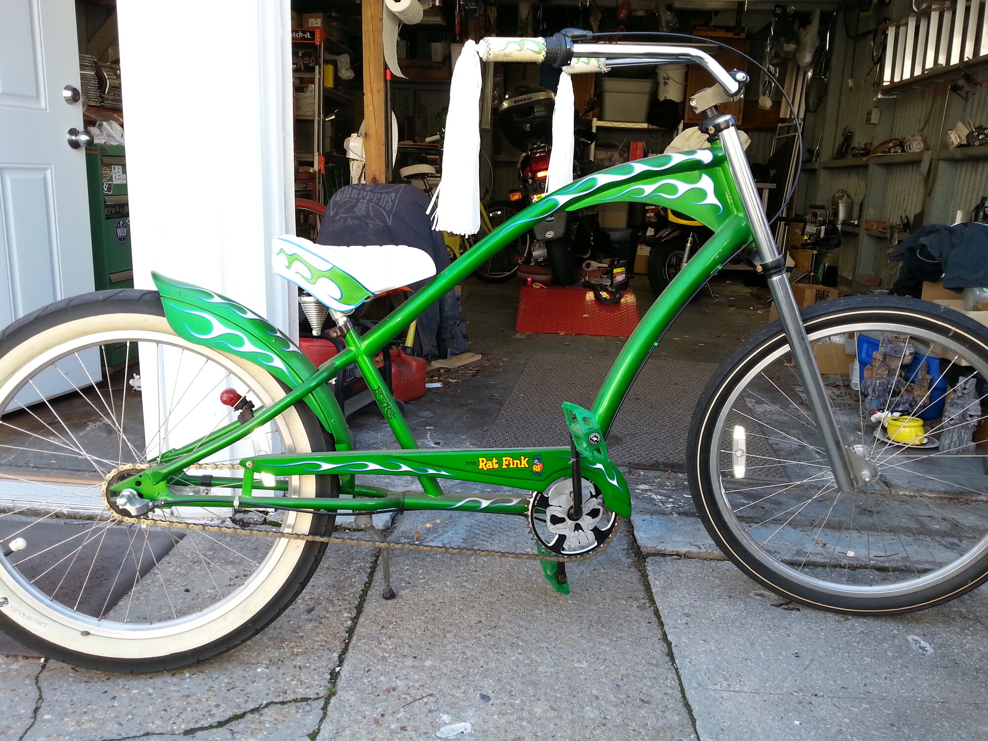

Electra Townie and E-Lux step-thus sit pretty low in the seating area. My wife is on the shorter side and has a Townie Rat Fink. Her sister, on the shorter side as well, has a RadMini ST and it also sits on the lower side.

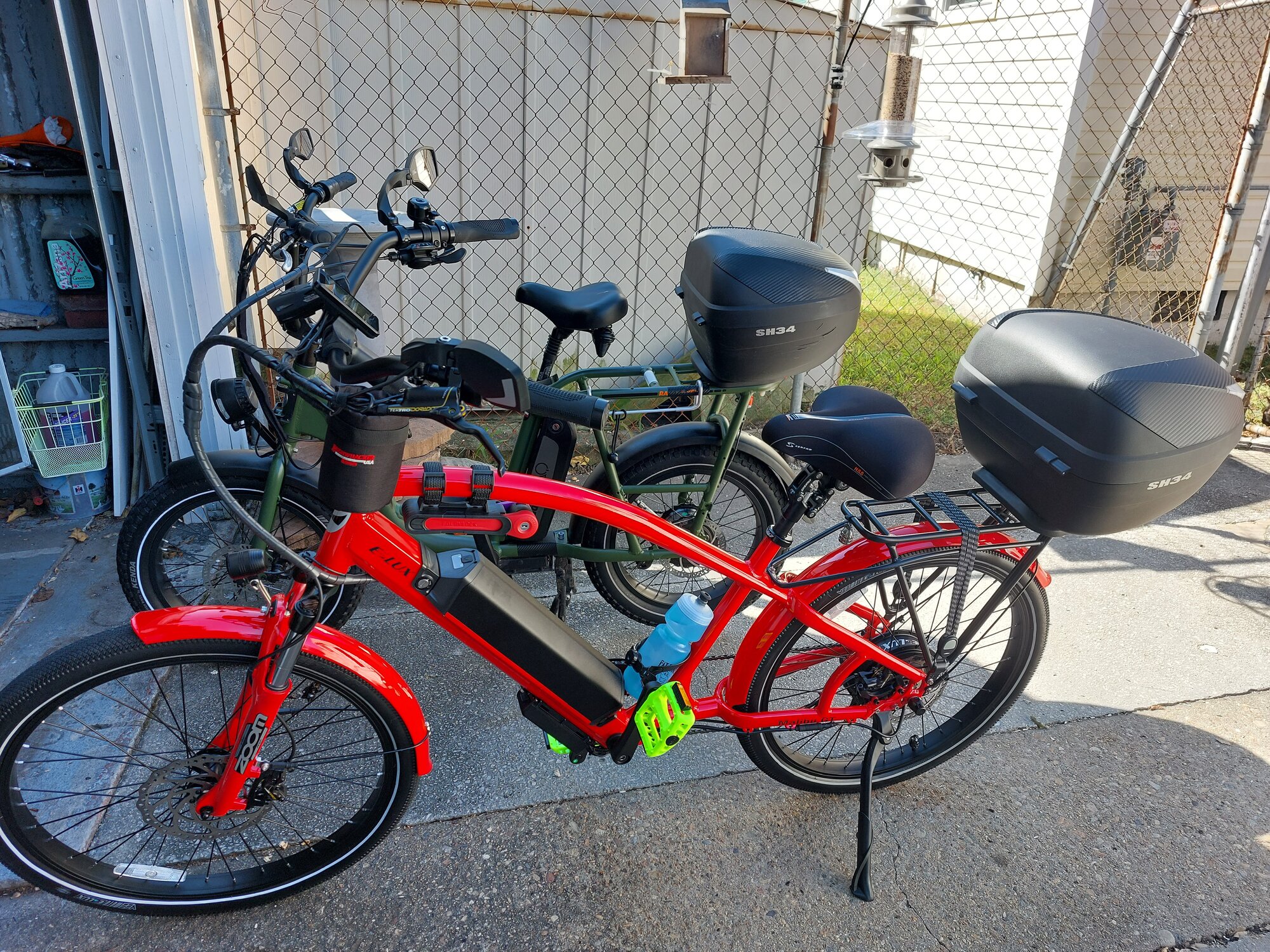

I put my E-Lux on consignment because it was just a handful on long (15 mile) and fast commutes. It was also not a step-thru and I was having trouble stepping over the top tube because I had a motorcycle trunk on the rear rack. Feet forward bikes are super comfortable but they make the front end really light and kinda floppy, plus they tend to be a tad longer in wheelbase than a conventional bicycle. But if your just kicking around and not trying to do 28mph in heavy traffic then one should be on your test drive list. I did a brief review of my E-Lux under the brand section.
Red E-Lux and my RadRunner. I'm 5'8", 32" inseam for size idea.
