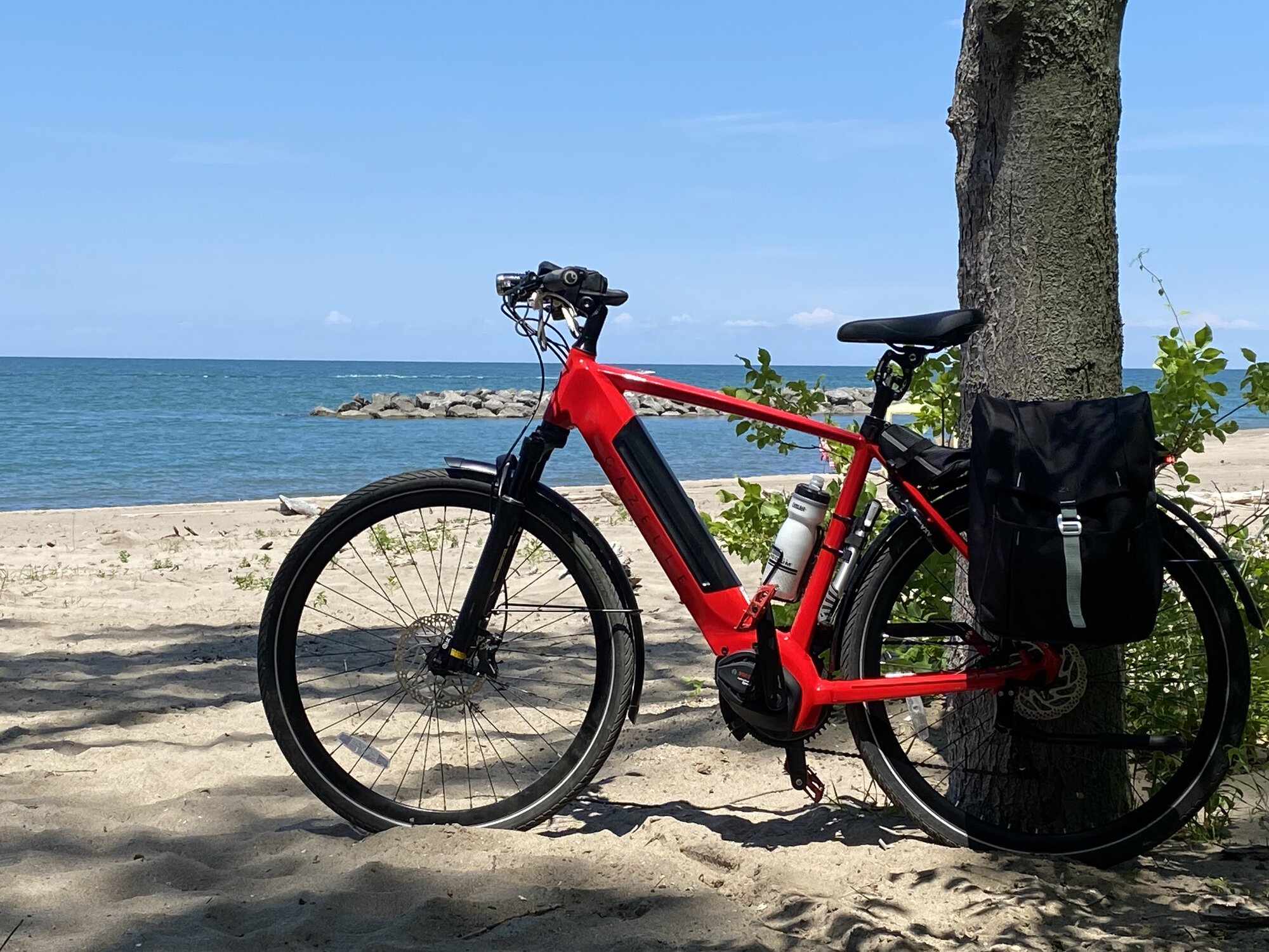

I have the 53 cm Ultimate T10+. Any dimensions I can measure for you? I am 6’0” with a 34 inch inseam. I find the high bar as high as I can comfortably straddle the bike. Any taller would be like a cheap hotel…..no ballroom. 😉

I have the 53 cm Ultimate T10+. Any dimensions I can measure for you? I am 6’0” with a 34 inch inseam. I find the high bar as high as I can comfortably straddle the bike. Any taller would be like a cheap hotel…..no ballroom. 😈😂

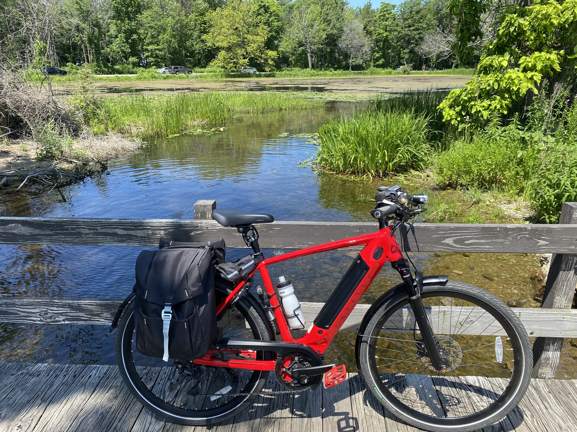

I do have a Shimano seat post suspension and with it I believe I am still at a 2-3” height. The performance of the suspension is incredible. As far as the Ultimate T-10+, the bike has been perfect from new, no issues, no adjustments, just go!! Gazelle makes an incredible bicycle. I do find the wheels are better suited for on road as they are a little narrow for sand and off road. But on road the bike is smooth, stable, and fast.
