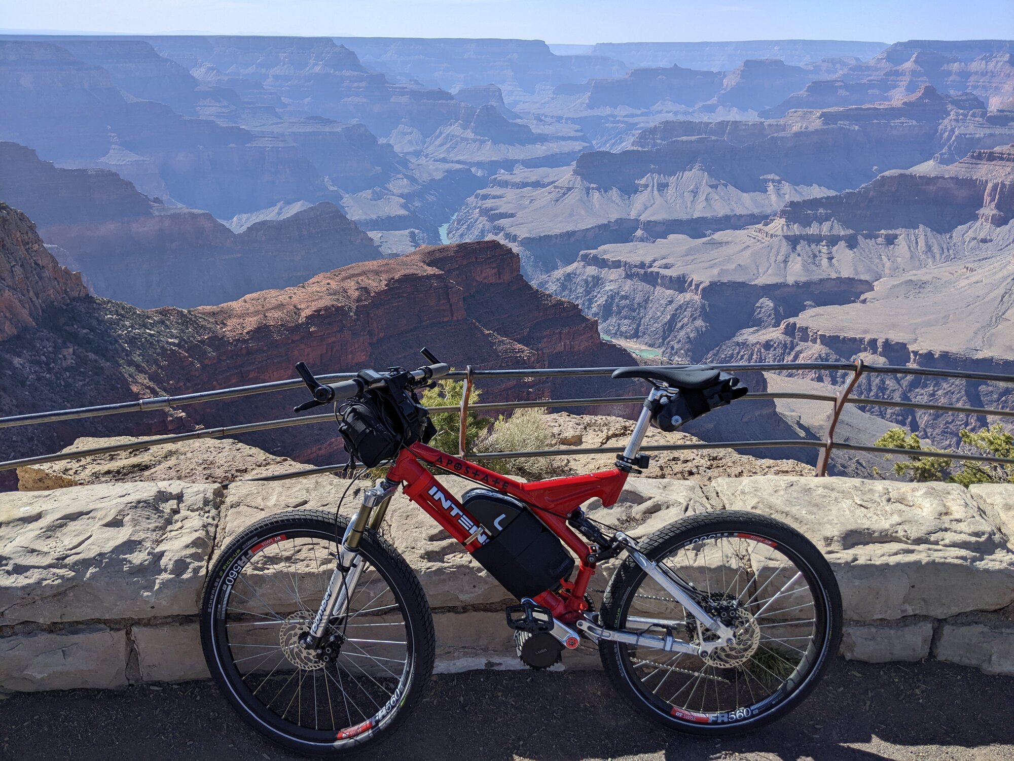

I built this bike a couple of years later. Just a 30a/52v Luna BBSHD. 26" wheels. Small and lightweight. This bike by far is my favorite off roader and short range bike. Not because of power but because it is small, lightweight, nimble and easy to pick up and pack into the car. The BBSHD with its 40T front ring and 46T big cog in back can pop the front wheel up no problem and I am still over 200 lbs.
So... MORE than enough power and I used gearing to my advantage to make that bike plenty-powerful for singletrack. No need to go up into power levels that will break stuff. I used steel cassette cluster and steel cassette body to ensure longevity.

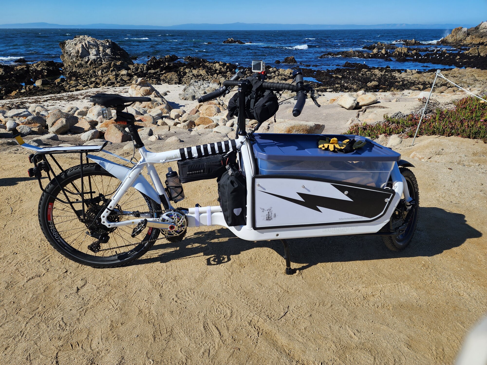

I think you are focusing on the wrong thing here. You use gears to get up a hill, not extreme power. here lookit:
That is a 28T front chainring. And on the back, I am using a pie plate cluster with a big 51T cog. I can climb ANYTHING on pedal assist with no trail at all, never mind singletrack. And as you can see that is not a petite bike. Those panniers (actually duffel bags) hold 168L each and one use for the bike is gathering wood for a campfire. And then there's this... this is my main daily driver. 'big' 42T ring up front, but a 48T cog in back, and that stuff in the box doesn't look like much, right? Thats 110 lbs of pea gravel. I will climb a 16% grade to get that gravel home.
I am cheating a little because that white bike is 2wd, but the front motor is only a 45 Nm geared hub so it helps, but its not a miracle worker. I'm sure you get the idea I am trying to put across here: More power is not the right answer. Especially since you will start breaking things once you get it.
