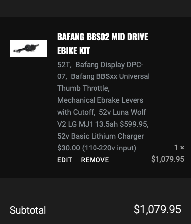

Um, sorry but when you look beyond the first listed price and put a kit in the cart... OVER $1100 with shipping cost added. A BBS02B would not be a good choice for a heavyweight rider.
BBS02B
You added a 52v Luna Wolf battery....well known that Luna sells overpriced batteries. But sure, keep on your weird power trip.

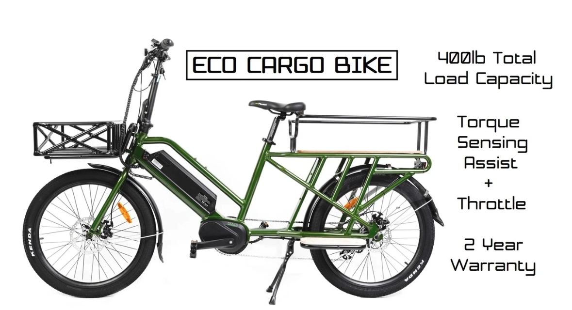

Bike Friday folding cargo bike. 385lb capacity, folds up into a suitcase. $2500, yeah, but less price unrealistic than some of the suggestions above. Also, they build to order and offer strength upgrades on other models, up to 550lb, so if you're interested it's worth asking. A buddy has their cargo bike, lives at elevation and uses it to schlep his gear to and from beach. https://www.bikefriday.com/folding-bikes/ever-e-day-electric-cargo-bike

Yep I was right, although this one is their mid drive model....which is a bit more pricey.
the bike looks awesome but I doubt such tubing is strong enough for 400 lbs. Cargo part looks solid enough but for his case we need to worry about seat tube carry the weight and bottom bracket (in this case motor bracket) and seat tube is the place which got most of the stress. The seat tube doesn't look designed for riders on heavier side. I think he better talk with the company and ask if they did such test. Because uniformly distributed 400 lbs isn't same as 400 lbs on one specific spot. Each time he jump over a pot hole the force he applied will be 2x...

Is it me or is the “Hercules” and “G20” the same as the other cargo bike I posted, same generic frame at least
