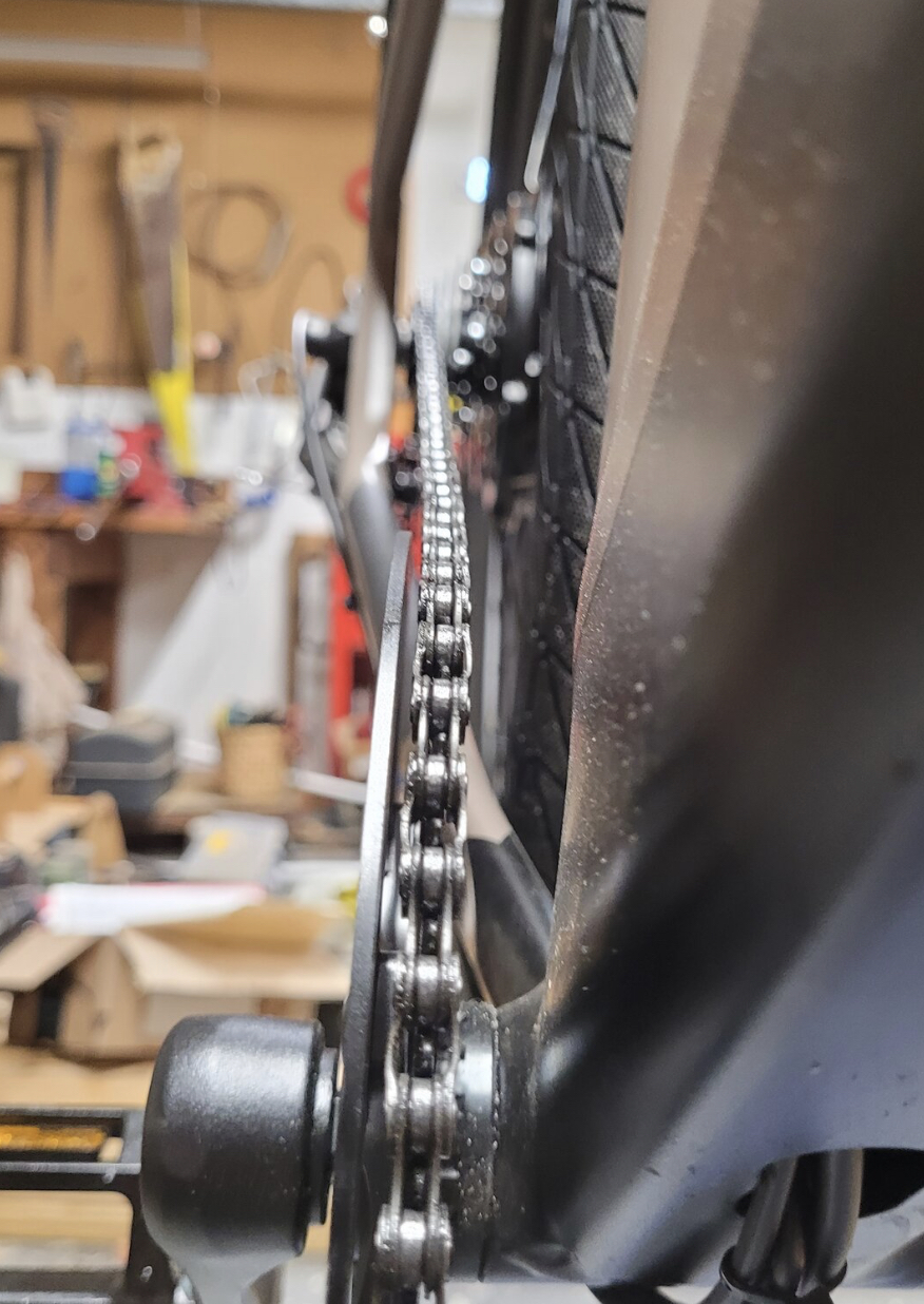

Here’s a pic of the chain angle as it enters the front chainring while in 8th gear from another LMT’D owner who was kind enough to share (chain angle as it enters front chainring is barely noticeable):

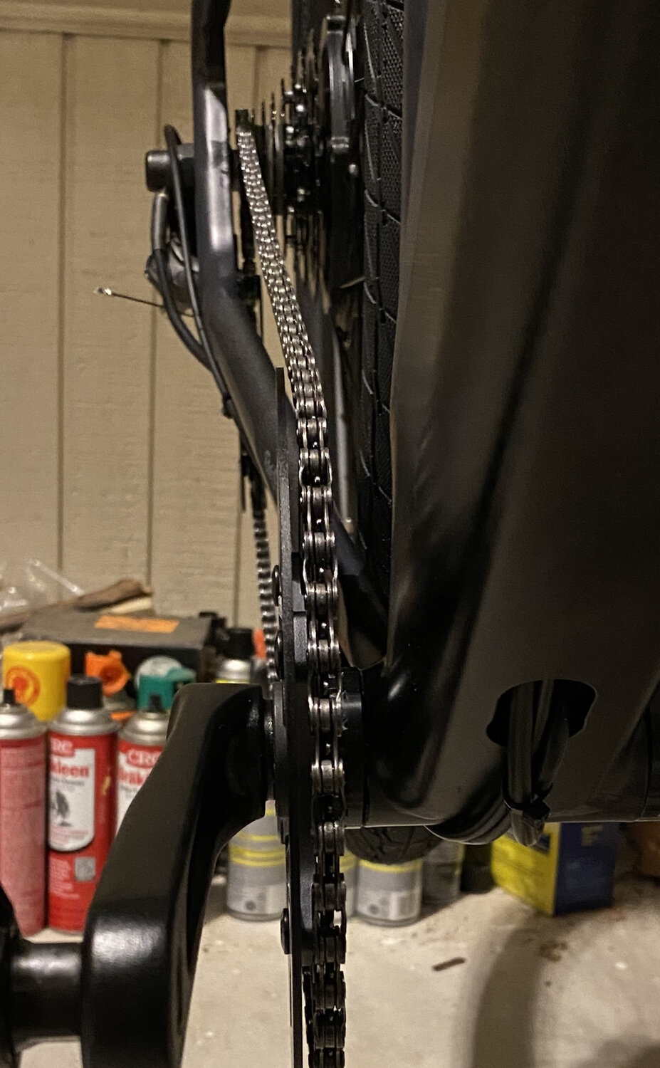

And here’s what that chain angle in 8th gear looks like on my LMT’D taken from the same perspective:
Just so you guys know we confirmed this was a frame alignment issue. Pretty obvious if you look at the above pics. The bike could have taken a punch while in transit or it could simply be the cumulative effect of frame manufacturing tolerances. No amount of band aid’s would have corrected this. Frustrating but Ride1up has been great. New bike is on the way.
