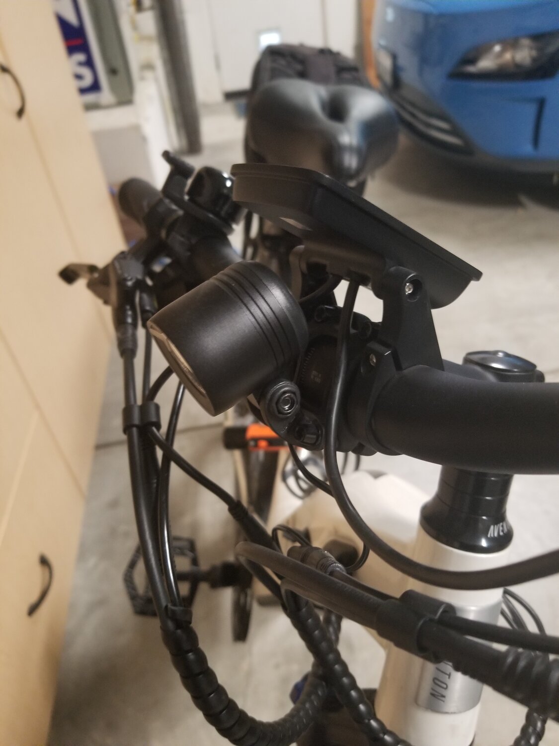

I've seen those. I have added Redshift stems to a few bikes. Level 2's stem includes the mount for the headlight. If you change out the stem you need to relocate the light...

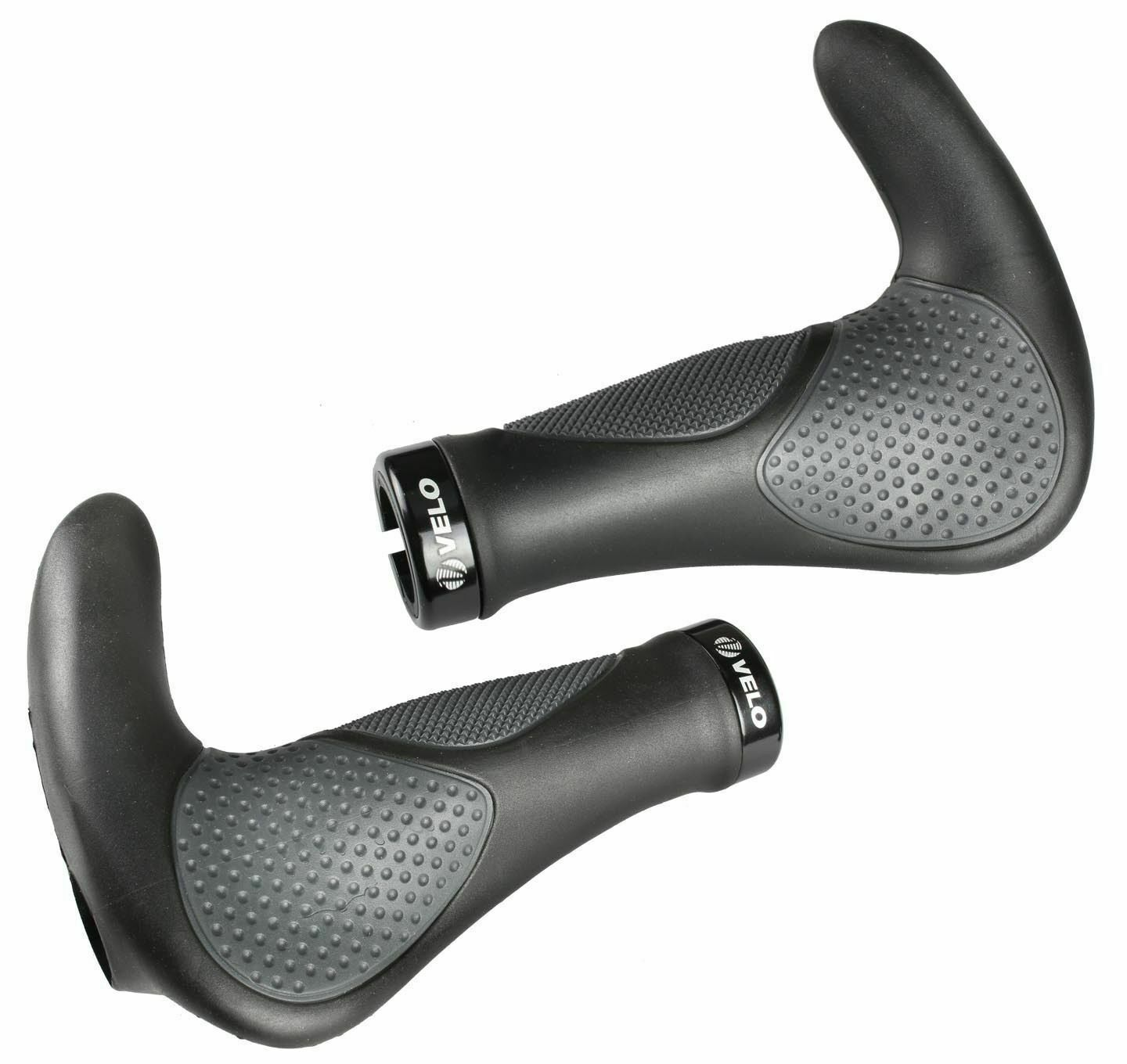

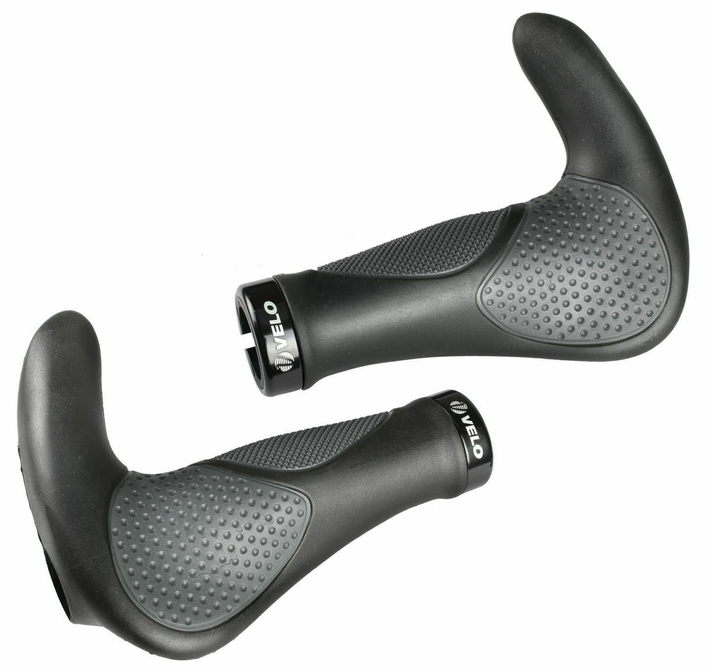

What grips did you end up getting. I am thinking of these from cycling deal
I got these in all black.

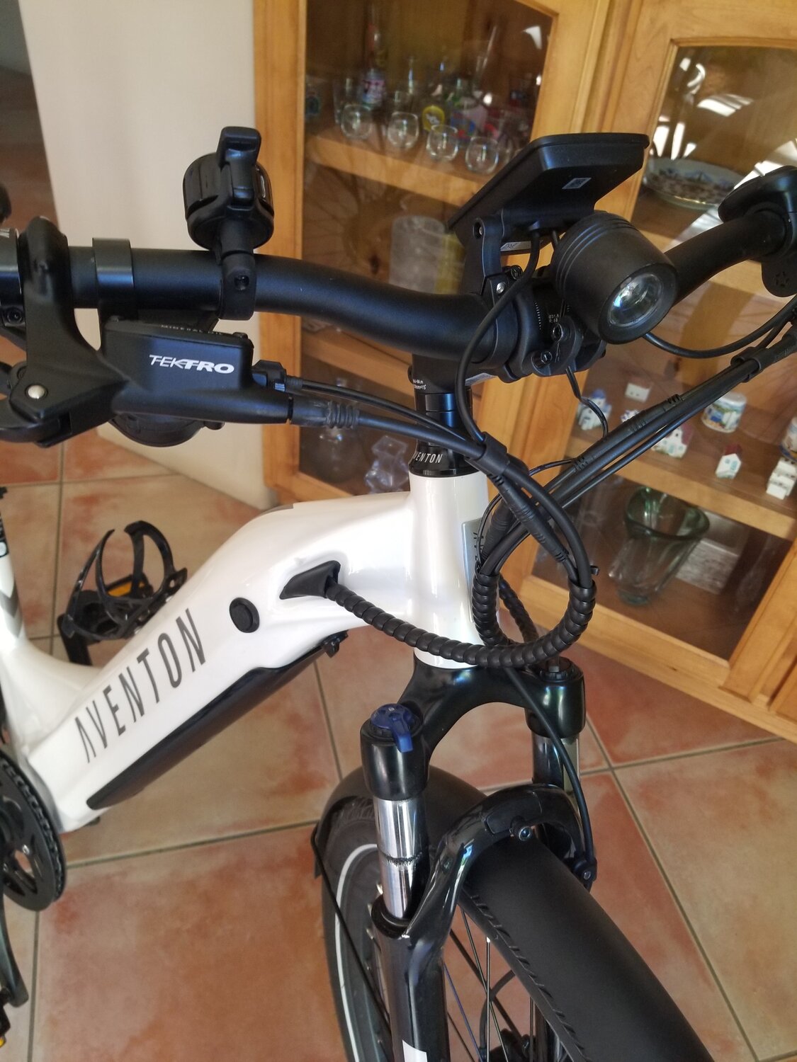

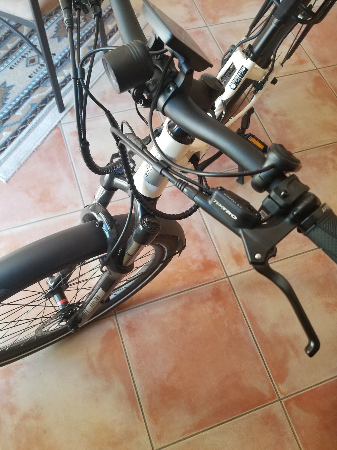

I just looked at my Level 2 and the front brake is not internally routed, just wrapped up with the binding tape the ebike builders use and looks pretty easy to change out. The rear brake on the other hand, is internally routed and might be more challenging of a fix. I would consider replacing my front brake as it is still real noisy when I apply a good stop. I have tried several times to bed the front brakes but it's still super loud.
For the front, how about cleaning the rotor with acetone and isopropyl, and using multi-metallic pads?
Pour some right between the pads and wipe the rotors. And work them rolling the bike. I expect a lot of black gunk will come off onto a paper towel.
I ended up buying longer brake line and a flush kit for about 25 bucks amazon. Little work but now the Lerway extender gave me about 3.5 inch rise.
