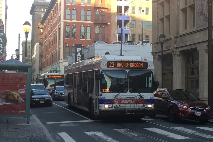

I had to close one eye looking at this nightmare picture you share. I would never.. ever choose to live in such hell. I have a hill phobia.
In my environ the devil is best know as SEPTA. I seek the magic power to be nimble enough not to be crushed by menacing buses, taxi, and rude suv/truck/car drivers singing odes to their depravities that only they enjoy while they wipe their lips clear of spittle with one hand.. while texting with the other.

A 250w mid-drive works fine for flatland commuting, and many 36v Class 1 ebikes at that price are relatively lighter weight (several are under 50lb) which helps if you do a multi modal commute and want to lift your ebike onto a bus bike rack like on that Septa bus photo posted above.
