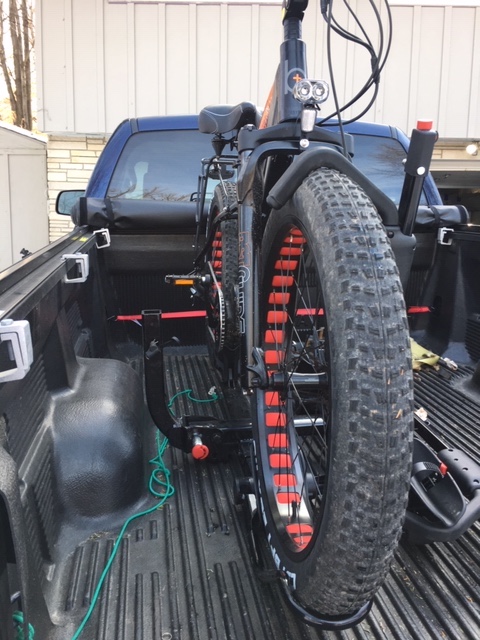

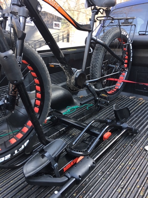

I have a full size tundra....I still opted for the hitch rack. I don't want to give up my bed space to haul other gear on trips!
But I do throw my fat tire in the bed in the winter to protect it from road salt. I literally throw the hitch rack in the bed and put the bike on it.
Works amazingly well.

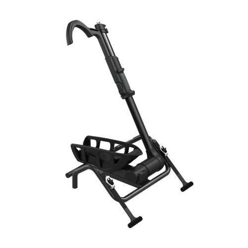

I've been using two Thule Insta-gator racks for about 3 or 4 years. Really works well. I've travelled hundreds of miles at highway speeds with two ebikes.
My version doesn't work for fat bike tires, but the new Pro version Thule now offers does.
The bikes don't get as much road grime and water off the truck tires and it leaves the hitch free for other duties.
