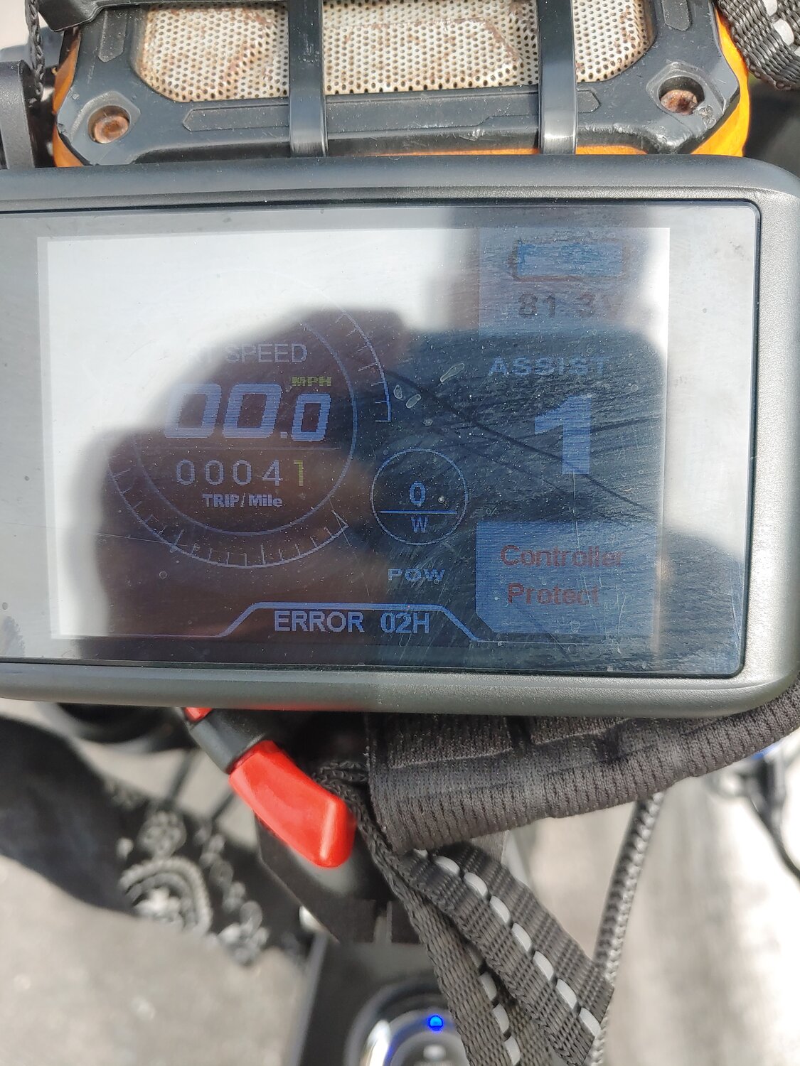

Experienced a clicking noise when peddling for about 2 weeks but that noise went away and have not heard it again. Only 7 days in I noticed the controller propelled the bike by itself while power was on and it fell on its side 5 feet from where it was parked. ?
Today 13th of november the bike let me stranded and had to get it home via pick up truck. Controller protect note on display with an error code of 02H ? I only took possession of this bike on 10/12/21. Trust me Its a nice bike, but if its not reliable thats a lot of money to pay for headaches. Has any one had any 02H codes and am I looking at a new controller ?
