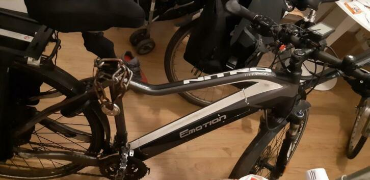

I have an BH nitrco city easy motion.

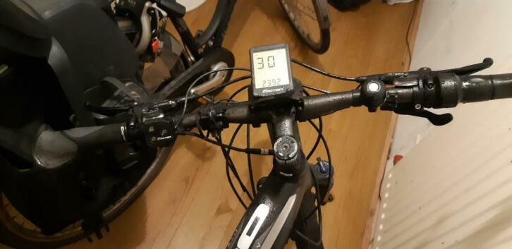

The controller doesnt seem to be working anymore (the thing on the left side with 3 buttons). Sometimes the bike turns on as soon as i put the battery inside (and it goes 20km/h on it's own!)
I don't know if it's because of the battery or the controller. When i try to turn it off (hold off button) it doesnt turn off. The display stays on. When i press speed up, it doesnt do anything. Same for speed down.
The battery charges fine.
What does work is the throttle (gas padel). I can go 20km/h with this. Sometimes it only works when i hold the down button. Sometimes the throttle works when i hold the up button. Sometimes the throttle just works.
Sometimes the display shows it is on full speed (4 lines). Sometimes the dispaly shows it's on no assist (no lines). But when i press speed up, or speed down it doesn't do anything. The display stays the same.
I have two questions:
1. is the controller broken (small square with the 3 buttons)? Or the battery?
2. If the controller is broken, anyone know where i can buy one for not too much? Or someone has a spare controller he wants to sell?

Thank you for your reply. I will try this. To be more specific, this is a video of the problem that occurs. When i turn the bike on (sometimes it turns on automaticly), i can't turn it off. When it does turn off it turns back on immidiatly. And the faster/slowers buttons don't seem to be responding.
