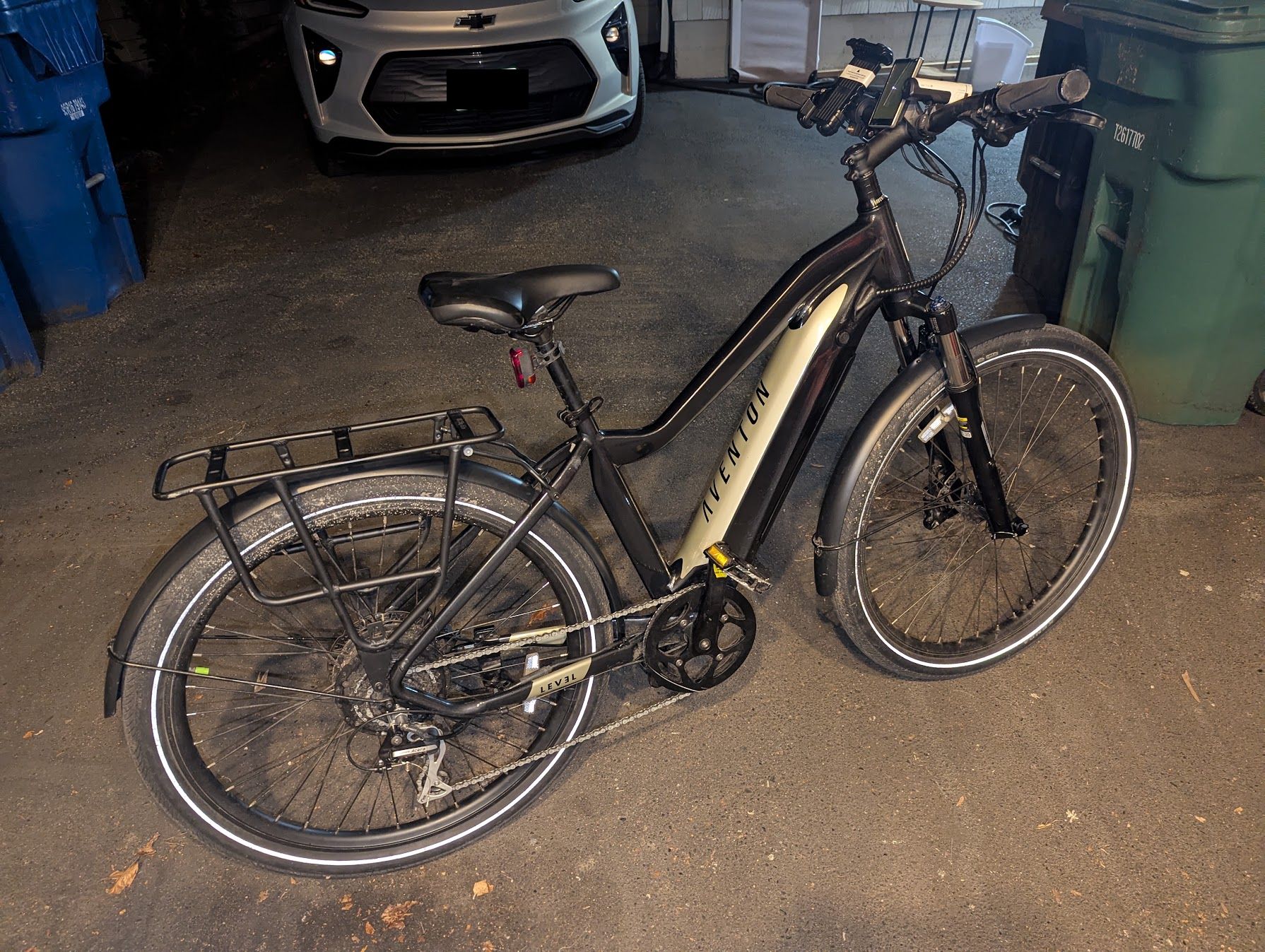

More continuing woes with my Level v1. Yesterday, one of the support bars on the saddle snapped! Never had that happen on a bike before. I dont weight alot, at 160 pounds so it was a surprise. Going to have to check out a new one unless this can also be replaced under warranty. The metal on the seat seems flimsy, like a cheap Walmart bike, not something that set me back almost 4 Grand CAD. I dunno. Can the bar be replaced? I looked at the seat with a magnifier and it looks like the bars are screwed in, so maybe. Still, the seat is uncomfortable on long rides.
Still waiting for the bike shop to get in my replacement instrument panel and HD brake shoes. Its been several weeks now.
Wondering what else is going to go wrong with this bike and if I should be looking at a replacement after only a year of use...
I am heavier and after enough bumps, 2 weeks ago a saddle bar bent. Shortly after the Level was new, the "weld' on the seat post and the bracket above it failed and the seat could rotate and the saddle could be lifted up. They do not stock parts very well at all.
