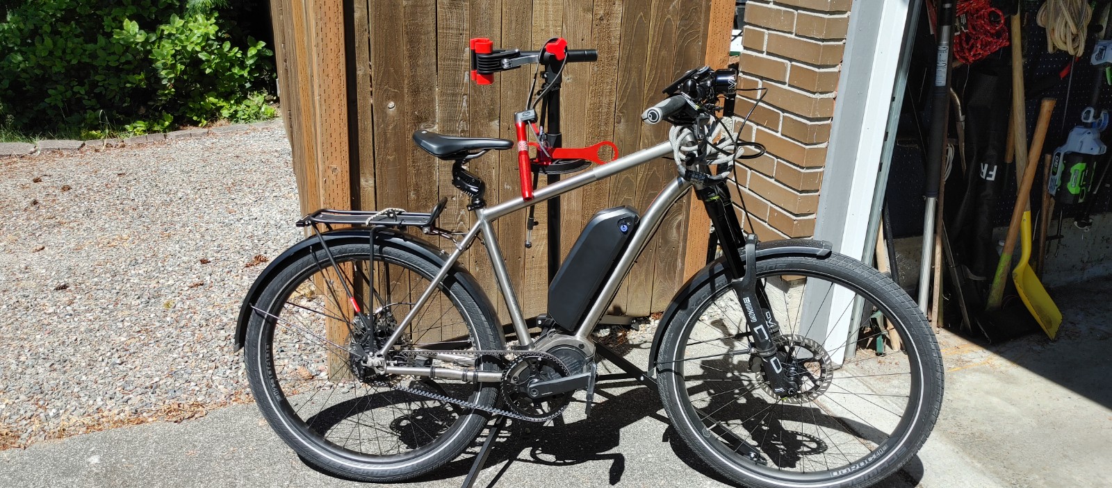

What's the procedure for doing the flush? Is it pour in 20ml, put the plug back in, swirling the hub/wheel around, then drain?
Yes put oil in, close the hub, go for a short ride changing gears, come back flush again

Went for a 50km ride a couple of days ago, with an even spilt of pavement and dirt trails.
I love this bike and I LOVE my Kindernay hub. Even though it only has 7 gears I can easily climb a steep trail (for me) and can also easily hit 50kph (30 mph) on the pavement.
I went for another ride on my Hydra yesterday (80% pavement and 20% bike paths).
I'm becoming for familiar with the Kindernay 7 speed and I'm very happy with its overall shifting performance.
One thing I've noticed is the smoothest shifting occurs when stop pedalling for a second or two. Shifts are okay under a light load pedalling, but with anything more than a light load I notice the shifts becoming harder to implement and on the harsh side.
It's just the opposite of a regular derailleur.
I REALLY wish my UC Pro had come with the Kindernay hub.
Yes on harsh shifting under load. The IV is like that too. Youtube videos when the 14 was first released were prominently saying that that was the case with Kindernay.
