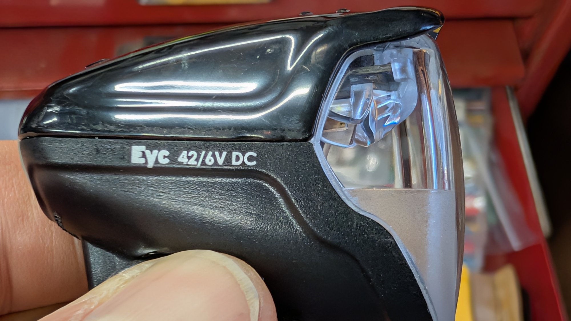

Is this Busch & Müller "Eyc 42/6V" the voltage range?
speedub.nate
Oakland
I have this 7 year old B+M Lumotec headlight and on the side I thought it was indicating Eyc 42 model that runs on 6 volts.
Now after websearching I'm not positive but am thinking I'm mistaken, that this is an Eyc model indicating it is good for 6V to 42V.
I initially installed this on a Shimano E6000 motor that had 6v headlight output, now looking to install it on an E6100 that Shimano has changed to 12v light output.
Thanks @RunForTheHills .
I found my receipt from SJS, April 2020
"Busch & Muller Lumotec IQ2 Eyc E 50 Lux E-Bike Headlight" Doesn't say "IQ" anywhere on the light housing so thought that was a newer model.
The non-conventional order on which they print 42/6 is on the housing is a little frustrating. It didn't help that they had some 6v specific E-bike lights during that time.
