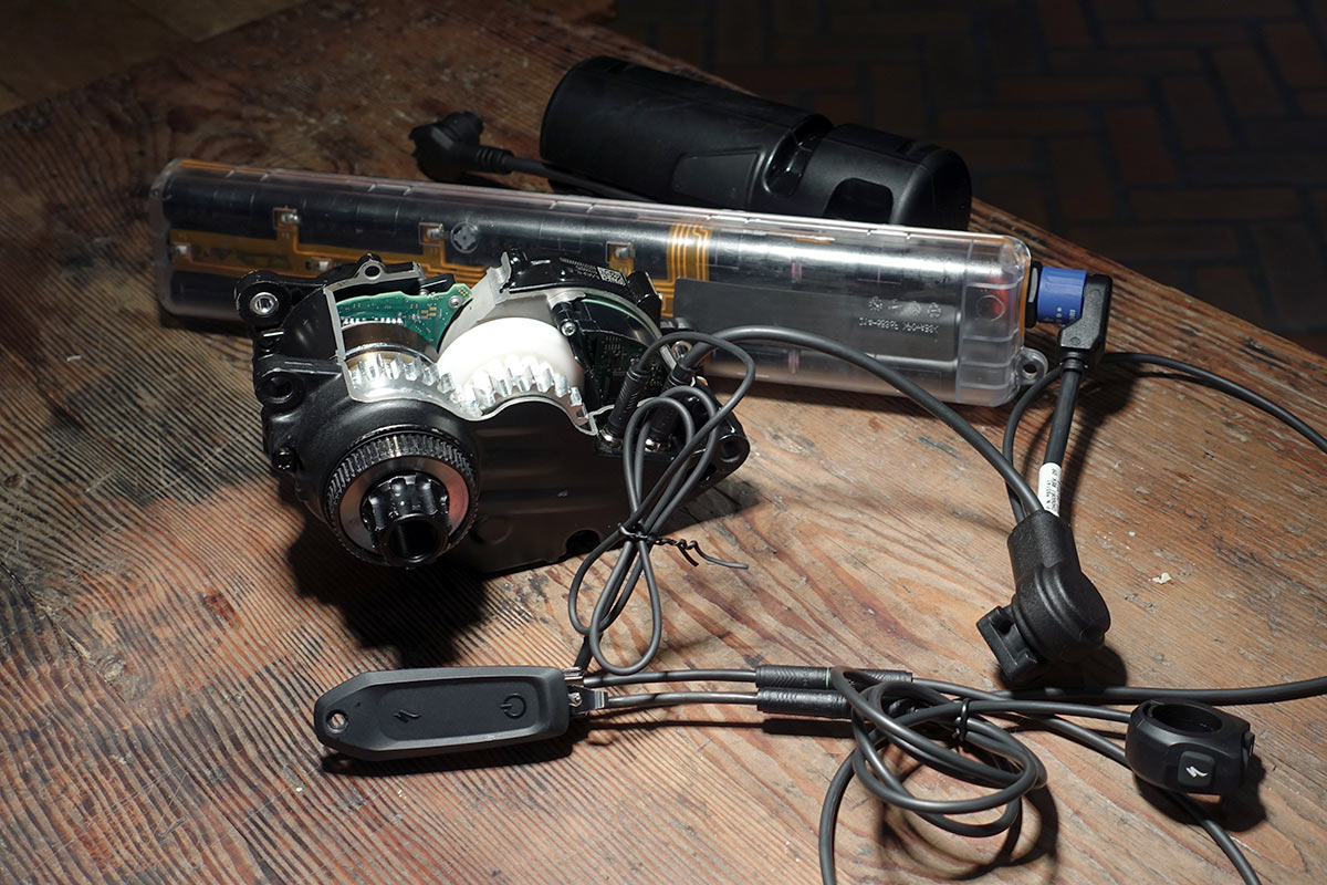

there probably isn’t a super easy way to do this - but if you can figure out how the Vado SL EQ light is powered, you can do some hacking and use the same outputs to power a USB cable. you might need some step down hardware if the light is 12v. here’s how someone did it on a Levo (NOT an SL)
I don’t see the matching ports on the SL motor.

@YoGe if you really want to do this … this is the specialized part you need
it goes between the motor and the TCU. it has a live 12v output, which is limited to .65a, or approx 8w. from there you’ll need a hardwired usb charger (common on motorcycles) for your device, which shouldn’t be too hard to find.
