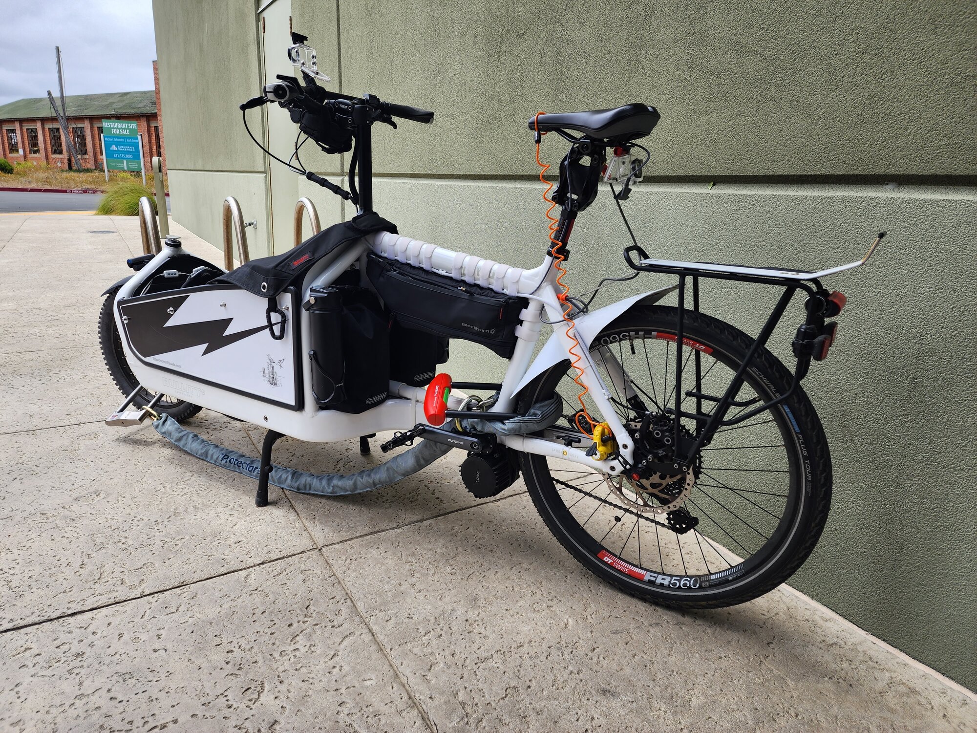

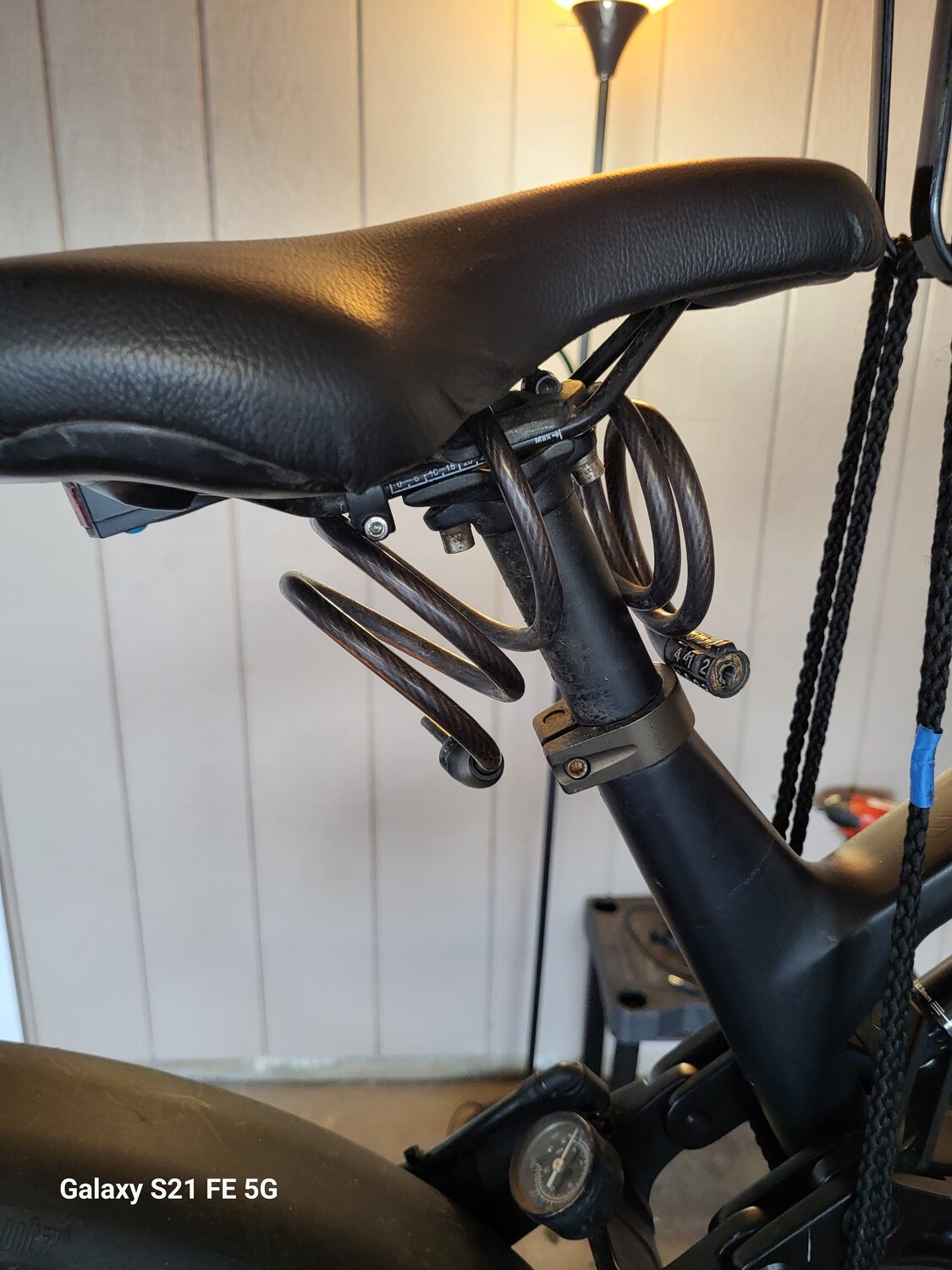

I'm running slinky combination cable lock to prevent the bike from falling when I tether my bike to a pole when no bike stands are available and Caliper lock with alarm. Cheap locks. My bikes are not cheap. I got GPS also but I leave that to my nephew to trace it if they get taken.

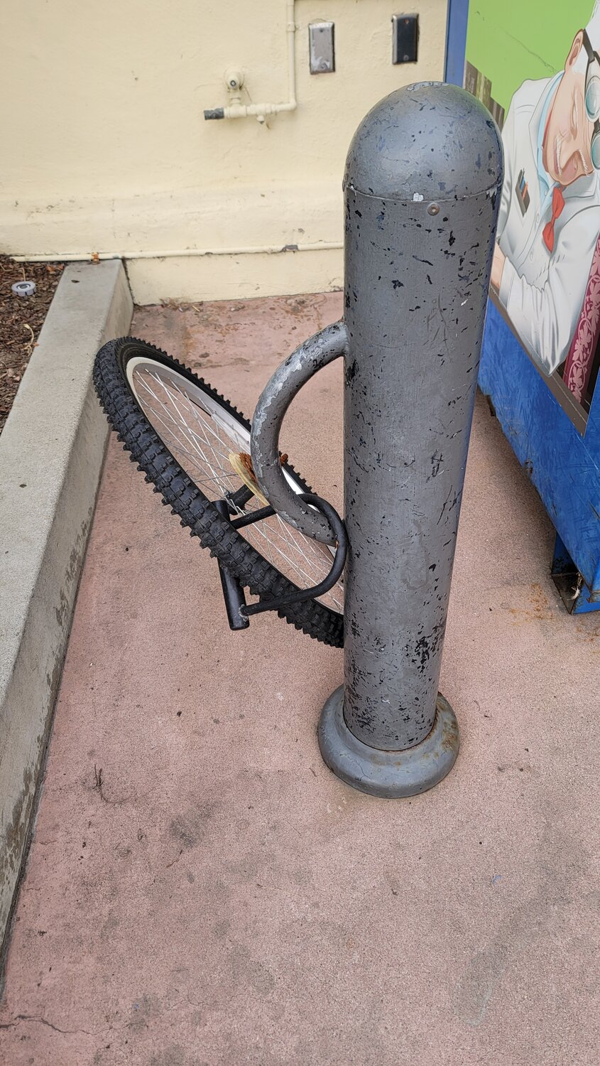

My tire was stabbed twice while my bike was locked up. Shows what thieves in my town think about this lock system. I carry a tire tube & pump in the bag.

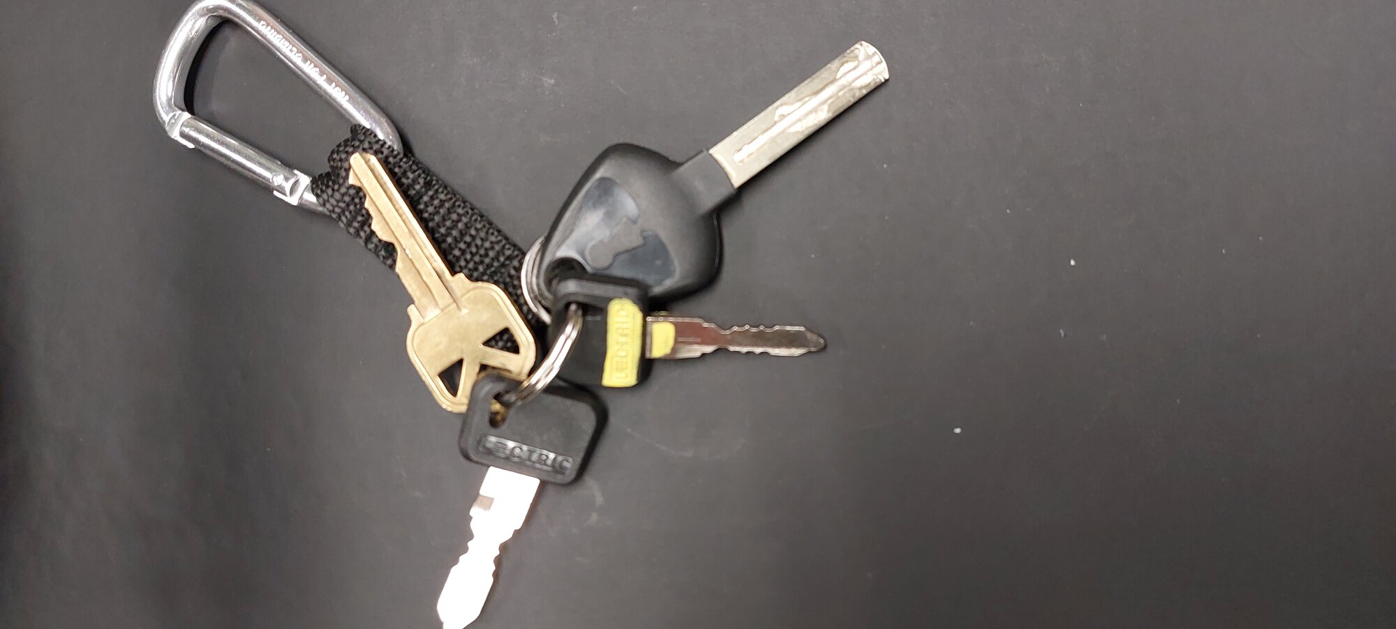

Now I am having second thoughts. These are both keys locks (not combination). The keys are not the same for both locks and they are almost identical except for the key number which is very difficult to read. I went to the Kryptonite website to see if I could get locks with the same key. They have no contact information except for a form that asks for a ton of personal information. I'll see what the response is, but right now I am inclined to return both locks and look for something with better customer support.
I just received the two Kryptonite locks I purchased on Amazon:
Kryptonite U-Lock
Kryptonite Keeper chain lock
Key locks are a lot more secure than combination locks.
Put a tie wrap on one lock and it’s key to identify them.
DG…
Or a dab from a paint pen, on the key top and on the lock. That's how I tell my ebike battery keys apart. Those are nice locks, I'd trust them.
