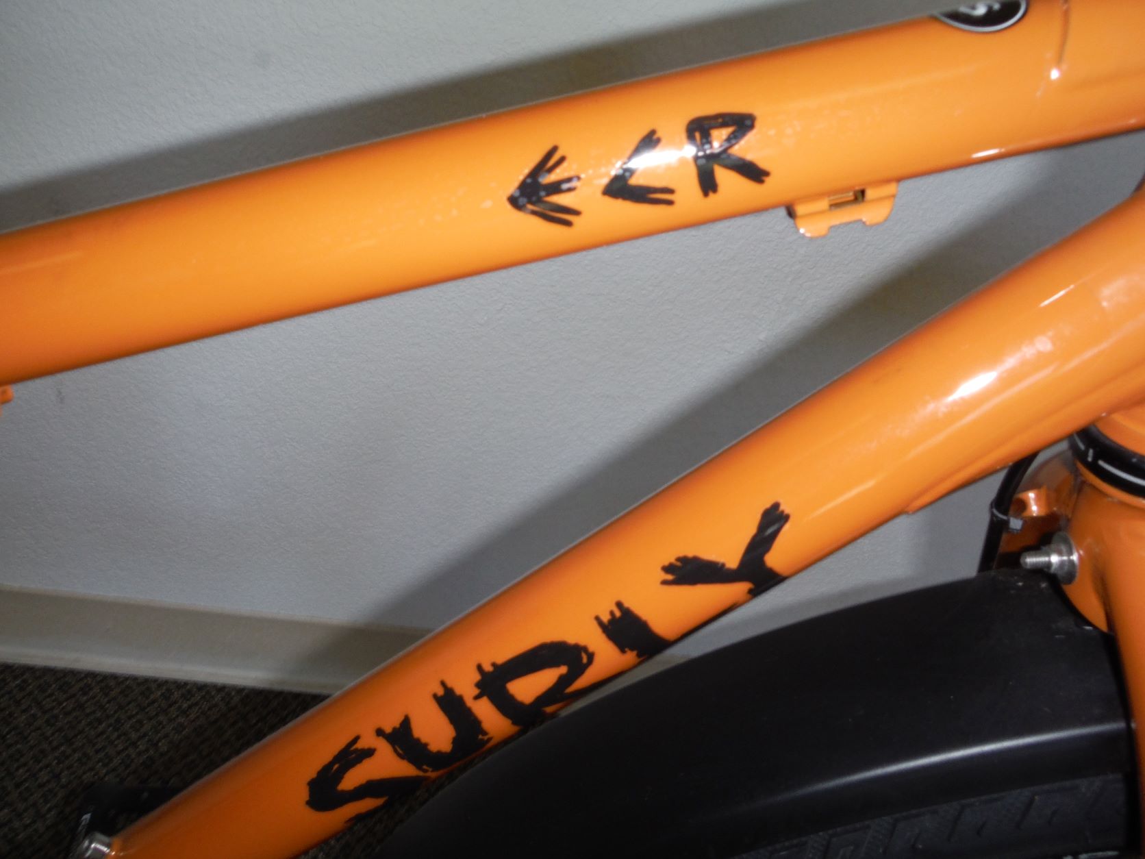

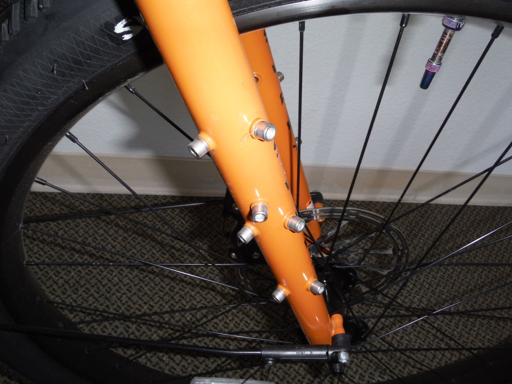

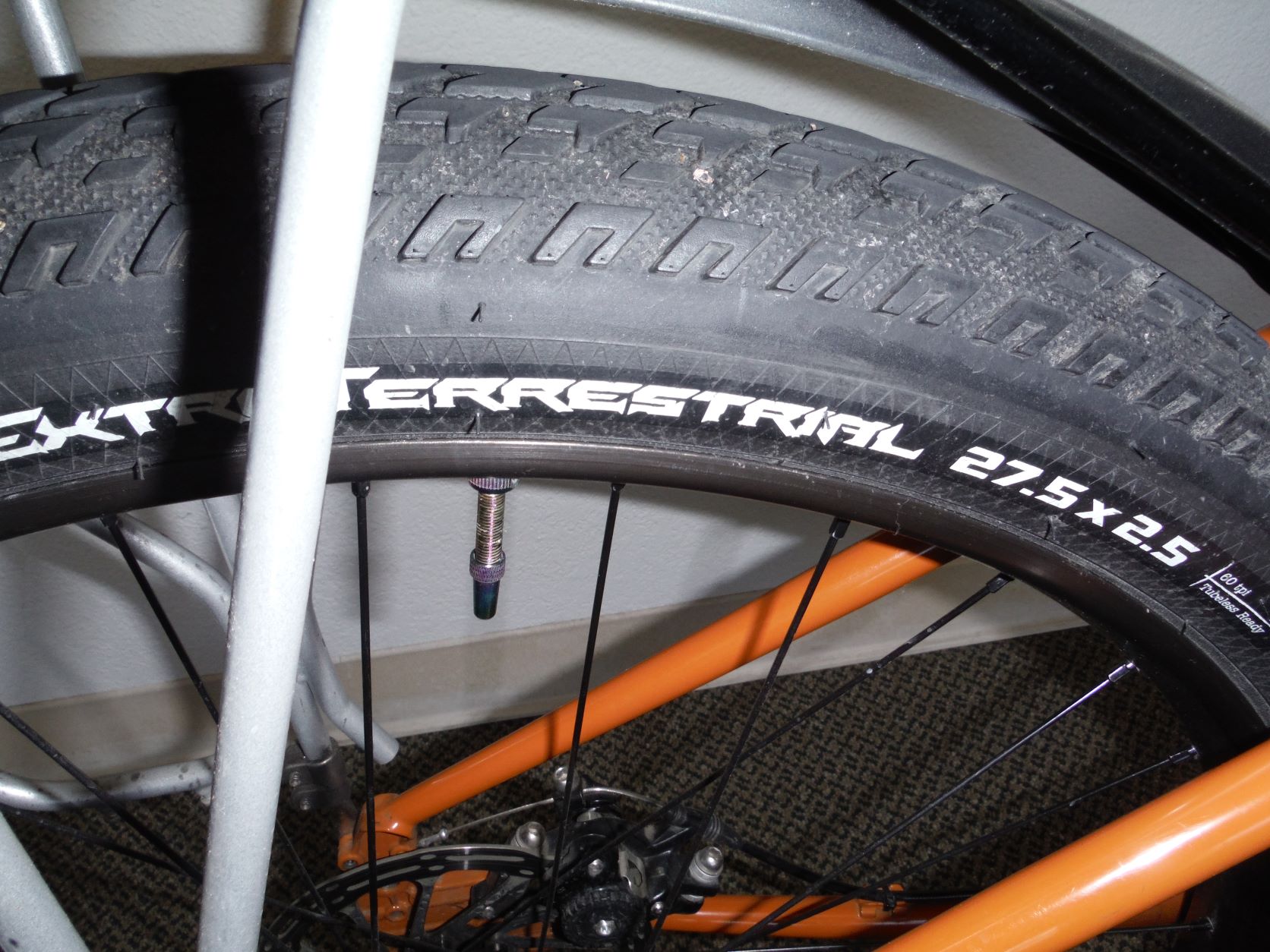

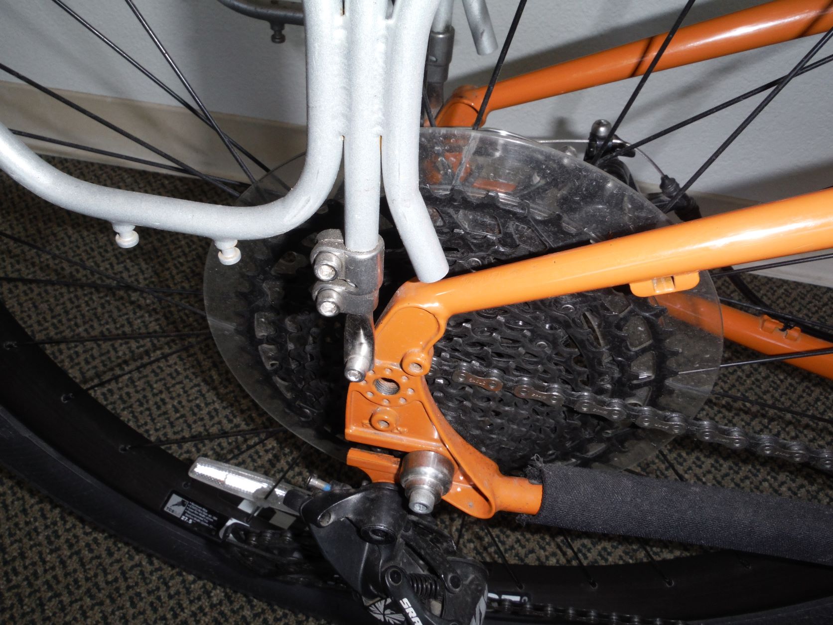

That is a bummer. Would have been cool if that was it. By the way, It takes effort to make a joke! At least I tried with the pickup line joke. @Edrummer, here is that bike in its current state. Thanks for asking. I only just started. REI had way overtightened thin zip ties to hold the shift housing crimping it in six places. I am doing that first with new housing and a premium tandem shift cable. I will use a small mid-drive like that other Red Gravel bike, a medium sized battery and a small one both at 36V with high-end cells and BMS. I will unlock the motor to hit peeks of 700W but with a low nominal rate of bleed-out at 350. And I will chop off all connectors and solder for a cleaner build.
