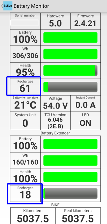

  • However, it is good to use the RE first if you set off for short rides often. Each of the batteries gets slowly degraded with the growing number of charging cycles. You might notice the main battery gets more charging cycles if you ride the e-bike on the main battery only often. To equalize the number of charges for both batteries, you might choose "Discharge the RE first" until the use of both batteries becomes equal.

Whenever I go for a long ride, I use the main battery + RE in parallel. However, my daily short rides are done on Range Extenders until the number of recharges on any of them becomes equal. My goal is to save the main battery, especially as Range Extenders are less expensive.
