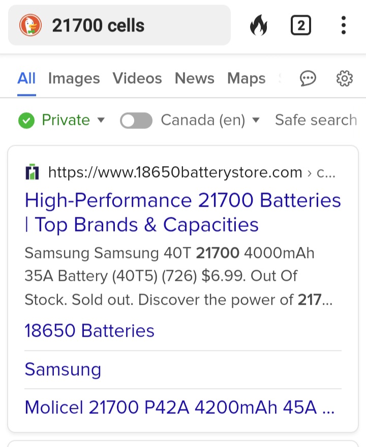

What about an upgrade to lithium cells?
The new 21700 cells have come way down in price.
Just make sure that you buy original Samsung, LG, or Panasonic cells, with an appropriate BMS and charger, and you're good to go, without any safety issues.

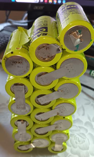

When I dismantled my NiCd battery pack, I removed one battery from the assembly to gauge the adhesive strength (picture below).
Whatever the glue used was, it was hard to prise one 32600 free ... do you know whether the product you've suggested has that strength of adhesion?

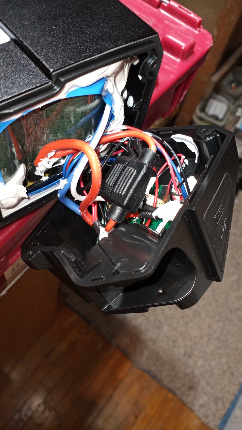

I opened up my battery then used some of that glue to close it up again.
I found a little circuit board inside that could bounce around and I wanted to stabilize it.
My battery cells are wrapped in what they call "fish paper" and I don't know what it looks like under the fishpaper.

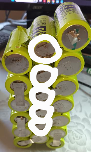

You can also get circular stickers with a hole that go on the positive terminal of each cell to help prevent a short circuit across from the positive terminal to the cell casing a mm away or from the nickel strip that could touch or wear through to the negative case of the cell.

The main things about the glue is that you don't want it to melt if it gets hot, and you don't want it to give off any gasses that can damage sensitive electronics.
Regular Silicone 1 gives off acetic acid during the cure and that's not good for sensitive electronics
Silicone 2 doesn't stink when it cures, and as far as I know, it should be fine for your battery?
I was messing around with a lithium battery so I wanted to use the proper stuff.
The original white silicone inside the battery was pretty good strength of adhesion but I could still careful pull the wires from it.
Regular silicone is a bit stronger, and I probably would have broken the wires?
The stickers go here, under the nickel strips.

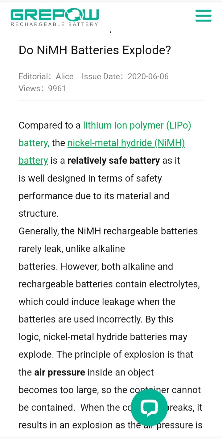

NiMH batteries are much safer than lithium.

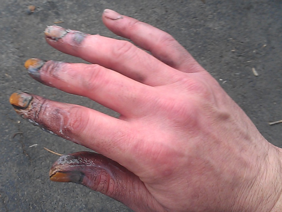

This is the hand of a guy who messed with a lithium battery,..
Do your homework and follow the protocol and keep safety in mind.
