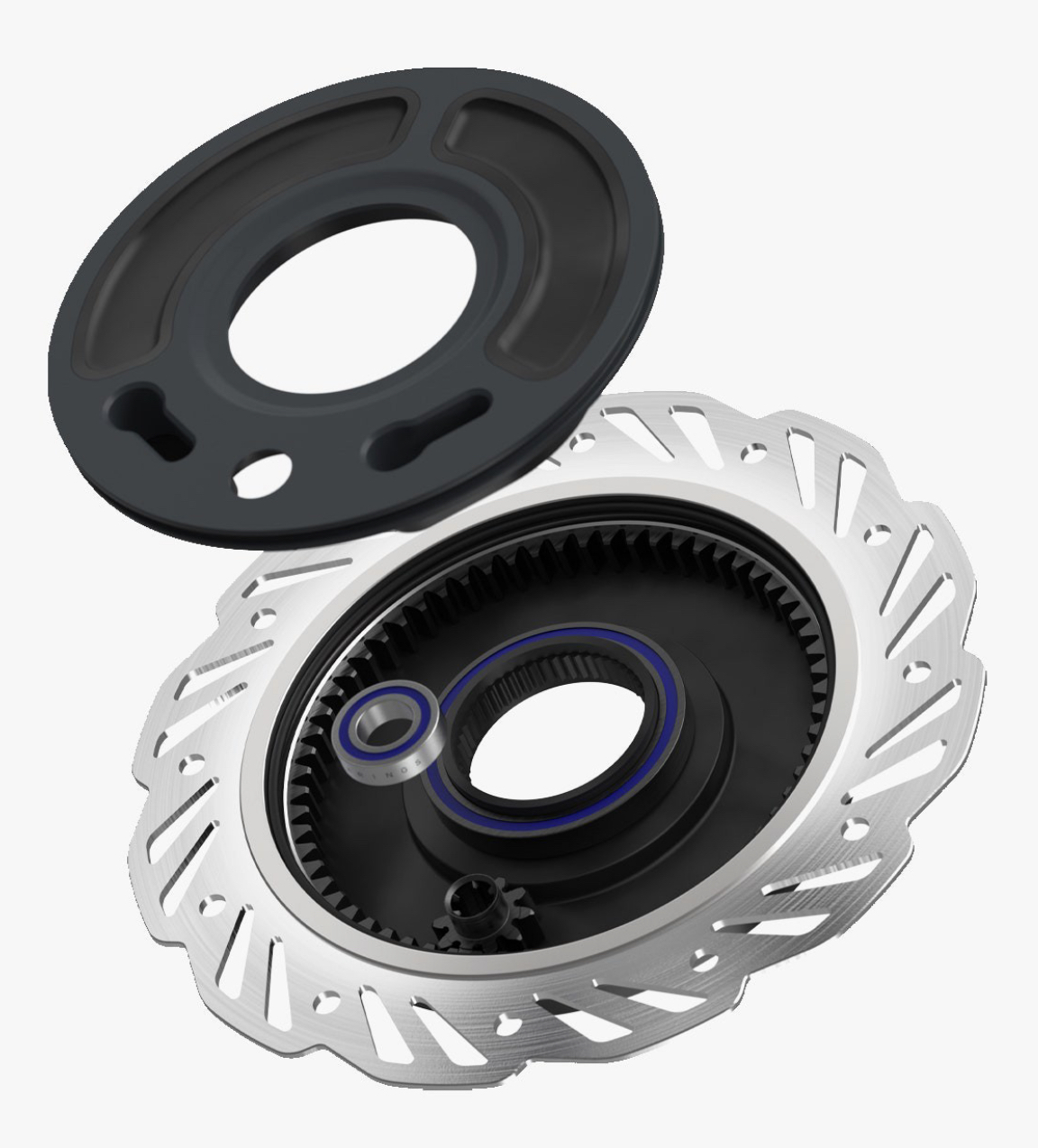

this actually seems like a pretty ingenious solution - and at only 6.6lb the average person could easily toss it into their bag before and after use.
motor driven replacement rotor:
Definitely an interesting product but quite pricey. I can see where it would serve a niche market though.
The internal battery can't be very large judging by the size and 6.6# weight of the unit itself. It therefore can't offer much assist in order to achieve the advertised 37 mile range. Another question is, can the battery be swapped with a spare to increase range? Is it easily replaceable or do you have to buy another unit when the battery fails?
Another issue is, it appears you have to stop and push a button on the unit to change between eco and max modes.
This might indeed be an attractive conversion choice for commuters who already own a decent bike.

some interesting advantages of this - like a mid drive, you’re not spinning the motor around. less rotational mass, less wasted energy. like a rear hub drive, the motor torque isn’t being reduced by the drivetrain ratio, presumably allowing less extreme internal gearing. fully removable, so no weight penalty other than the slightly heavier rotor and a few sensors here and there. it’s upgradable without upgrading the whole bike, which given how quickly e bike technology is changing relative to bike technology, pretty nice.
disadvantages… kind of ugly. structural load on a part of the chain stay that may not have been designed for it. (i wonder if it works with carbon bikes?) cadence sensor only, which isn’t great. it would be cool if someone made bikes with all the sensors fully integrated, and this just attached and communicated wirelessly with the pre-wired sensors.
It is a Rubbee on the disc. I am not sure; is it better to be the rubbee or the rubbor? Or to take turns? The photos show it on a carbon bike. No way, Jose. A carbon road bike is not made for that. What if you crack your chain stay at speed while cornering? Carbon is fragile and brittle. It cannot take compressive forces such as from securing the motor mount.
