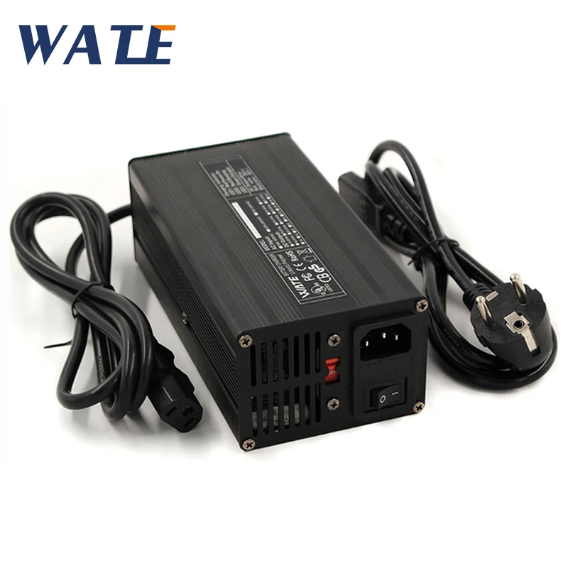

Q is - did you get your St2s from a junkyard ??
Or you want to blow up both your battery and your coworkers offices using a cheap 50$ charger ?
And then is the noise pollution from the fan.
The cheap Charger fan in case you were wondering...

Finding a charger for the specific voltage for lithium ion is easy, because you can just go on AliExpress and find a 54.6V (and whatever the amperage you need / want) for your battery.
54.6V 4A charger
54.6V 6A charger

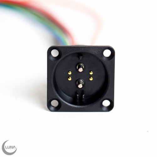

Most ebikes have DC (5.5 x2.1) connector, XLR connector, etc.
Stromer has Rosenberger connector, which is a rare kind, but you can still find a charger for it because Specialized, A2B, etc. used Rosenberger.
Here's a funny part, according to Grin Technologies, their Rosenberger adapter won't work on Stromer.
Did Stromer go extra mile to make sure normal Rosenberger connector won't work?
If that's the case, Stromer owners are really screwed because they're pretty much stuck with the factory charger, and the price they're charging is outrageous.
Grin Technologies XLK to Rosenberger connector.
Luna Cycle has Rosenburger connector, however they don't mention anything about compatibility with Stromer.
Luna has quite a few chargers, so they might be able to build a charger that's compatible with Rosenberger connector?
Their chargers look very similar to AliExpress, probably come from same factory.
And ask them if they had any experience with Stromer?
Or do they have a third or more connections for a com system between charger and battery? betcha!
Anyone aware of a reasonably priced charger that will work with a Stromer?
There will be none, except you find a 2nd hand charger in the internet.
1kWh in a battery is a lot of energy - and a 1kWh battery is really expensive. Two very good reason to make the charging process safe (against incidents and against battery-degrading). Stromer uses an open-source bus protocol for the communication between charger and battery.
