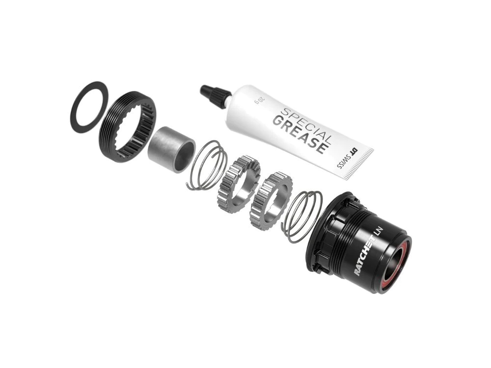

Sometime last year when I did not shift to the smallest cog when I was taking the wheel off the tandem it pupped the cast body off the wheel. This is a dt-swiss hub and it comes apart by hand. I did not realize how easy it is to do. Well I got the rackets picture below dirty so I wiped them off checked online to look how it is assembled and used some grease to put it back together. I don't know if it had issues after the or it only happened after the bike sat 4 months while my wife's shoulder replacement healed. Well we got back to riding and we would have this strange skipping issue. Like sometimes the chain would let loose a tiny bit. I thought it was because we were out of sync from so long a time not riding. We sort of felt with it sometimes it was worse than others. But In the last two weeks I found it would not do it when we were peddle lightly or hard but in-between. I took the wheel in to the guy who built it as it had some truing needed and he found the rim had cracked in a few places and was under warranty.
He could not fund anything it felt smooth. Well when I got it back I popped it apart to check it out then checked the pdf on it and I found the problem was I sued regular grease and you need to use the special grease they sell.
I talked to a mechanic at this high end shop thats close to my shop and he told me the problem is the ratchets stick together with the wrong grease then any little slop in peddling will pop them apart. He said use some oil on them and test it. I had some Chris king lube and tested it much better not perfect but better. So just to make sure and that the grease is 18.00 I spent 50.00 for new ratchets and the grease and new springs.
Cleaned it up and put them in. The grease is really thick but dry a bit of strange I had not seen before.
