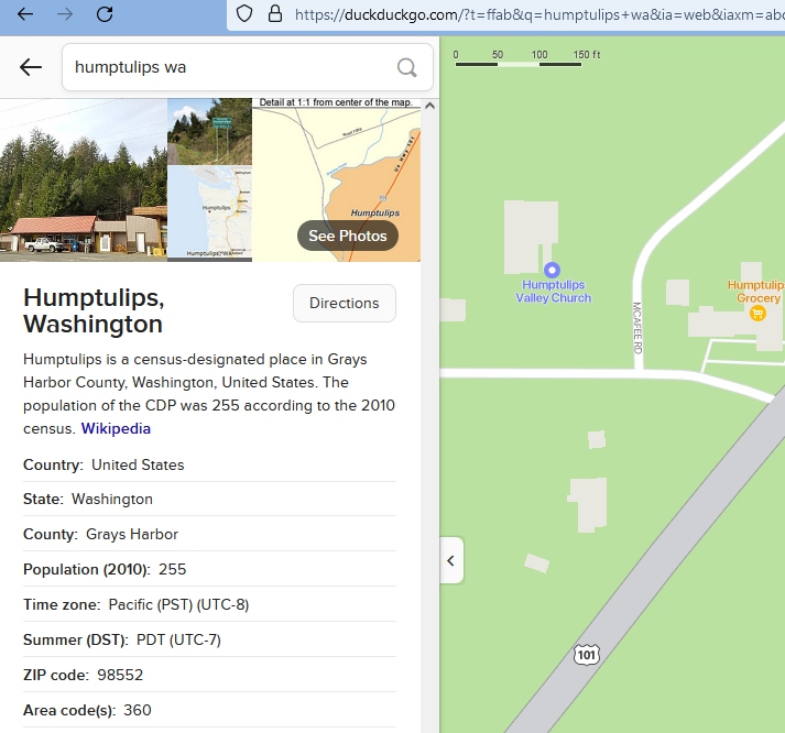

@Stefan Mikes . Take us to Hump Tulip next time you riding improving Strava stats. On your Brose TF Specialized Vado.
You asked and you shall receive:
