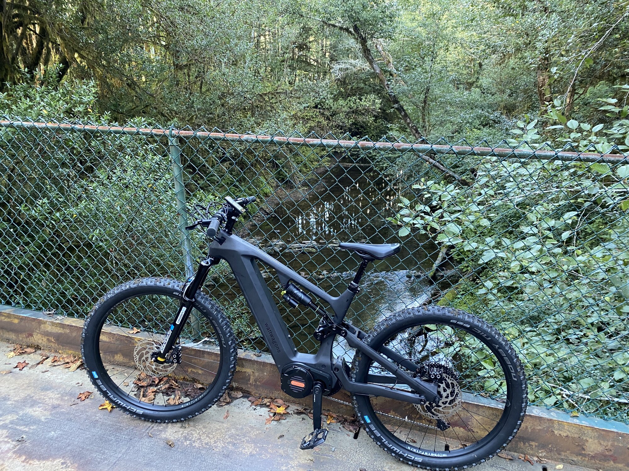

Nice, kind of stealthy. I think that is almost exactly what mine will look like.
Do you know the number of the paint color on it?

Color is matte black. Yeah, I love the stealth look. I really had a blast on it today. I need to dive in to the x1 programming as my throttle is too jumpy and I was having issue starting from a stop on a hill.

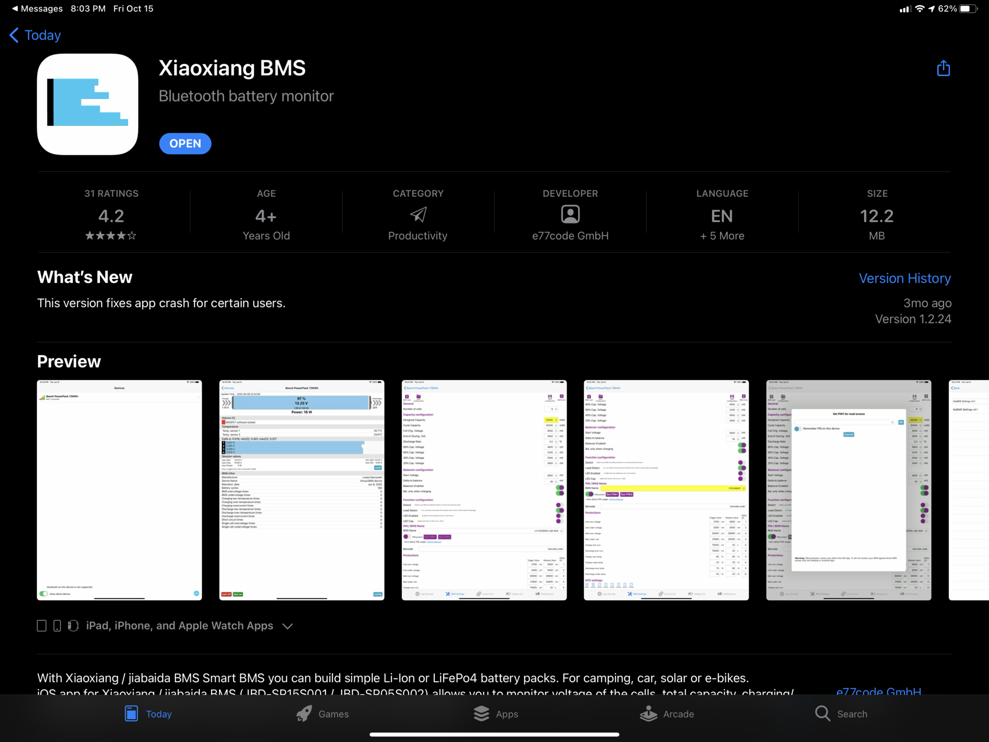

Your BMS is Bluetooth capable. Download this app check all stats including state of charge etc. This is another wonderful extract that Pushkar just throws in free of charge.

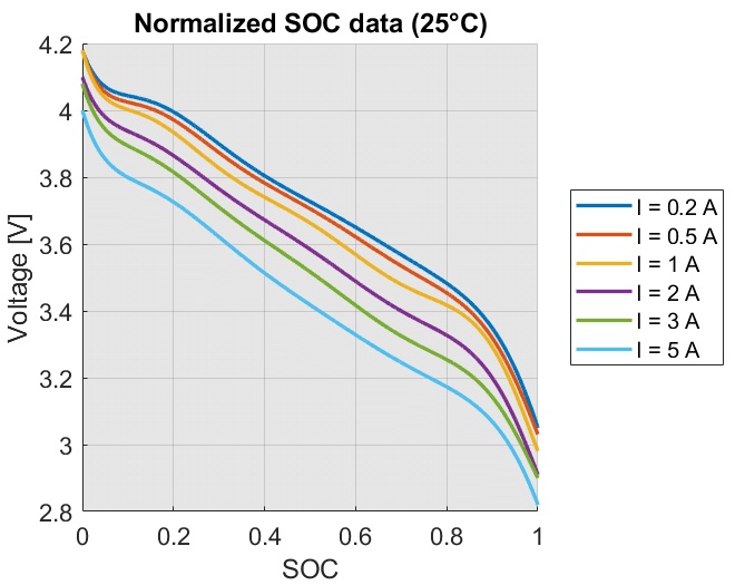

My batter says 100% but it drops to 75-85% in less than 5 minutes of use. I’ll have to check this out.
if you want to go fast you’re going to use a lot of battery. I purposely ride in echo one and two and I can get 30 miles of trail riding. Eco 2 is really pretty darn fast. Compared to a Turbo echo 2 on the hydra is more powerful than boost on the Levo. if I want to go fast sometimes I’m only getting 12 miles.
Yet my wife's ebike doesn't seem to suffer from this effect.
It would be less apparent with higher current cells or more cells in parallel. What is your wife riding?
I didn't see anything in the Hydra BMS settings that would pertain to this.
