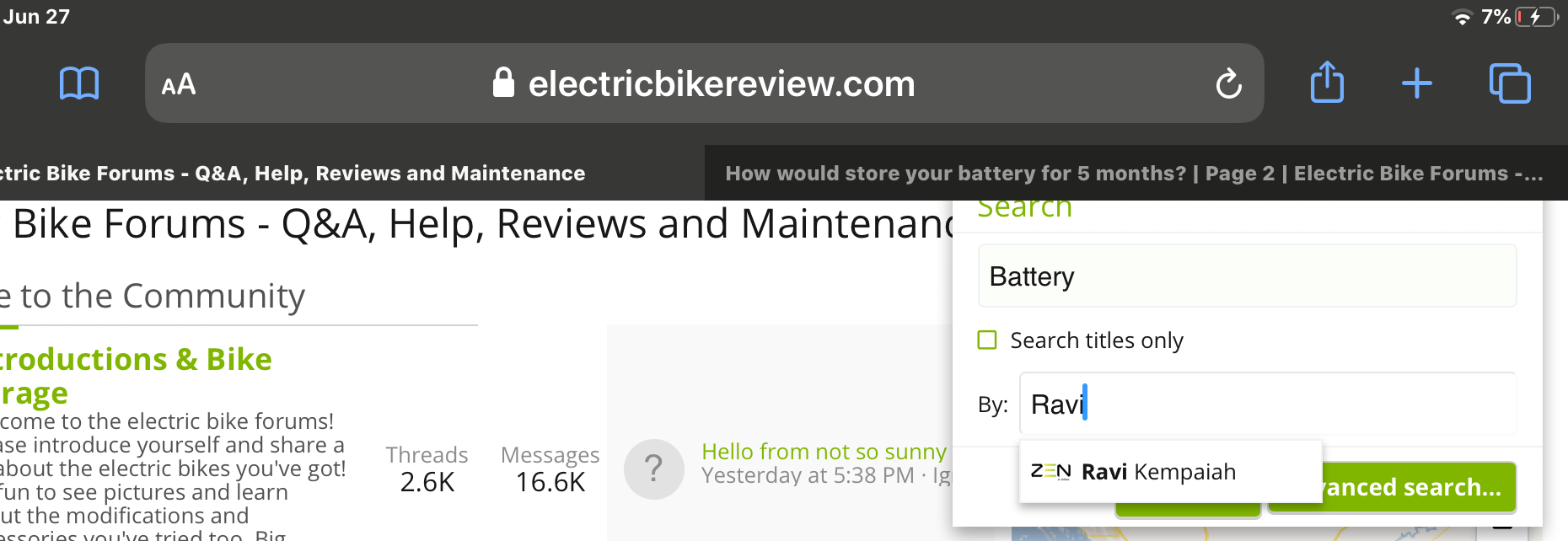

I know it’s hard, let me help,
Ravi’s battery
Forum search 101.
