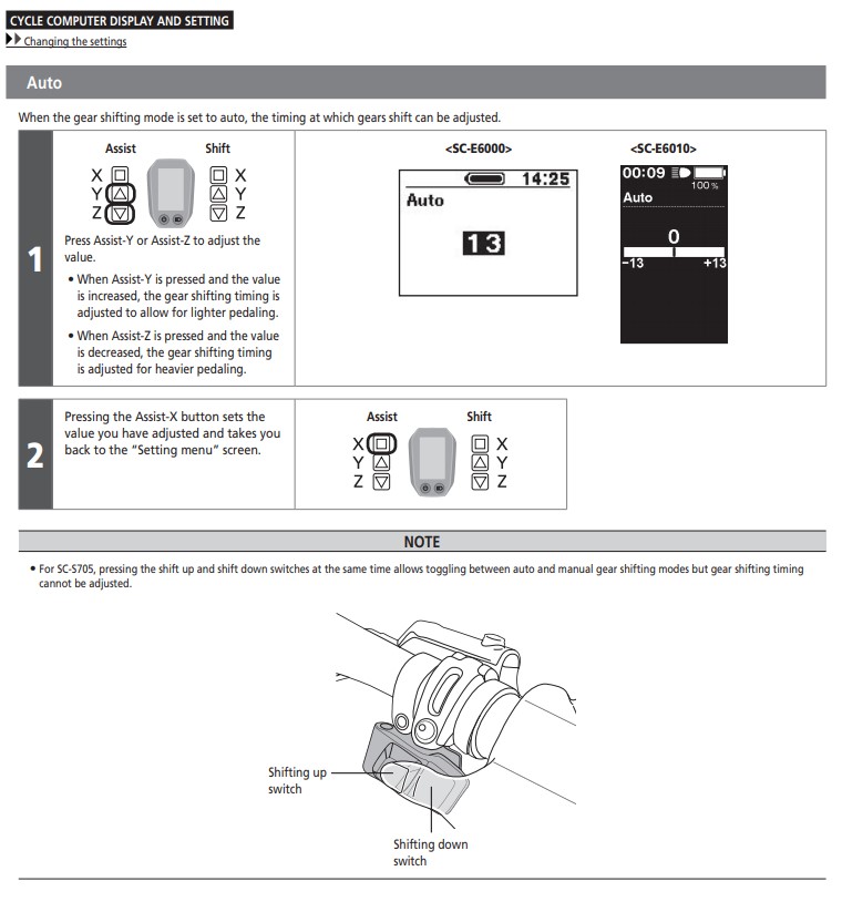

I played with the Auto settings in the menu on the handlebar head unit (1st attachment - E6000 user manual) and this makes barely any difference at all.

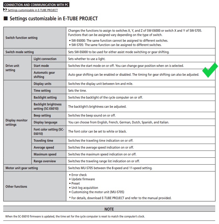

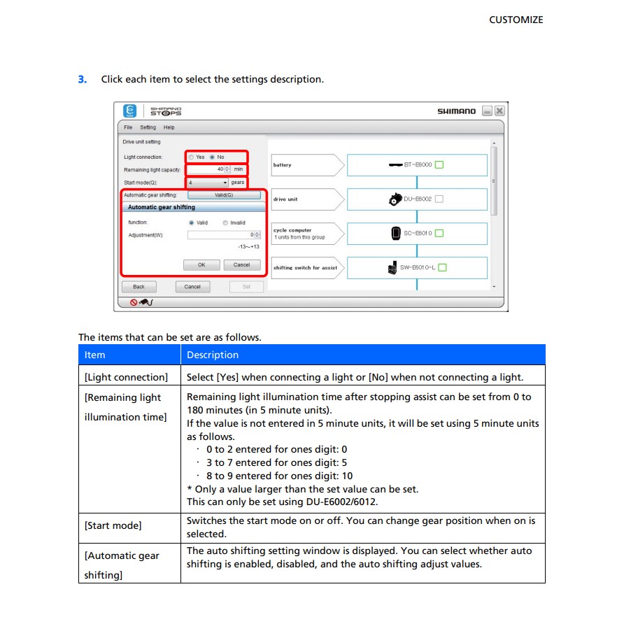

I spoke to Shimano Tech, and was told there is a Auto setting available in e-Tube (2nd attachment - E6000 shop manual). However, upon further examination of the e-Tube Project documentation (3rd attachment), it looks as though this adjustment is the same -13 to 13 range that's available to me on the motor's handlebar head unit.

I bought a second-hand Shimano SM-PCE02 interface to connect my PC to the E6000 motor, hoping to find an additional auto shift setting. It doesn't seem to exist.
As I poke through the various pages of settings, I've found only the same -13 to +13 "Auto" shift adjust setting, which mirrors what I've already set the system at through the E6000's head unit.
However, the good news is the "status report" generated by the Shimano software reported my battery health at "99%" (this despite is being about 40% charged while I was plugged in).
The reported also indicated "Assist Level: Comfort." I don't know what this setting corresponds to or what other choices there are, since there is no menu setting. Maybe there's a Shimano-settable "Performance" mode? If so, would this affect auto shifting? I'll have to get on the phone with Shimano and ask.
Also of note is that all of the Shimano-settable options such as chainring and cog sizes, and wheel roll-out, are not visible to me, other than in the status report. There are no grayed-out drop-downs or locked menus that would give the indication that these values are settable.

View attachment 45051View attachment 45052View attachment 45053
