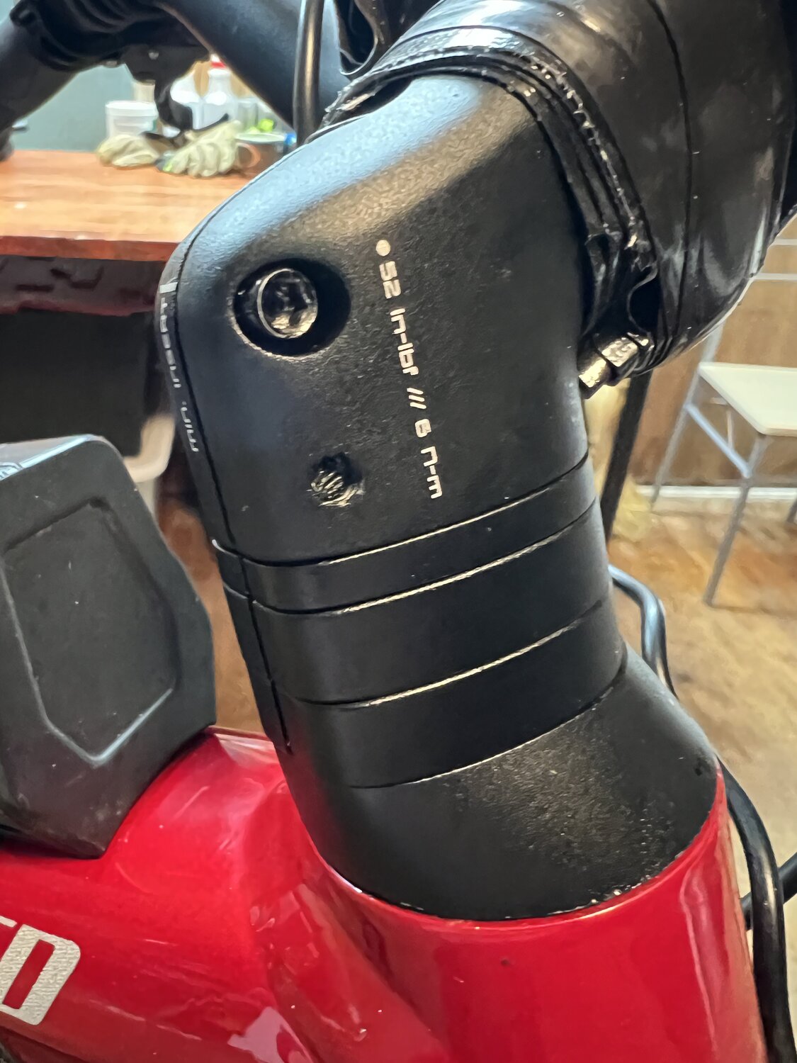

Any you know about Specialized e-bikes, stem SPACERS? I think they exist, although not positive, and I can’t figure out how to buy them. I don’t have a local bike shop, so gotta do this on my own. I need to increase the stem length and raise my handlebar. Thank you very much for your help.

I would think you would need a stem riser. The spacers won't get you any higher unless you have some extra tube sticking up. Doesn't look like anything from Amazon will work for you. A new fork with a longer steerer tube from Specialized would work, if they exist. Or maybe they have a stem, or handlebars with more rise.
I have just replaced my stem i have a turbo Vado 4.0 SL. I would suggest if you add any more spacers it would be dangerous as the fork stem would not be long enough. The handlebar stem should sit just a 1mm above the top of fork stem.
