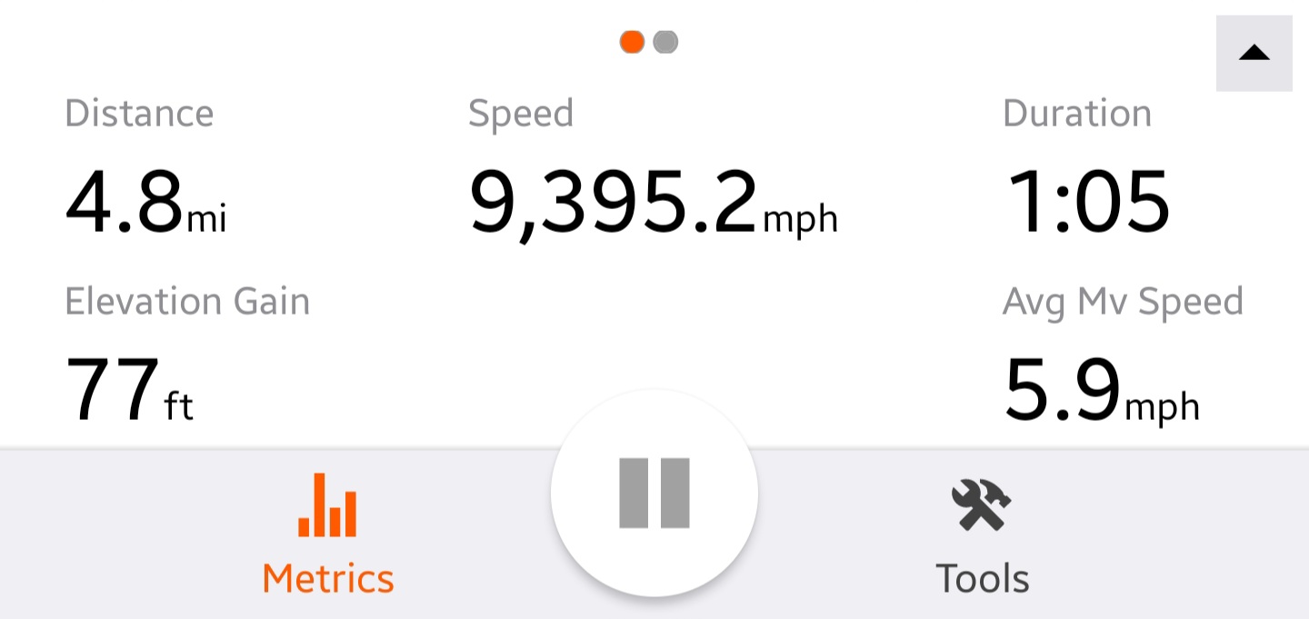

How best to deal with data stream interruptions (like loss of GPS signal in a tunnel) in a ride recording app? Some interesting coding challenges here.
RideWithGPS seems to do a pretty good job for me overall, but I have no comparison. The auto-pause is seamless and effective.
One recurring interruption the programmers could have gamed out better — me. I used to pause rides manually for longer stops. On occasion, I'd ride off without resuming manually, then catch the error and resume on the next stop. RideWithGPS would fill in the blank with some pretty interesting fictions.
On one such occasion, I got credit for hitting Mach 12 on a slow-going beach ride on soft sand. Not bad for a 500W hub-drive!
Now I let auto-pause handle most stops.
Manual pausing the ride recording is always a bad idea (unless one has an elephant memory!) Wahoo at least emits a warning beep while in manually paused mode when significant motion is detected.
