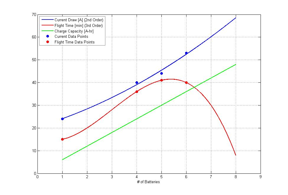

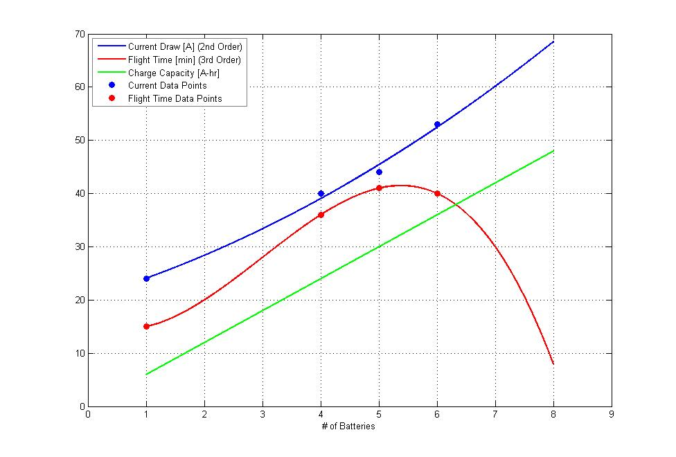

Interesting looking at charts of flight time and distance for electric airplanes. The upside of more battery power flattens as battery capacity increases then it goes negative. Hence the 2021 trend for bikes with lighter batteries. More fun riding lighter too and with better balance.
Ehhh, I'd say we've got a LONG way to go before batteries get so heavy they negatively impact range. Bicycles are incredibly efficient machines so adding weight given how efficient the vehicle and support motor are doesn't aversely effect range in the same way as a RC airplane.
Bikes are efficient. Riding side by side with hills - without the other guy drafting - is a good way to test the theory. The heavy bike cannot maneuver as well. It is a Somu Vs. a Raptor contest. This is all analogous and anecdotal. So, try it yourself and see what you find. I find that the light-foot Raptor kicks the Somu's butt leaving its heavy guts on the tarmac. Let us know what you find after the first test.
Not to continue to derail this thread but you're comparing apples to ground beef.
Electric planes are highly inefficient and granted they're both battery powered but that's about it. Know how much range you can get descending and not pedaling? Lots.
You're seeing smaller/lighter e bikes because manufactures are finding that most folks don't use 100% assist all the time. The SL model was released because they found lots of folks don't use more than 50% assist. What's the point of having 4x you of assist if you're only using 50%, hence the lower powered motor and smaller battery.
