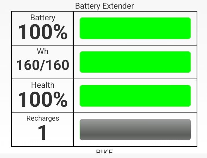

A newly added Specialized Range Extender (#4) after the initial charging:

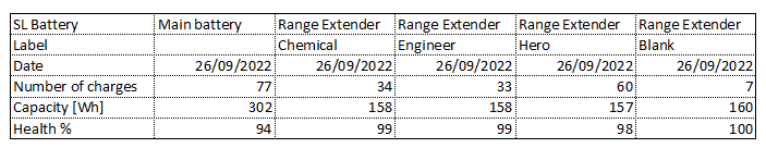

I have started documenting the status of my Specialized SL batteries...
Now, as I labelled the Range Extenders and can identify each of them, I would now use the "Blank" RE on a daily basis in the "Discharge the Range Extender first" mode. The other REs will only be used for my long weekend rides!
