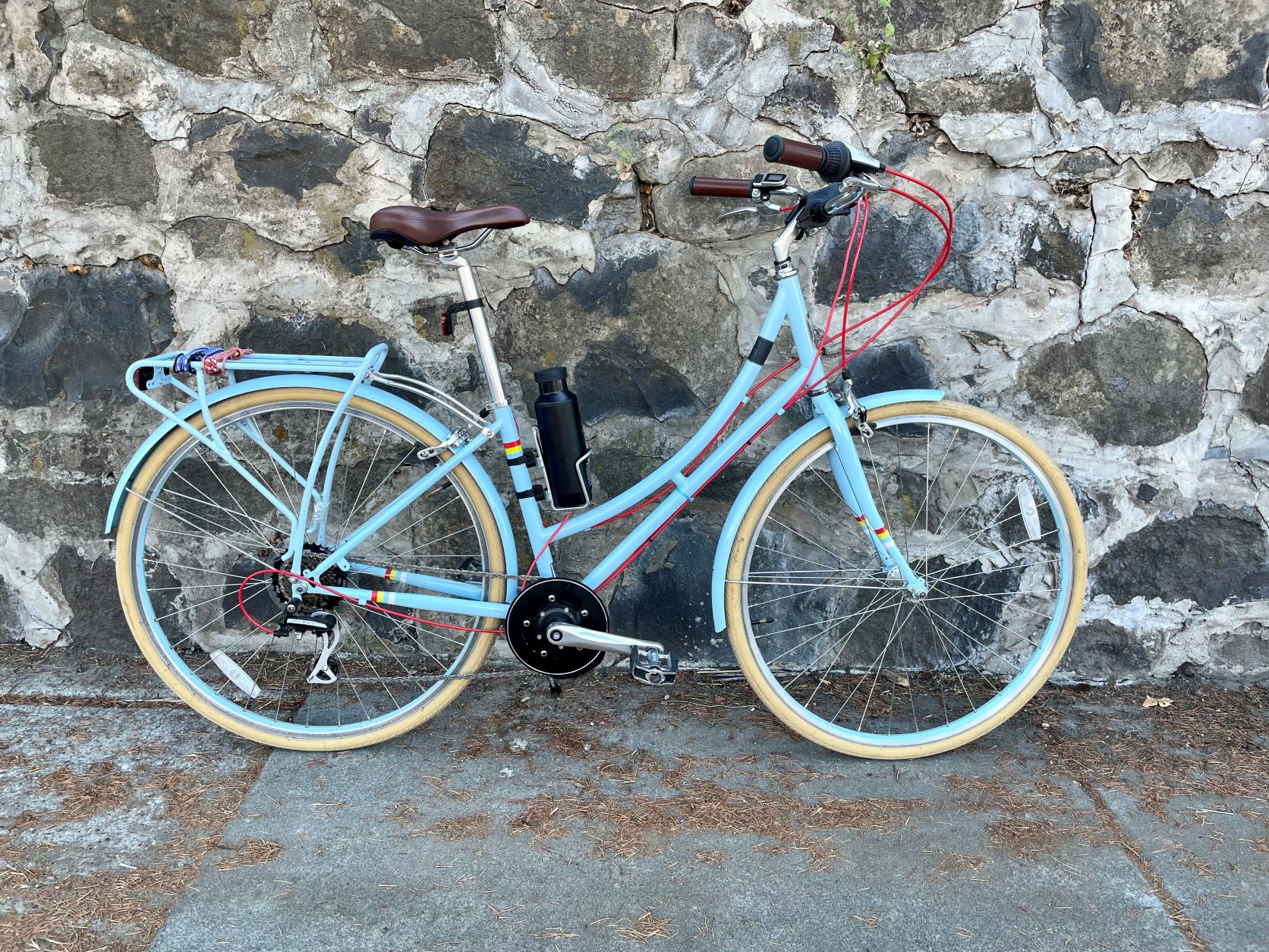

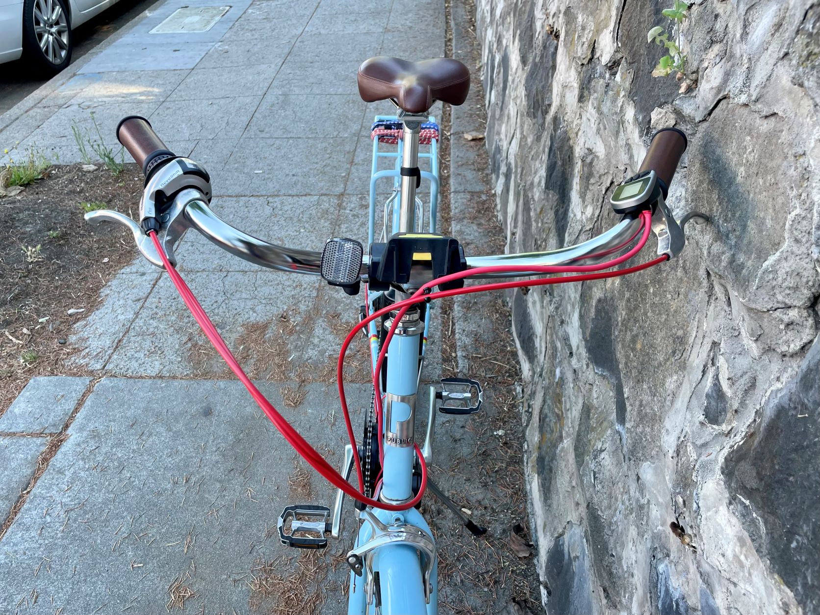

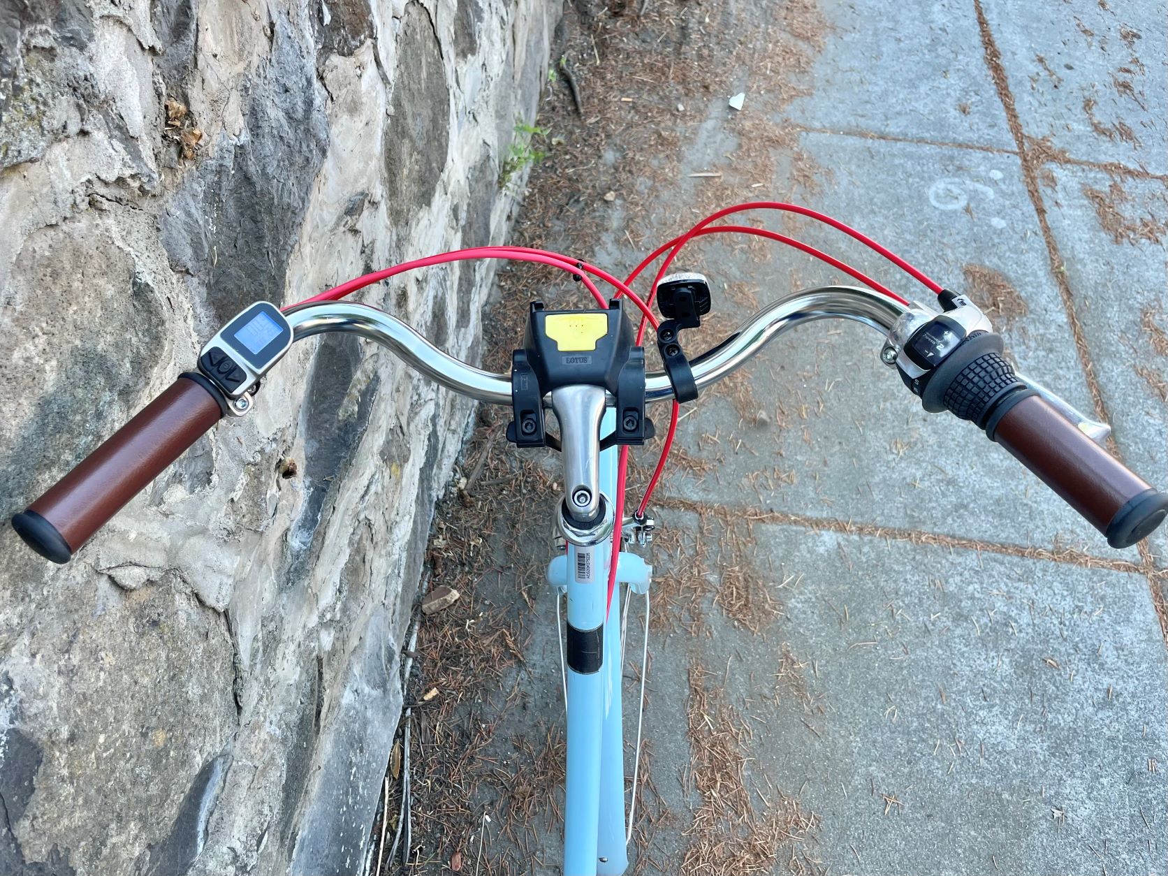

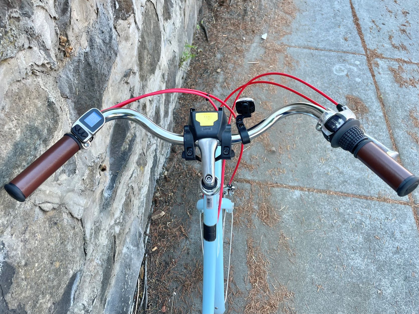

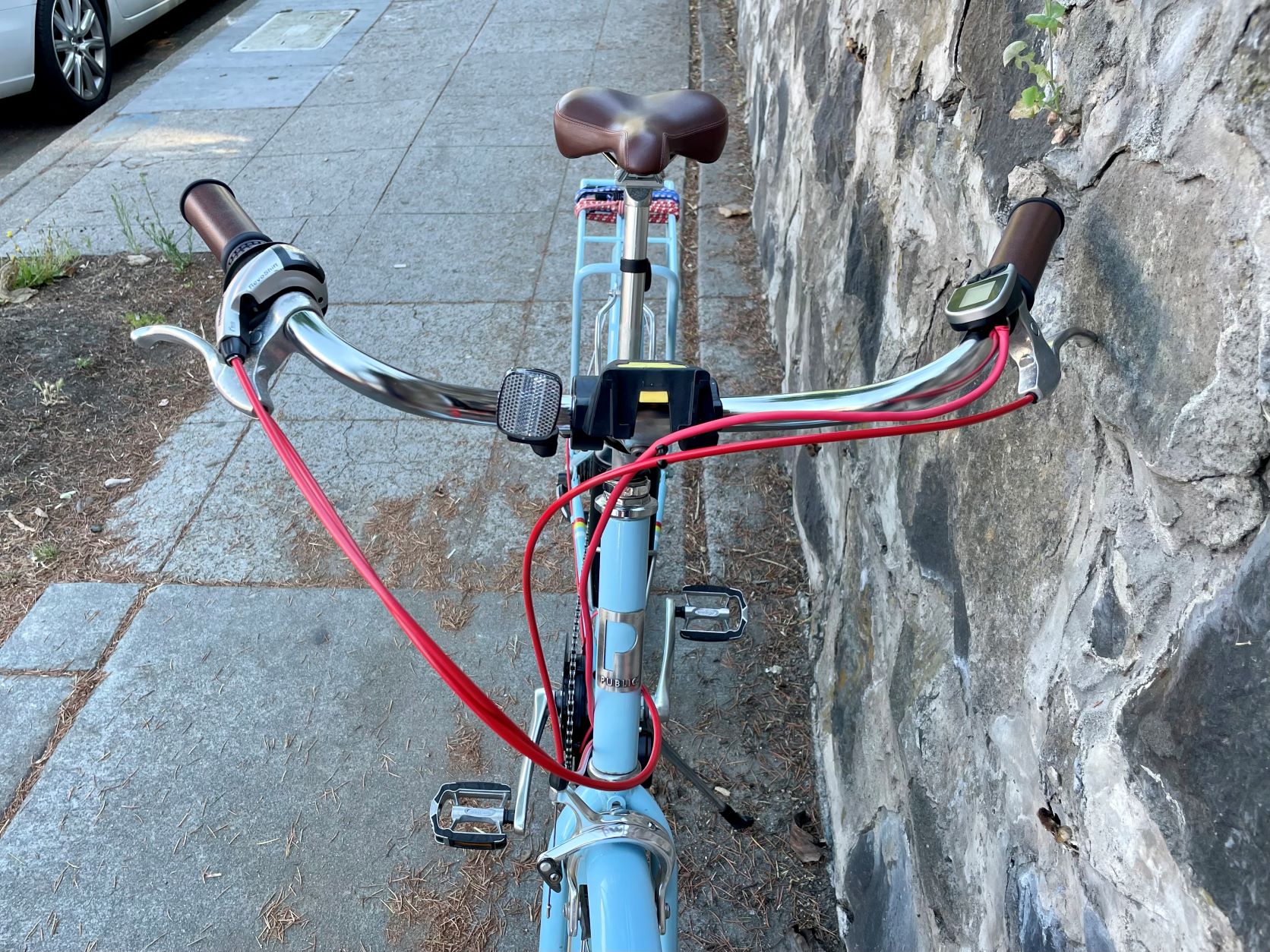

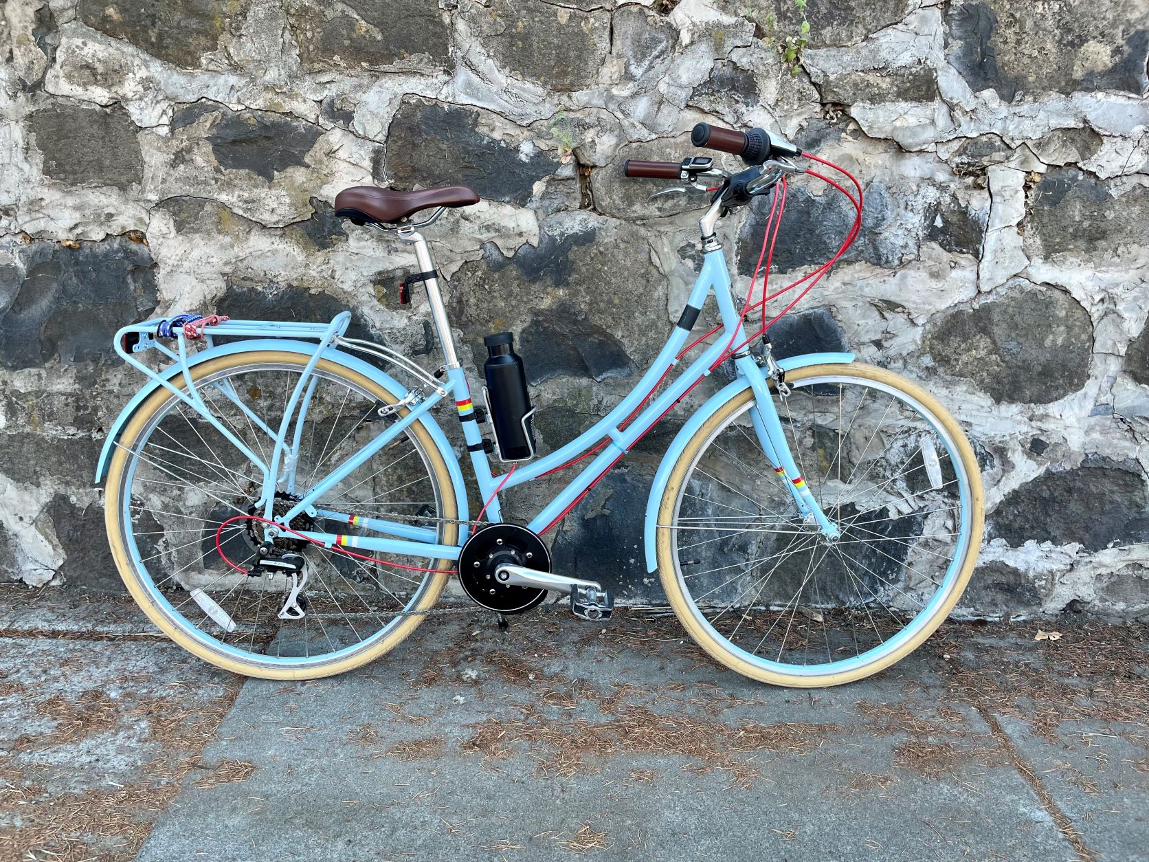

I know that this one is NOT your style. It is a town girly, girl bike for a girl. I made it today. It is the one I mentioned earlier with a torque sensor. I love these housings.
