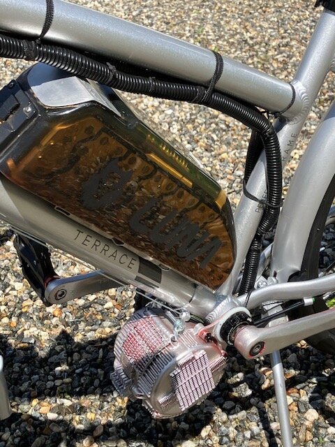

Yes its a 52V (nominal) beautiful Liquid Wolf 2019 LG 18650 MJ1 cells unknown #cycles 4,600 miles.

I can still ride, cooled by my fins under full throttle power all day every day after all these years charge it up and do it again no worries.
You know I never am concerned about any possibility of fire because of the fully potted epoxy construction.

You figure that would be more fire/explosion proof than say a 1/2"+ extruded aluminum case (offered by some of the less expensive production bikes)? If I've understood this thought correctly, I'd like to here the logic behind that call. We aren't talking the amount of electrical resistance here. We're talking containining a heat generated electrical explosion!
I remember Eric Hicks (owns Luna) saying they used wire bonds in the Luna Wolf? Those can act as fusible links, but that won't help if the cells develop dendrites and have an internal short circuit that overheats the cell. You can avoid dendrites by using automotive quality cells.
On the other hand, wouldn't encasing a cell in epoxy resin render the vents inoperative? The vents are supposed to leak electrolyte, and reduce pressure, before the insides get too hot. I once put a lithoium cell into a holder backwrads, causing it to short circuit with three other cells. By the time I could grab a tool to pry it out, it had gotten hot enough to vent and I had electrolyte dripping out of it,
Oh well, Grin also encased their Ligo's in epoxy. Gotta make for a heavy battery,.

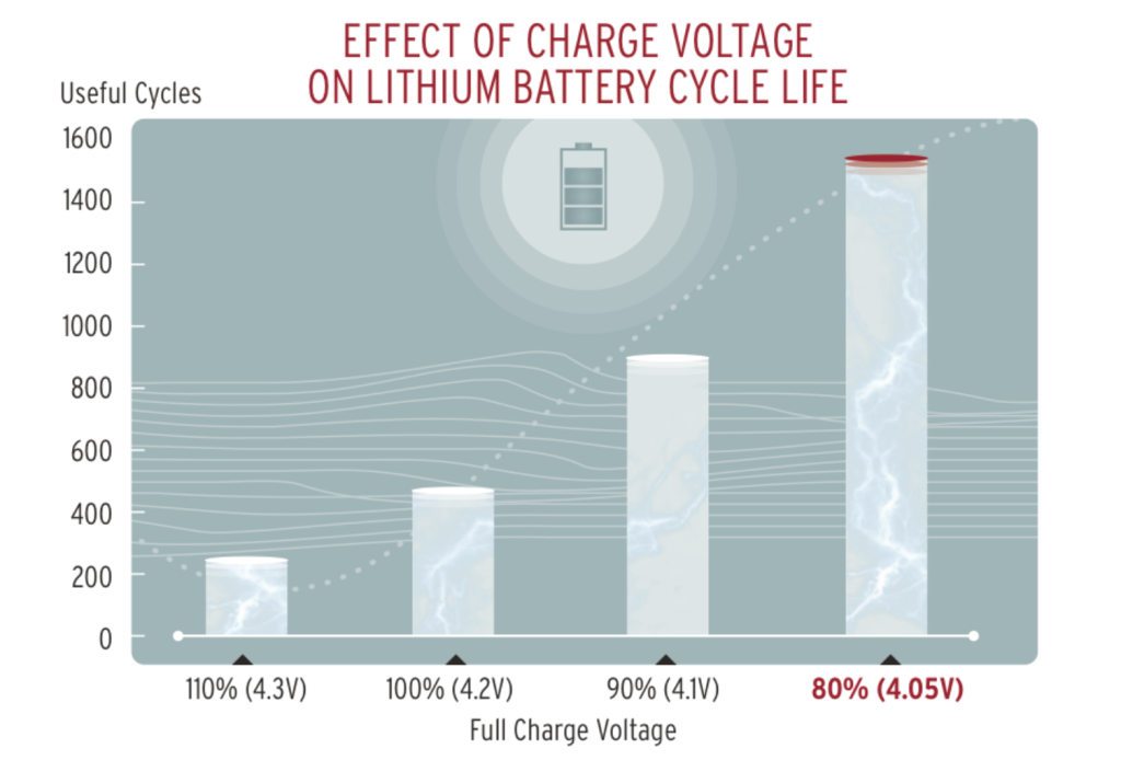

As for the OP's question about full voltage, sure you can do it. You could do it 400 times per the above chart, and your battery isn't dead, It will have lost 20% of its capacity, because that's where they stop the test. Now I could argue that you're no worse off than the guy who only charges to 80%, as he has the same capacity but I know that's not true,
When the Wolf packs were first introduced, the airwaves (particularly the Endless Sphere crowd) were filled with people talking with certainty about how they were all bombs waiting to go off.
Yes thats right.
Yes exactly, and none of the LIGO packs have blown up either. Its just one of those things that sounds dangerous but apparently there are mitigating factors the layman doesn't factor in. Both packs have been on the market long enough there's been plenty of time to see the predicted catastrophes.
And for sure the packs are heavy relative to what they could be. But its not so bad. I mean... if you are powering a BBSHD an extra pound or two is largely meaningless down low on the frame.
Now... I have seen one done sloppily where the potting did not fully enclose the cells, and that one had a mild burn/melt 'issue' (destroyed the battery but not the bike), but beyond that I haven't seen any fires over the years. Remember also they used that method on several different batteries for different fully-assembled bikes where they made special packs for the bikes. So they didn't just use this idea with the Wolf pack.
