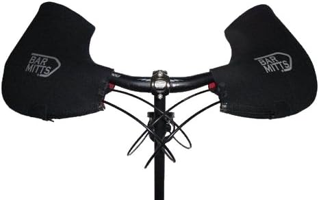

I used something similar like @Aushiker with Bar Mitt when I work commute during winter. It only gets in the low teens on average during winter in the southwest; but, feels much colder with windchill and headwind at +20 mph on an ebike. I've tried all types of heavy duty and bulky winter riding gloves and my finger tip were still numb when I get to work. Bar Mitts worked so well keeping my hands warm and I was able to use my lighter full finger padded fall riding gloves. They attach very easy with velcro in under a minute ($50, Amazon). I did have a few morning rides in the single digits and I used the warm in hot water gel heating pads to toss into the Bar Mitts on the 30-40 minute ride to work.
