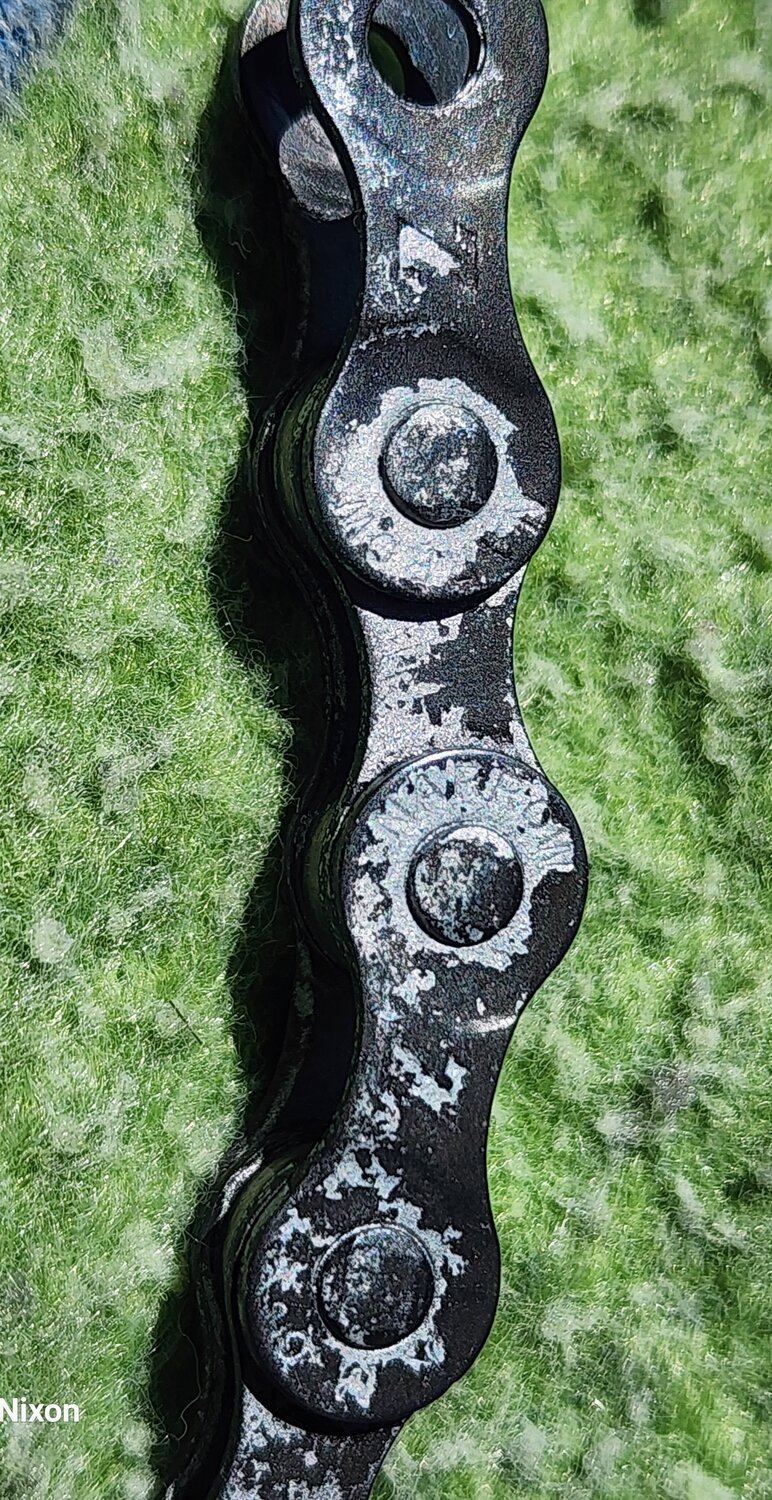

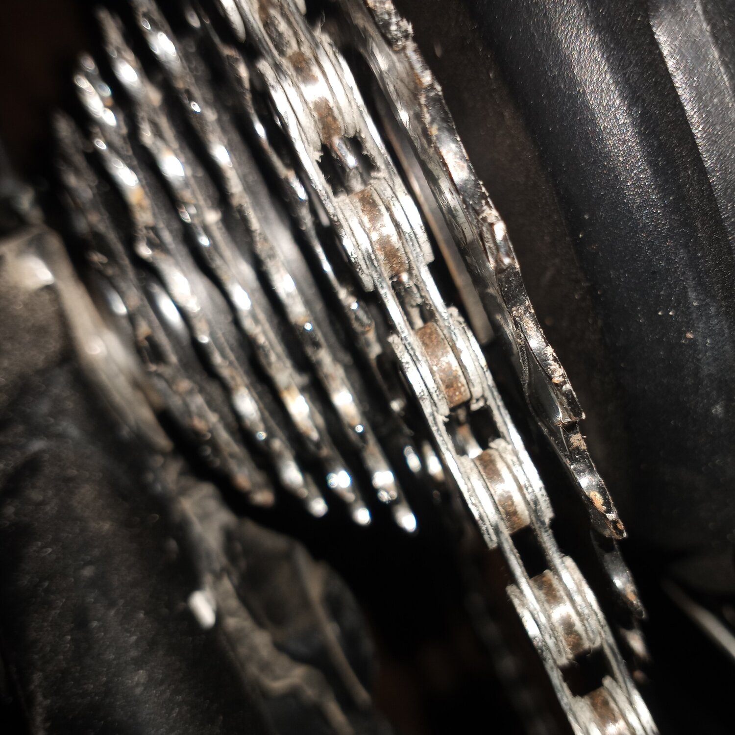

Holy crap Aventon! What is this silver stuff you're putting on your chains?!? I've tried 2 different strong degreasers
MarkNix
My Aventure.2 chain was terrible and wore out in like 350 miles (and to prove I'm not bad at chain maintenance, a SRAM chain on my Tero X lasted 1500 miles).
That said, that looks like corrosion, not a coating.
Definitely not corrosion, I can remove it with my fingernail. The Chain is about a week old. I'm just dregreasing it and the cassette to get a wax lube applied.
What chain did you replace it with? I'm thinking I'll just get a new one and quit messing with this one.
I got this chain. You might need 2x because there are more than 116 links in an aventure.2 chain. But any KMC chain of the right "speed" (width) should be better quality than Aventon's.
KMC e series for any ebike.
My e10 (on Gazelle Bosch 10t) with 11,500 miles and the fifth KMC e10.
Each is good for 2,500 to 3,000 miles with lube every 100.
Complete confidence.

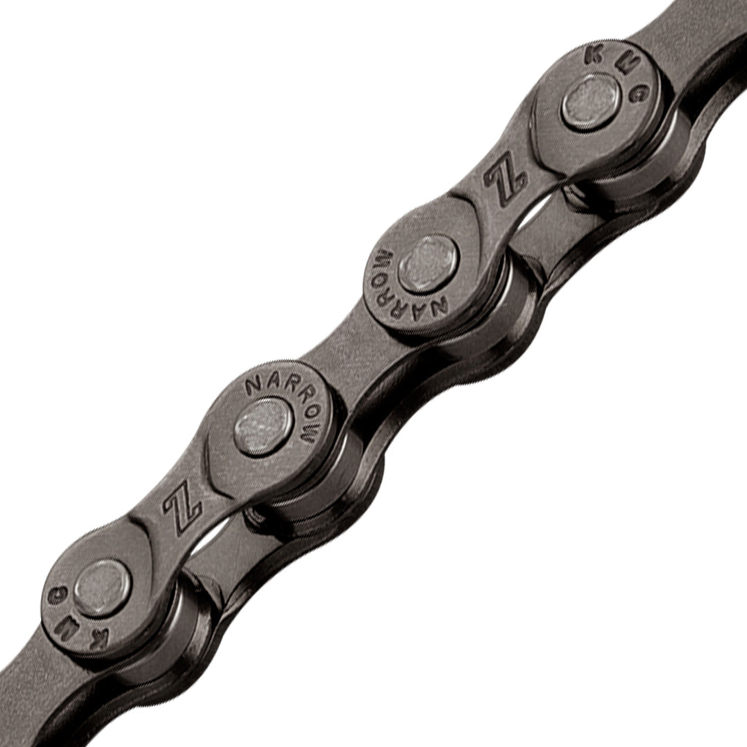

If that's a KMC chain, you're removing the protective layer.
"eBike chain are coated with KMC’s latest breakthrough in rust protection. EcoProteQ treatment doubles the rust resistance compared to the RB treatment. Benefits of the smoother coating are less noise, great performance, maximum rust resistance and great look."

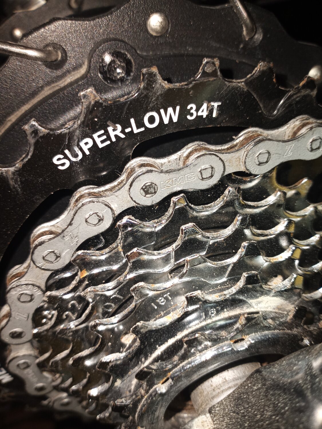

My Aventon chain looks like yours but with no rust. I get 150 to 300 miles per charge, so I guess I pedal harder than most. At 1,000 miles I checked the pitch. It's still slightly under 1/2 inch.
On two chains whose rails looked like plain steel, I'd found that Finish Line Dry Lube, applied to each end of each pin drop by drop with a 25 gauge needs, would prevent rust besides keeping operation smooth and quiet. When the Aventon was new, I marked one link with acrylic paint as my starting point. Then, dropping in zip ties to mark one section at a time, I went around applying drops. I repeated it at 1,000 miles although the chain still looked and performed like new.
I think @MarkNix has a different problem than our chains?
His coating peeled and flaked off, my coating appears to be worn off where it was rubbing?
His chain looks defective to me.

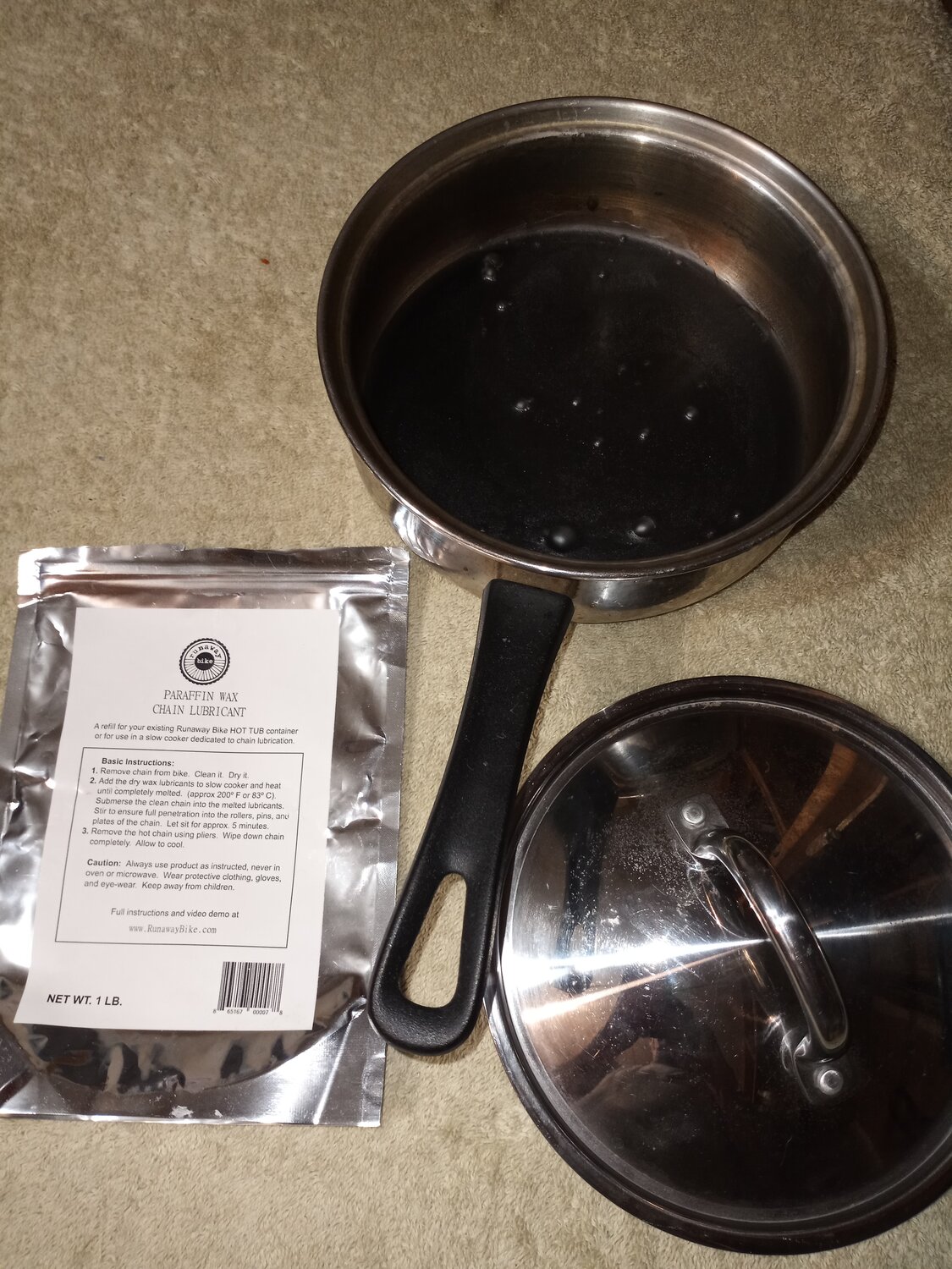

I removed my chain when the bike was new and gave it a hot wax treatment.
I removed all the oil with brake cleaner and acetone then "cooked" my chain on the stove. 😂
I have a dedicated pot for chain maintenance now. 😂
I just re-melt the wax and lube the chain once in a while.
The chain is easier to clean the second time when it's only dirt and old wax on the chain.
It looks like a real PITA to lube a chain, but it's not that bad.
I like the wax because I don't get oily crap all over my pants or hands when I mess with the chain.

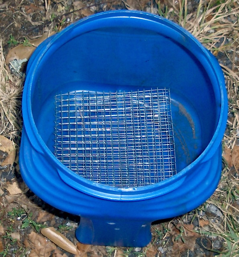

I don't remove the chain to use Finish Line. The first time, when I'd ridden 14 months with oil, I used a paper towel to wipe off what oil and grit I could. Application took about 1 second on each side of each roller. The fluid looks clear on metal, but it caused black stuff to run out of the joints, which I wiped off. It happened every time I applied it. For better rust protection, I learned to let the film dry before wiping. I also learned that when I poured it from the opaque bottle into the translucent applicator, I needed to make sure it was an opaque white; otherwise, it needed more shaking to mix the teflon with the vehicle.
The chain could smudge cuffs but always looked clean. How could it not pick up grit? After 2500 miles I broke the chain so I could coil it and put it on some wire mesh in a coffee can. The can let me cover the chain with a small amount of gasoline, and the mesh let solids settle away from the chain. I covered it and let it soak for hours, shaking occasionally. After I hung the chain to dry, there was still lube in the joints. I carefully poured off the gasoline and found no grit but a brown film which, when dry, was soft like cocoa powder. Besides not picking up grit, it seems that using Finish Line had gotten rid of any grit from 14 months of riding with oil.
I applied Finish Line to 2 other bikes when new. Finish Line switched from Teflon to a borate. The chain can smudge hands and cuffs with gray instead of black.
Before I tried Finish Line, 14 months with oil had caused a heavy buildup of gritty grime around the rear sprocket. Liberal use of Finish LIne can cause instead a grit-free buildup of waxy stuff that's easy to remove with a screwdriver.
Nope thats not what that is. I have KMC chains with and without that coating. Chains with that coating on look more like a dull, bare steel. Not shiny like a nickel-plated one.
EDIT: I found a pic of one: This pic was taken in 2020 and the chain is STILL on the bike, about 1300 miles later. That street-sized chainring is long gone in favor of a 28T.
The stuff you folks are looking at is just paint. KMC makes low-cost chains with different paint colors on it. For idiots who like such things for no good reason in my not so humble opinion. I expect that Aventon just got a decent deal on a container full of them and thats why you have them.

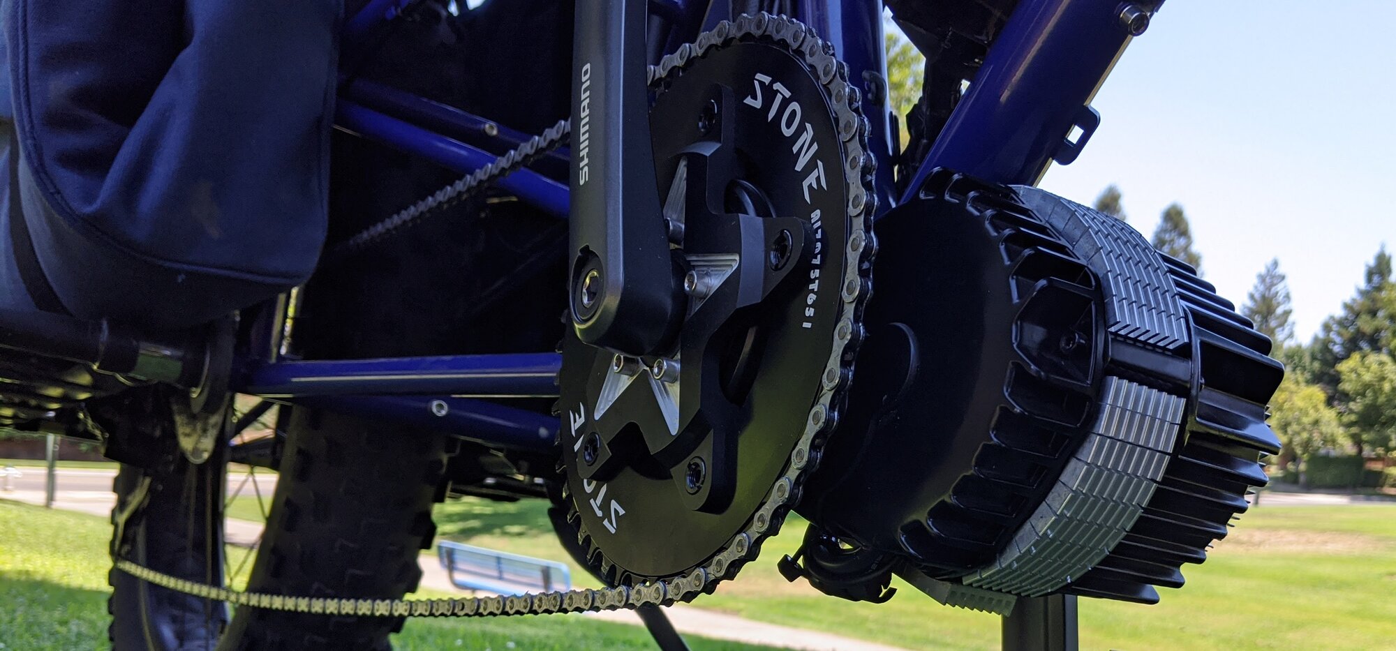

I have over 6000kms/3800mi on the stock chain on my 2021 Stance E.
I use Squirt wax lube. Easy peasy...
Shifting properly does it for the most part.
My son killed his chain/cassette in less than 2000kms from shifting under heavy load.
