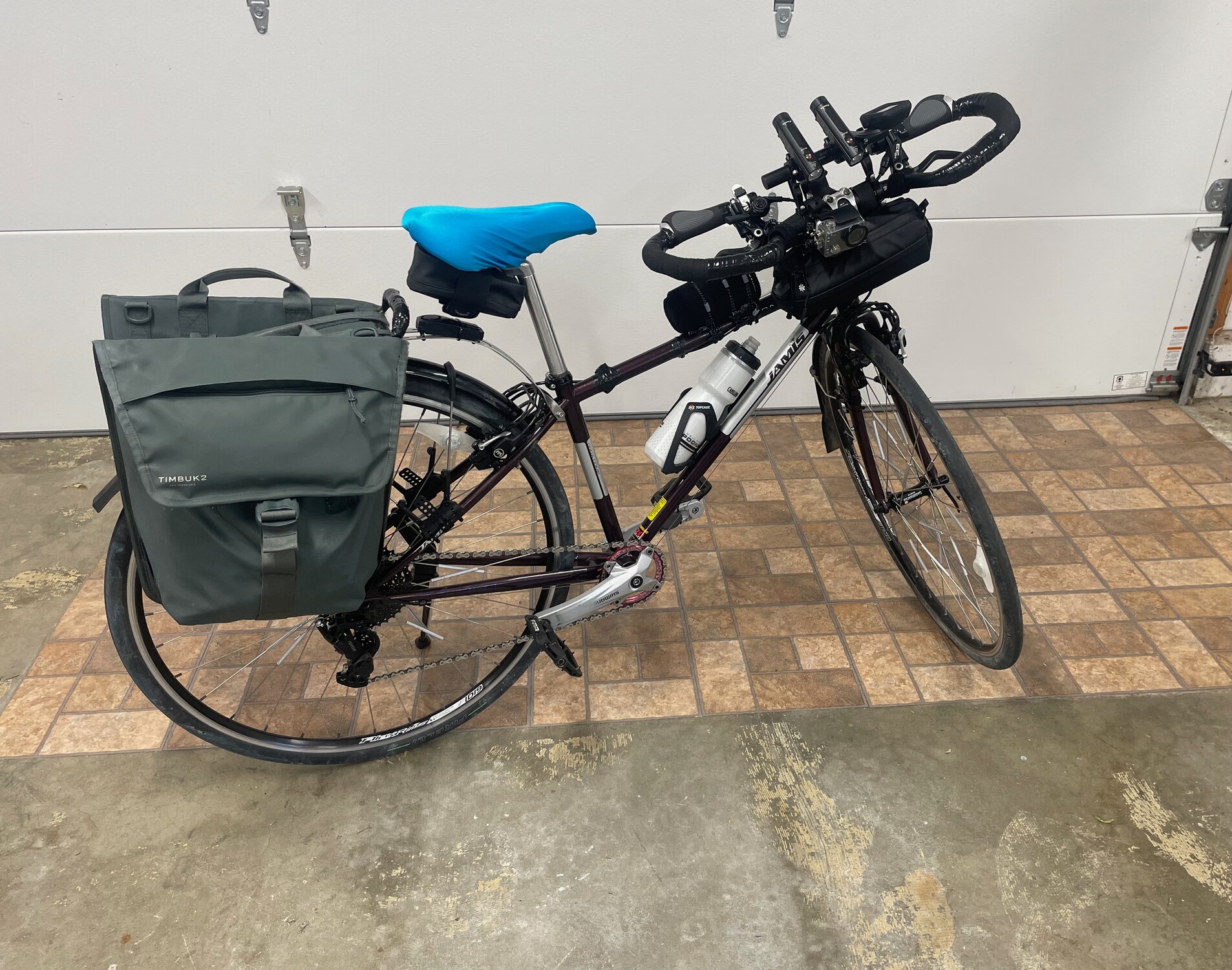

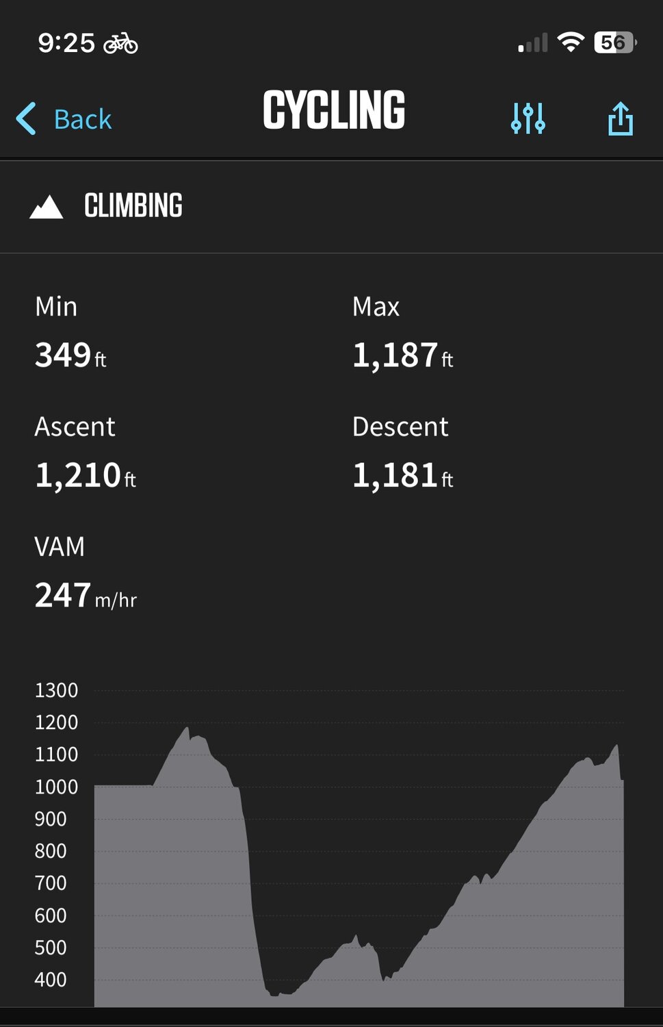

I'm about 155 pounds, but I carry a lot of stuff roundtrip to work, and I'm surrounded by steep hills.
I am considering a friction drive like the QiROLL because I only need something for hill climbing, and I prefer not to have a bunch of extra 'ebike weight' just for hill climbing assistance. I'm in decent shape, but at the end of the day, hill climbing is not fun.

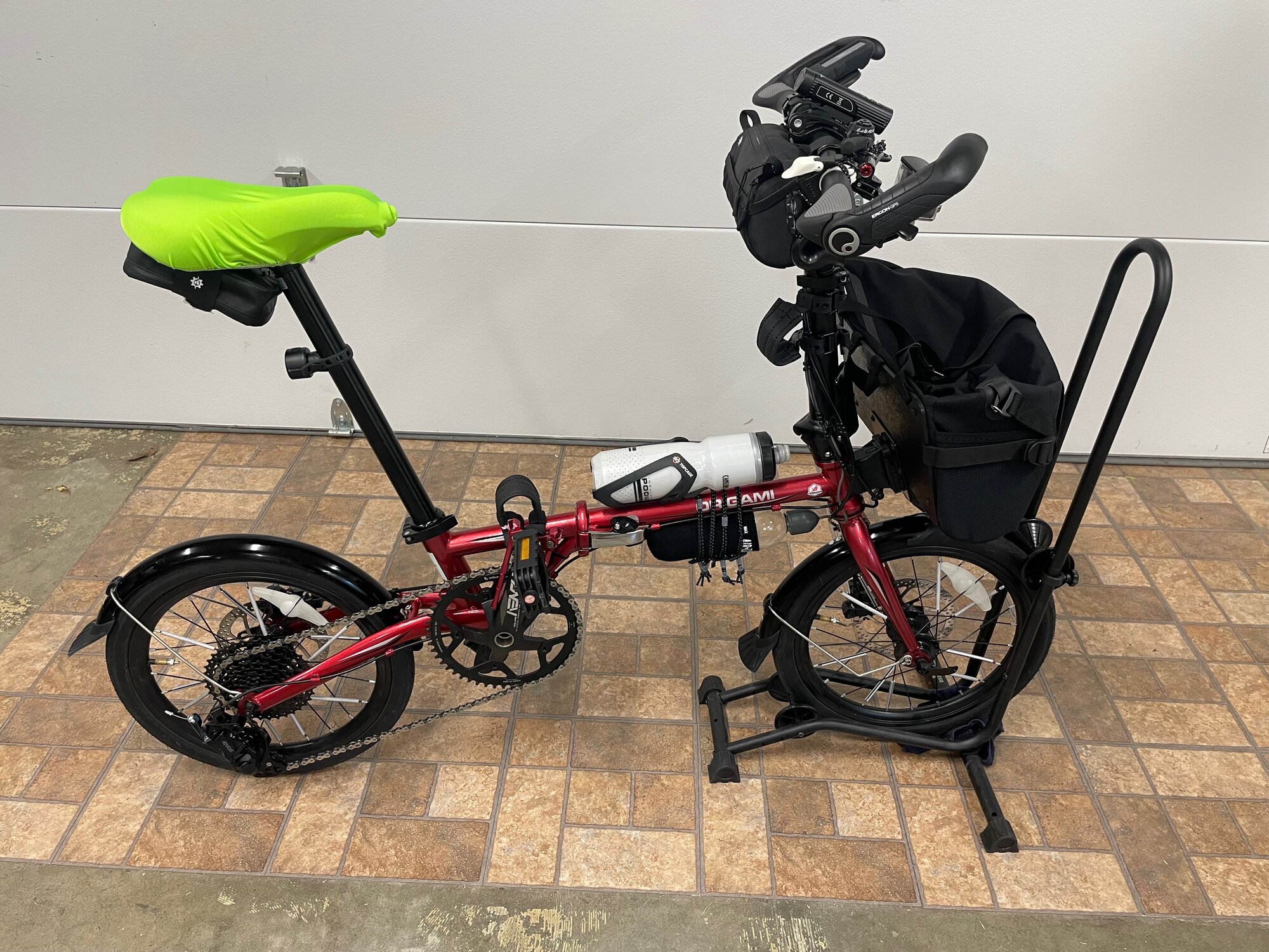

I have two bicycles, and I was hoping to have something to swap to either. However, my primary ride is the hybrid.
I've attached three images showing my commute of 10 to 12 miles and my two bicycles.
Any advice is appreciated!
Please let me know if I posted to the wrong category here.

your fine, now consider this anything helps,I once used a 350 watt"i mortor" all in one setup,when combined with the bikes stock 350 watt 36 volt motor the bike climbed well,now consider this,anything helps the biggest drawback on the "i mortor" setup was the weight,probably a couple of pounds heaveir than the Qiroll" it was very simple unclittered setup and cheaper then the Qiroll.oth the "Qiroll" will give you nice assistance( more than the average ebike rider-imo it takes a pretty strong rider to output 250 watts on a climb.
