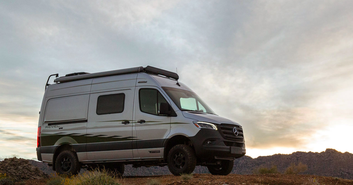

The Winnebago Revel can serve as a reference vehicle for features or layout that benefit your application. The Revel is heated by diesel fuel.
Winnebago recently provided a 2021 Revel sneak peek with a short teaser video and some details on the van. The biggest news comes in the form of a fully redesigned kitchen block that starts with a
  • portable induction cooktop in place of the inbuilt cooktop.
The new single-burner can be used
  • indoors or
  • out and
  • frees up countertop space when it's stored away in the drawer,
a nice advantage for the Revel's slim kitchen block that previously relied solely on its foldaway counter extension and sink lid for prep space. The new rectangular sink gets pushed to the rear of the kitchen, and Winnebago moves the
  • 85-L fridge over to the front end of the block,
  • where it can be accessed from indoors or outdoors.
On the outside of the kitchen block, Winnebago dumps the pedestal in favor of a cable support for the drop-down table, an adjustment aimed at easier use on non-level ground.
  • The Revel was always an off-grid van, and Winnebago streamlines that capability for 2021 by swapping the
  • triple-AGM battery system out for a
  • pair of 125-Ah lithium-iron-phosphate batteries.
  • The new batteries come complete with a
  • Bluetooth monitoring system and a
  • dedicated second alternator for direct charging during the ride.
  • A solar charging system and
  • 2,000-W inverter come standard.
