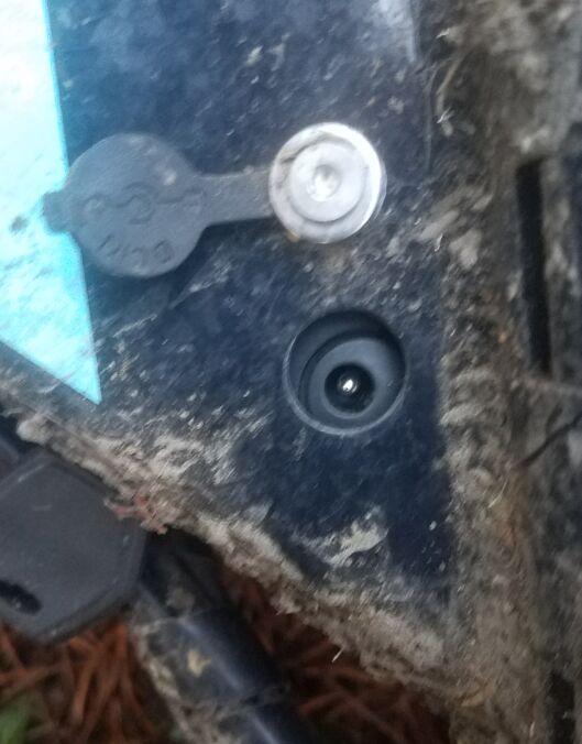

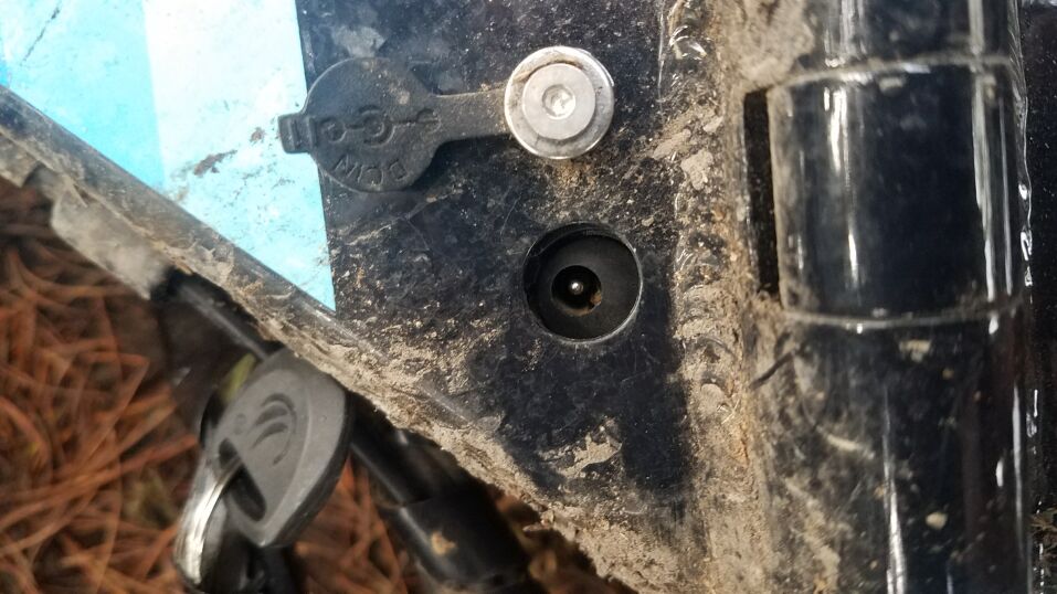

The new high-capacity battery has to be "forced" to connect when unfolding. In other words, there is considerable resistance to closing the hinge, and when closed the charging port is offset just enough to prevent charging plug insertion. It appears the new battery connector end is several millimeters offset when compared to the standard battery end, and closing the hinge forces the battery down slightly, placing the charging port off-center (see photos comparing both battery charging ports).
