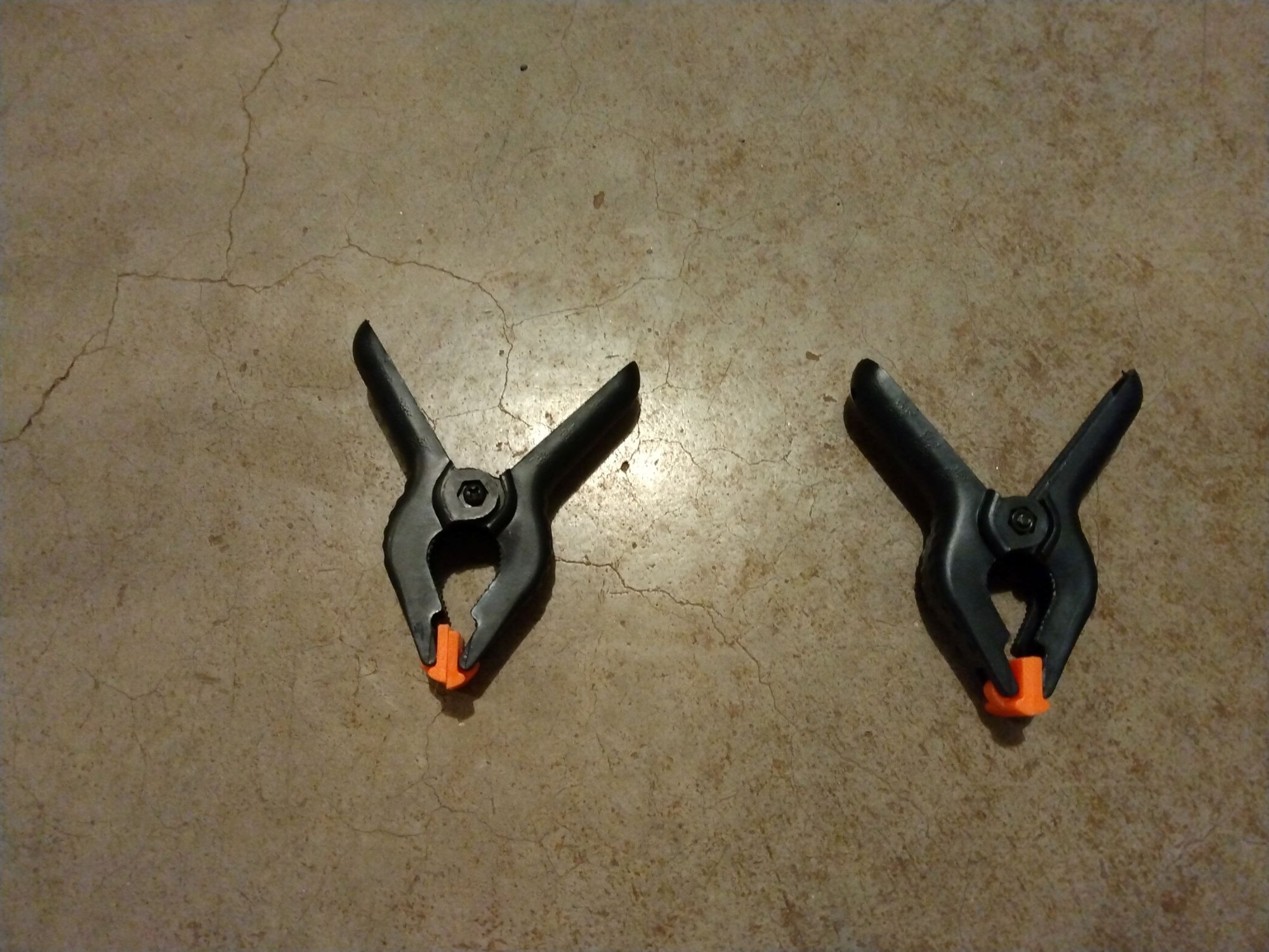

Large Harbor Freight SPRING CLAMPS can substitute for the more boutique "handle bar tripods" used when inverting the bike to work on drive train or remove wheels.
The clamps run about $10 for two. You can use more than two. I haven't tried it yet. Still, the tripods cost about $40 and the clamps $10. It' worth investigating.

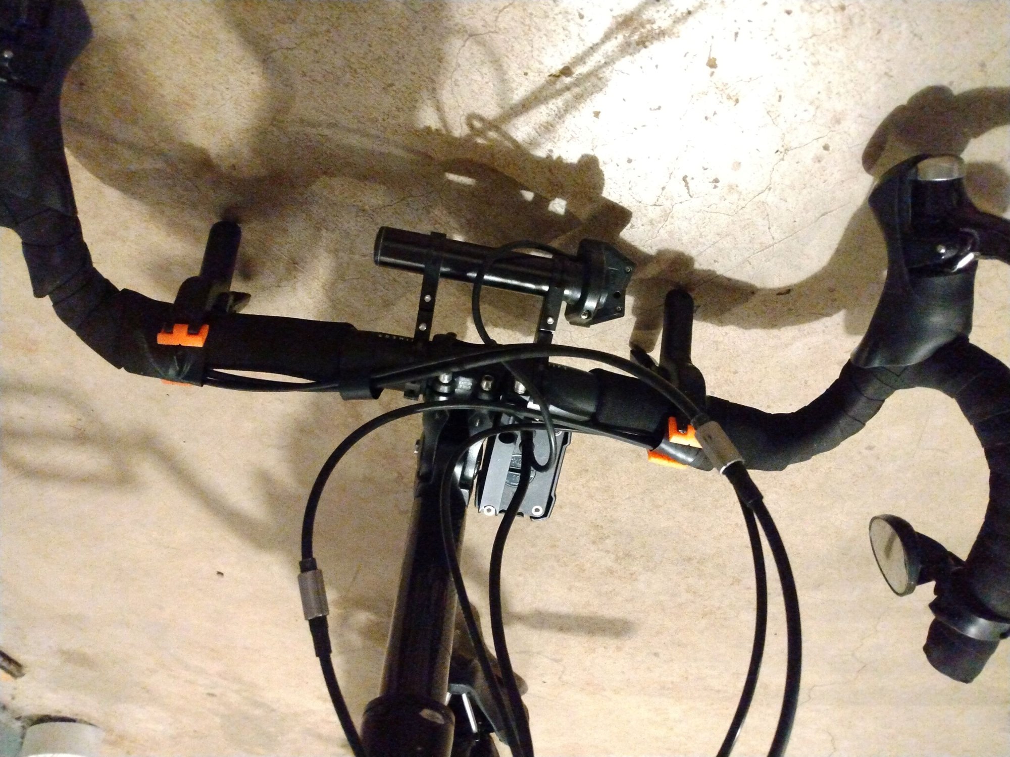

The clamps attach quite securely to the hand grips on my XP4.
Have you tried this method?? Comments, please.

Take a look at the Harbor Freight site, search "SPRING CLAMPS". The clamps come in various sizes which relate to how wide the jaws open.
Use the metal clamps, not the plastic. Why pay $40 if $10 spent at HF will do the trick???!!! Plus, the HF clamps have other uses around your shop and house.
I assume that you are using the small plastic clamps which are too small for this application. The metal 3 inch have quite the grip on the bike handle grip.

Very strong grip, seem to work well on handlebars if needed for flat repair. I like that they are small and very light weight. Will be good for clamping tarp to the mower too.

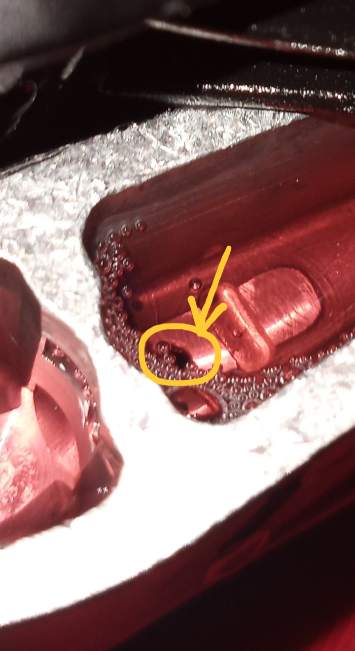

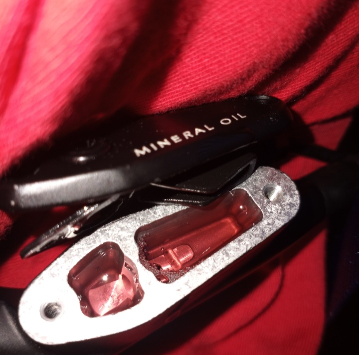

You should be fine as long as you don't operate the brake levers with the bike upside-down.
Air can't get from the reservoir and into the the brake lines unless the brake lever is operated.
I've seen opinions go both ways,
I took my brakes apart to investigate,..
- no fun out in the boondocks a couple hundred miles from home with air locking the brakes.
That's with pneumatic air brakes. (Like on an 18-wheeler.)
Hydraulic brakes leave you with no brakes when there's air in the brake line. (the brake lever will hit the handlebar without the brake activating.)
@Jeremy McCreary
I'm pretty sure that ALL Hydraulic brakes operate the same way in that air can't get from the reservoir and into the brake line without the brake lever being operated.
I'm pretty sure that it's a safety feature to help keep air from getting into the brake lines?
(if the reservoir is bouncing around, bubbles could get splashed up into the master cylinder fluid input port?)
Maybe @stompandgo knows something about that?

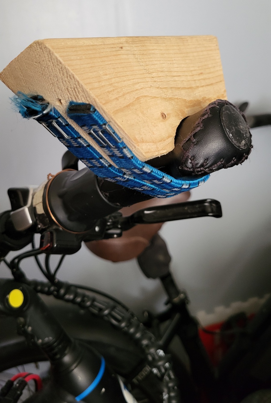

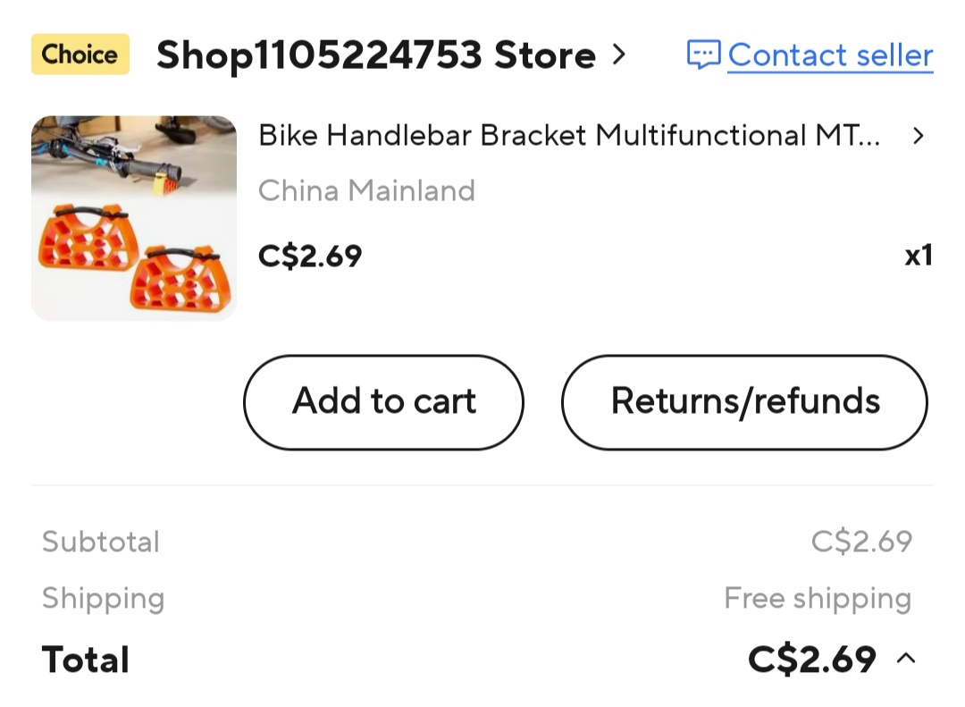

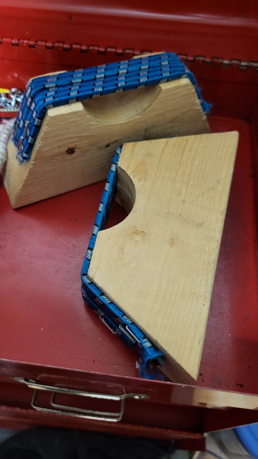

I said F-that, and made my own out of 2x4's and a hole saw.
I just revamped them last month with two strips of flat bungee cord to keep them from tipping over sideways.
I bought a three dollar pair of plastic stands that were too small.
The rubber bands kept popping off, so I melted the plastic to lock the rubber band in place.
It worked, but I had to slide the T-stands onto the bars.
Then I dropped the bike about 6" onto the stands and the one stand shattered.
So I'm back to using my homemade T-stands.
