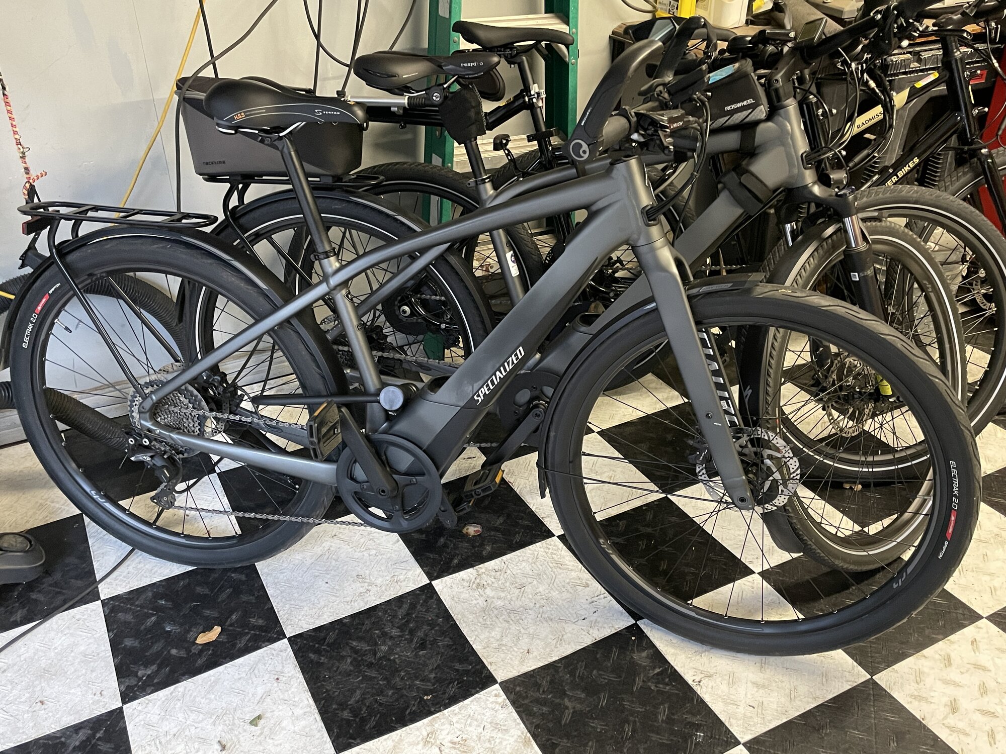

I just purchased this bike from an estate sale. They called it a Turbo Vado/Como 5.0. The bike's serial number comes back as a Turbo Vado 5.0 but the non-suspension fork confuses me. Were Turbo Vados made without suspension forks? Also any ideas as to model year. Sellers listed it as 2021 but there's nothing on the tags or the Specialized site that lists model year. Thanks for any Help!

That is probably correct...the 2022's have suspension forks and the downtube is narrower. Hope that helps.
It is the 2017 model. Very good model if the battery is still in a good shape. If not, you would need to order a new U1-600 battery from a Specialized dealer but such battery is expensive. I own the same model but Step-Through.
Please check whether the display is a colour one named BLOKS. If yes, it is some trouble but it could probably be sorted.
Note: Suspension forks have been introduced to Vados in 2018.

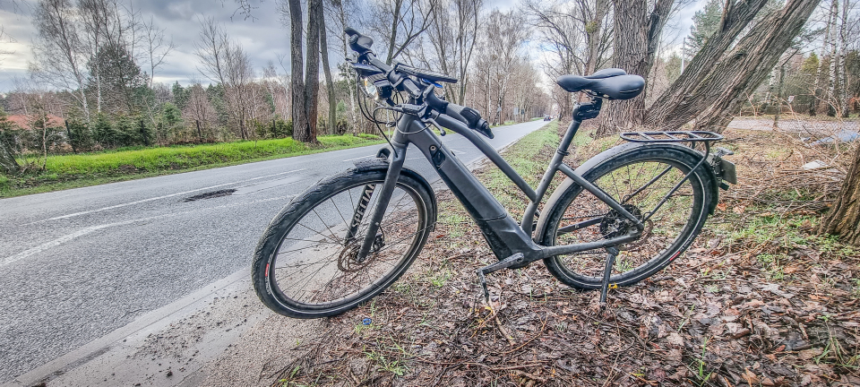

MY 2017 Vado 5.0 ST that I ride (April 2022). This e-bike was also upgraded to the TCD-w (Vado 6.0 set) in 2020.
