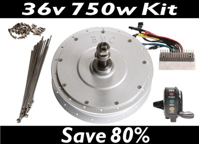

I just found these kits on Ebay. 500w and 750W.
Any advice on which battery I should get? I'd like to pair it with one of those water bottle looking ones. It looks like they come in 7ah and 10.5AH.
The 7.5-10AH models is longer than what you saw in the pictures above, because they put 30 cells in there,. Unit Pack Power sells them on ebay , their china website and maybe on amazon. I've got a 7AH and 10AH from them, The former is pretty low capacity. They might only push 20A continuous, which is OK for a 500W motor. My own 500W ebike will cover 20 miles on 6AH at 13 mph.
