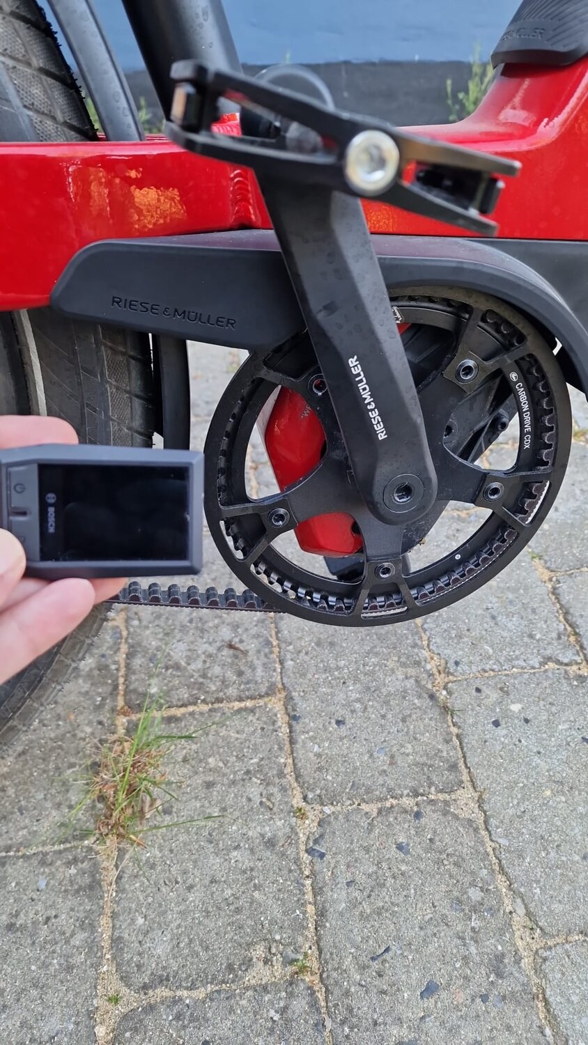

Would you please post a photo of the middle of the bike from the right side? First place and tape any object that is 100mm long, such as a strip of paper where the pedal arm attaches to the middle of the bike. We will advise you on chainring options based on things such as BCD and the number of ringbolts. Members can define those more technical terms later. Note: It would require a new longer chain.
We will need to determine if it is 110 BCD or 130. And if it is 4 bolt or five to the spider before we can talk about relevant chainrings.

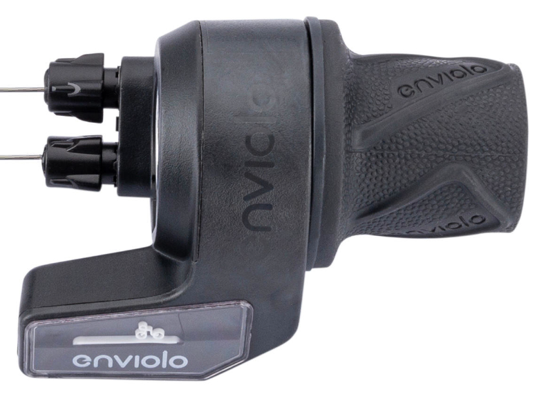

Also, shown in the second pic above is what you use for a "shift indicator". That flat line as shown in the pic would mean the CVT is set for max speed on a level surface. When you see the flat line form "a hill", the trans is downshifting. How far it has downshifted shown by the height of that "hill" on the indicator. This probably would make more sense if you could actually see it working. A little difficult to describe here....

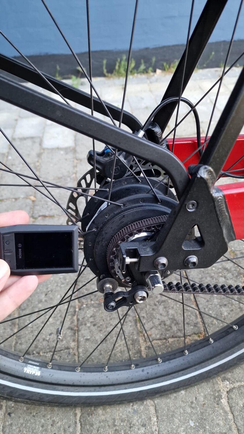

I could easily be wrong - and this does not bear on the reported problem in this thread - but that pic of the rear looks like the belt is loosened somehow. Looking at the Homage on the R&M web site, there should be tensioners on the thing that keep that belt up close to the sprocket down low, and not bowed out as it is.

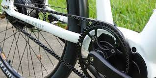

The belt ring cog by the pedals will need to be swapped with a larger one in order to raise the gearing so you are not spinning out.

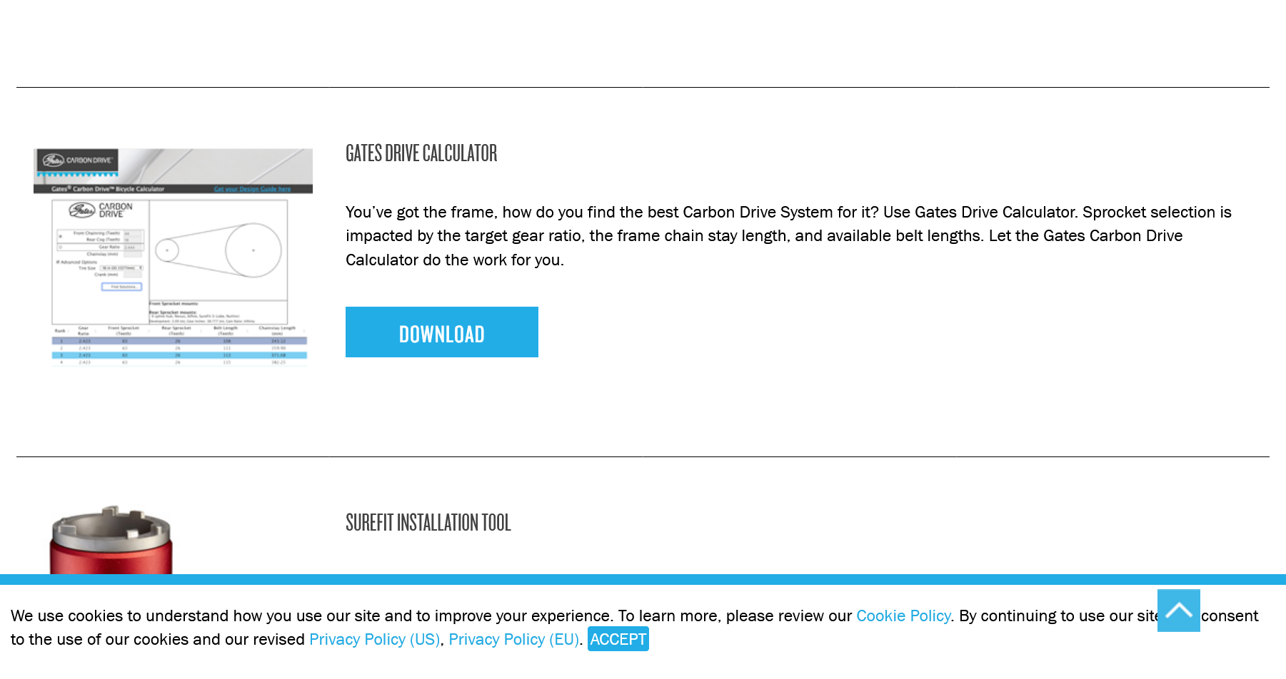

This also means a new and longer belt. Click here and scroll down to download the calculator tool. Or just send the link to your new bike shop so they can order the parts based on your needs.
Good eye, I think you are right as the "tensioner" in the pic is installed wrong and is supplying no tension to the belt. It should be facing forward with the roller on top of the belt pushing down on it to provide tension. There is an adjustable type dropout that is also being used to supply tension to the belt. As I understand it there are specifications as to how much tension the belt should be under.

As-installed, the rear tensioner appears to be worthless. It certainly isn't needed to keep the belt on... unless it IS since the belt is loose? All it does is hold the belt tight to the sprocket.
Huh....
I had some problems with a squeaky belt but thought it was just due to the belt itself needing lubrication. But what you said made me think again, and comparing the belt in my girlfriend's similar bike, it was clear mine was loose.
Measuring with the Gates belt app, it said 20 hertz. The recommended number is 50 hz but definitely not below 40! After tightening the belt, I realized the two sides were not in alignment. The left side was 3-4mm out of whack compared to the right side, seems like the mechanics didn't really bother with adjusting the belt at all.
After this the belt runs great, no squeak, and I even got a bit more top speed - not quite 45 but 40-42ish so pretty close.
I also adjusted my girlfriend's bike, her belt was wayyyyy too tight at 75 hz, I took it down to 50. And again, both sides not aligned at all.......

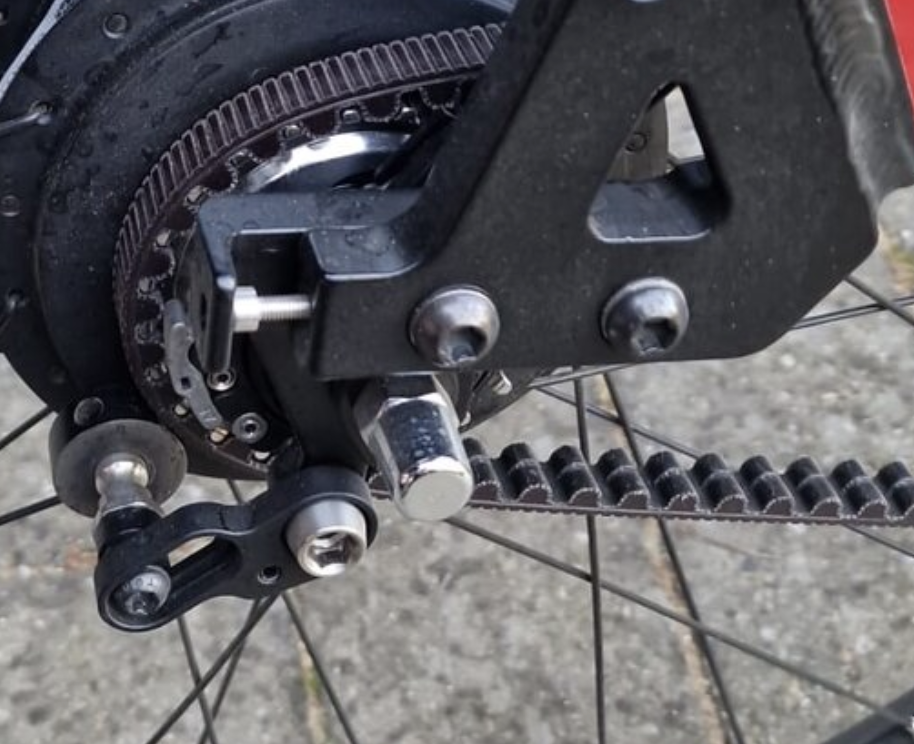

EDIT: The tensioner does not touch the belt at all, is it meant to? I couldn't figure out if it's supposed to touch or if it's just there to keep the belt from jumping off.
I believe what is being referred to as a tensioner is correctly installed. It appears exactly as mine does. You can also check out a clear photo of it from Propel Bikes at 9:28 in this video:
. Tension is adjusted with the two screws, one on each side and accessed through the circular opening of the bracket perpendicular to the frame. Of course the wheel has to be loosened to allow the tension screw to move the wheel fore and aft. I'm not sure, but the gizmo being referred to as the tensioner is more of a belt retainer.
