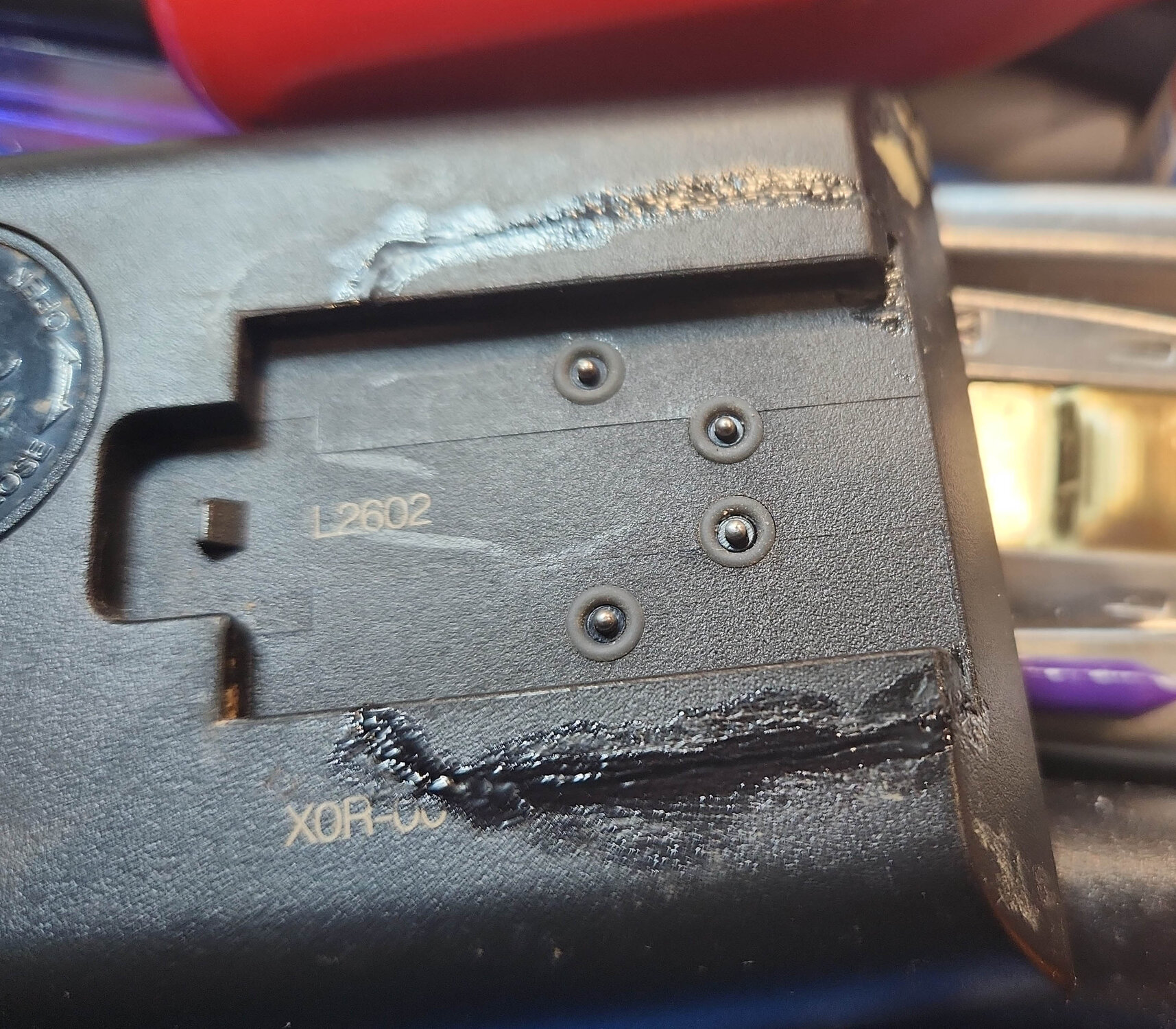

I had my display break the little rails off, the rails pieces were nice enough to stay in the handlebar cradle for the duration of my ride. I wanted everyone to know this displays plastic casing seems to work well with a solvent welding using Acrylic Cement. I dabbed a tiny layer on both surfaces then pushed them together. Anyone familiar with this stuff knows it's an amazingly good bond when done properly. I will be carrying zip ties on future rides, a little disappointing to learn that the bike power no longer works without the display connected. I am considering devising a low profile adapter for the top of the frame below the neck to eliminate this issue completely. if anyone knows where to get the sled mount part cheap, I'd appreciate the input? For now I cut my fork tube shorter and have it sitting as low as possible, it used to sit higher due to fork spacers on top I didn't need to run.
