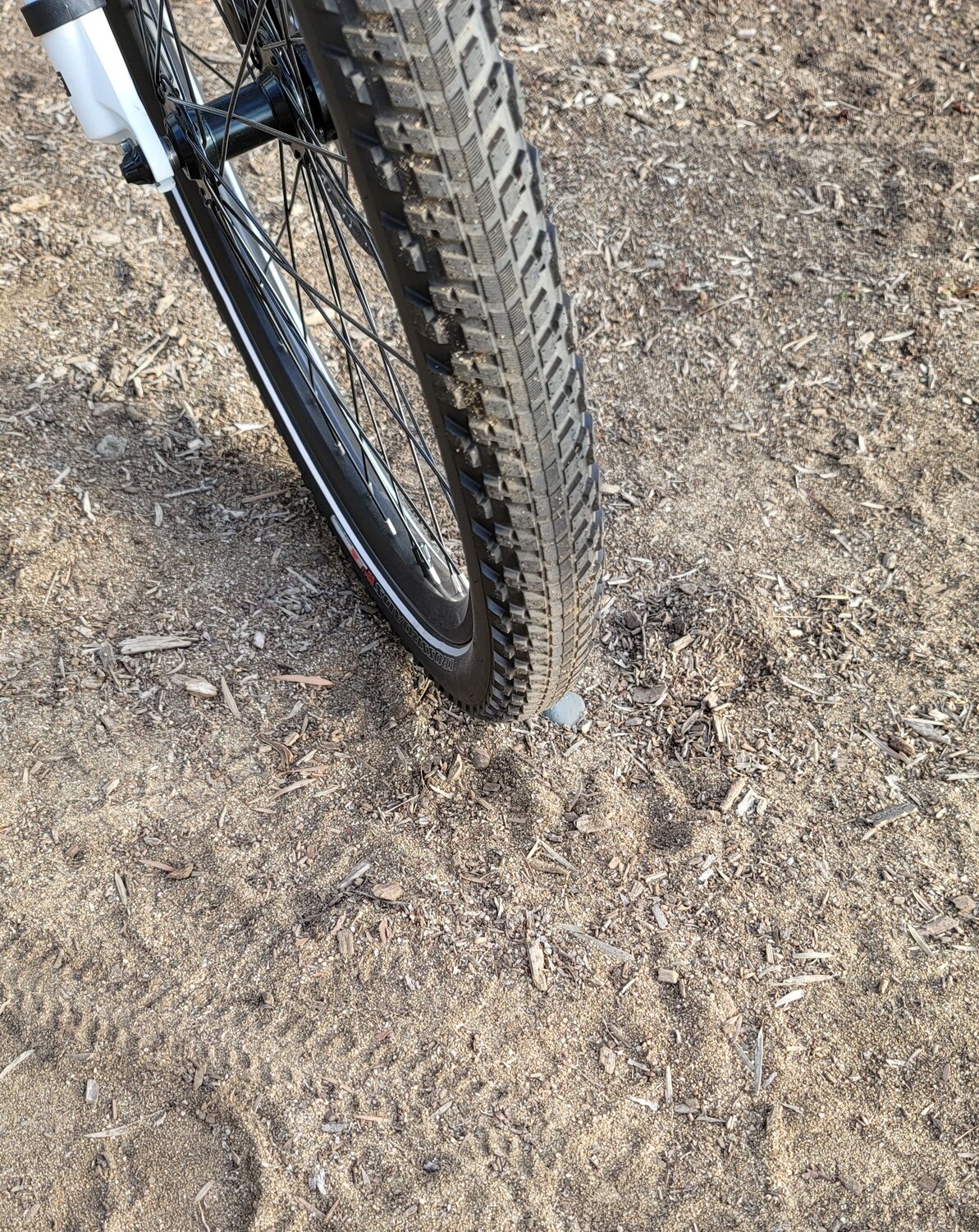

Very pleased with my 27.5" x 2 3" hybrid Crossroads Armadillos after 1,500 miles. No punctures with Tannus foam inserts; smooth, easy rolling on pavement with little noise; good grip on gravel, dirt, and sand (if not too deep or dry); comfy enough ride at 35 psi.
Here you can see both the tread and the track it leaves in loose, dry dirt. Plenty of side-lug engagement for most purposes.
Not trying to sell you on this particular tire. Just pointing out that you have options for mixed riding at low puncture risk.
