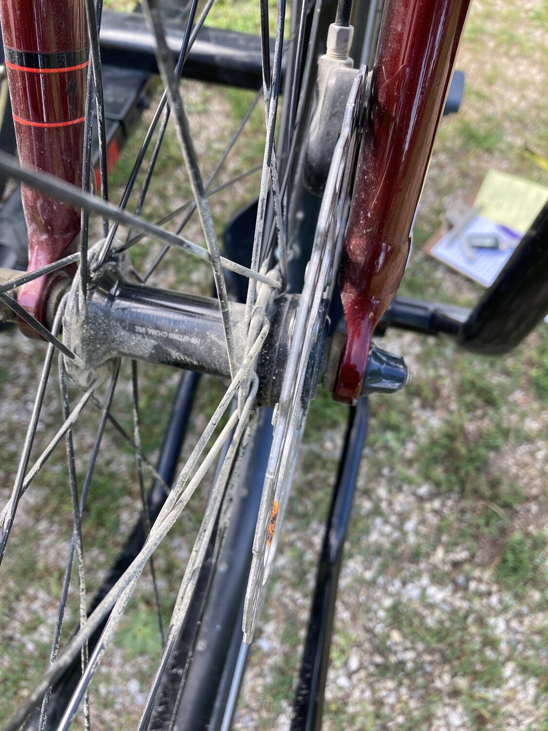

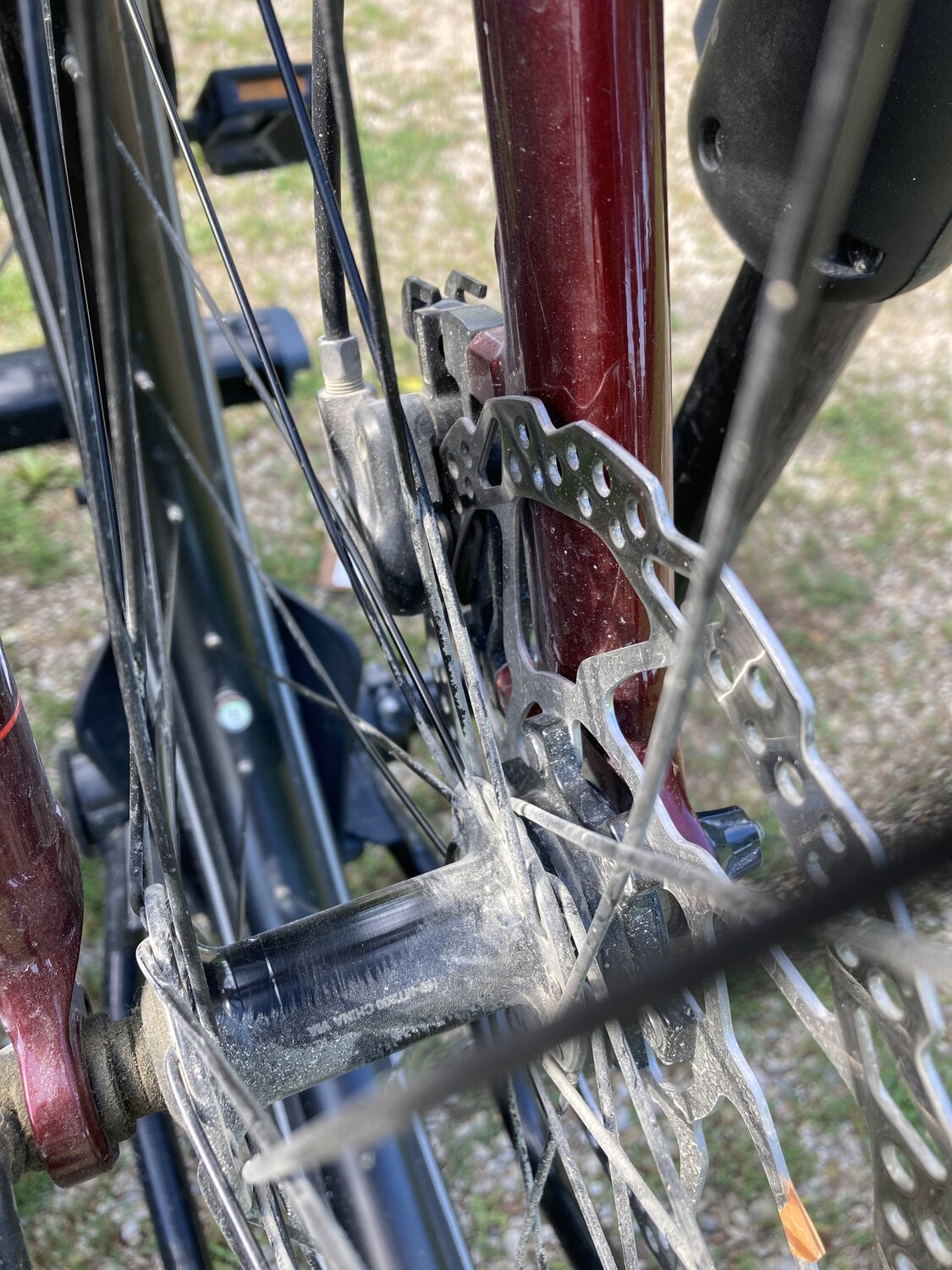

Can I install a Front hub motor for a SP roll elite bike with disc brakes? Does anyone know if the rotor will rub on the fork?
The brakes are hydraulic Shimano MT-200
Thank you.

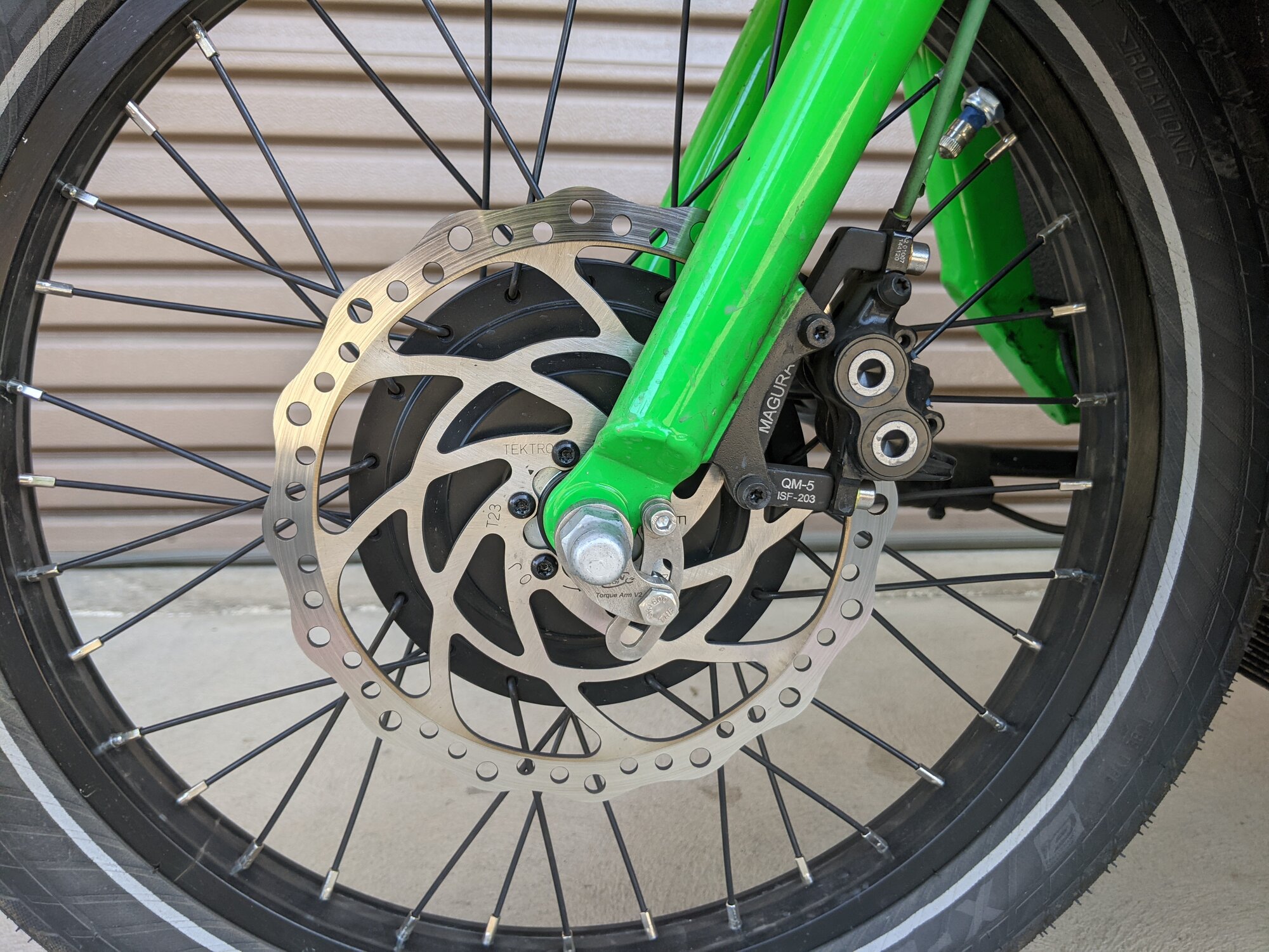

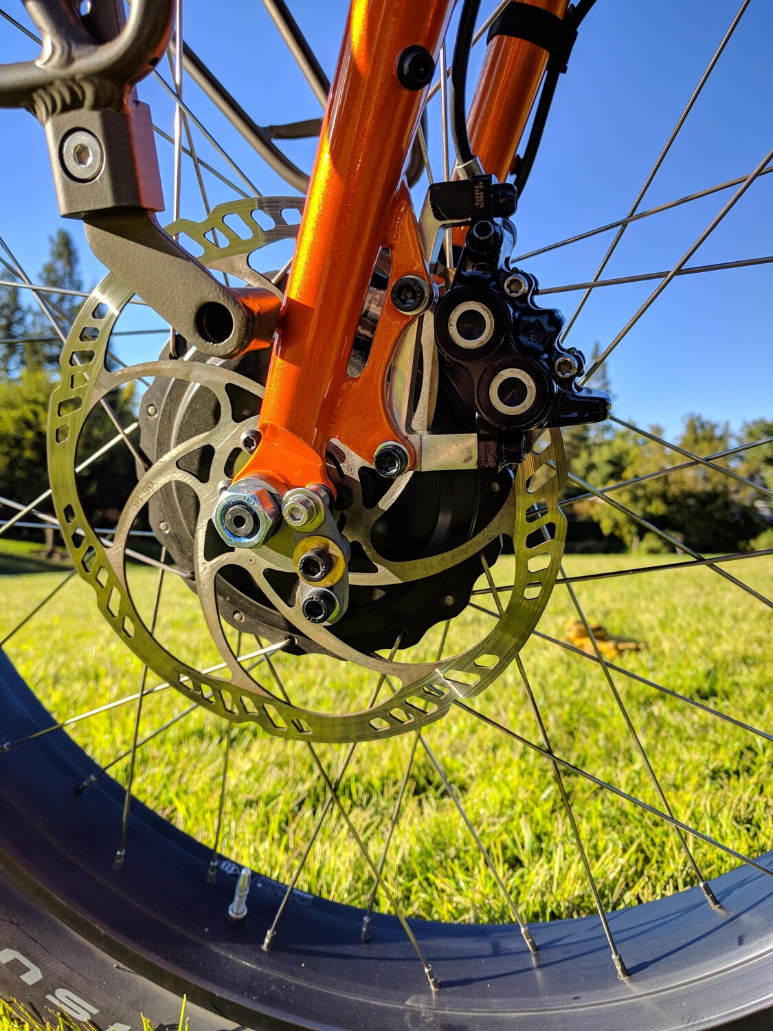

2100 miles on the green one below and still going strong. 45Nm motor. About 7000 so far on the orange one. An 80Nm motor. Both use a Grin eyelet 'v2' torque arm. 1/4" stainless steel. I have others these are just the easiest, prettiest pictures I came across.
