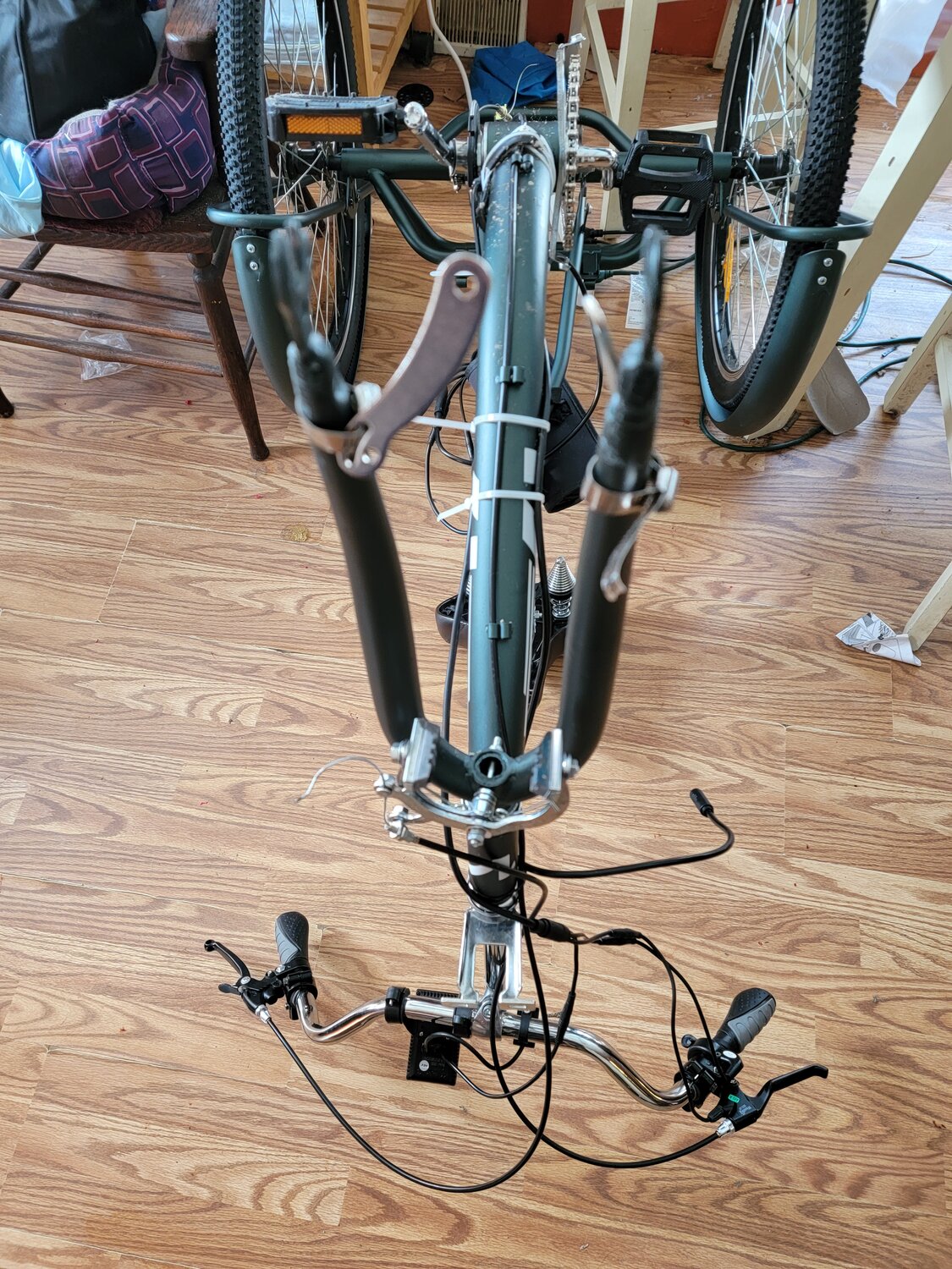

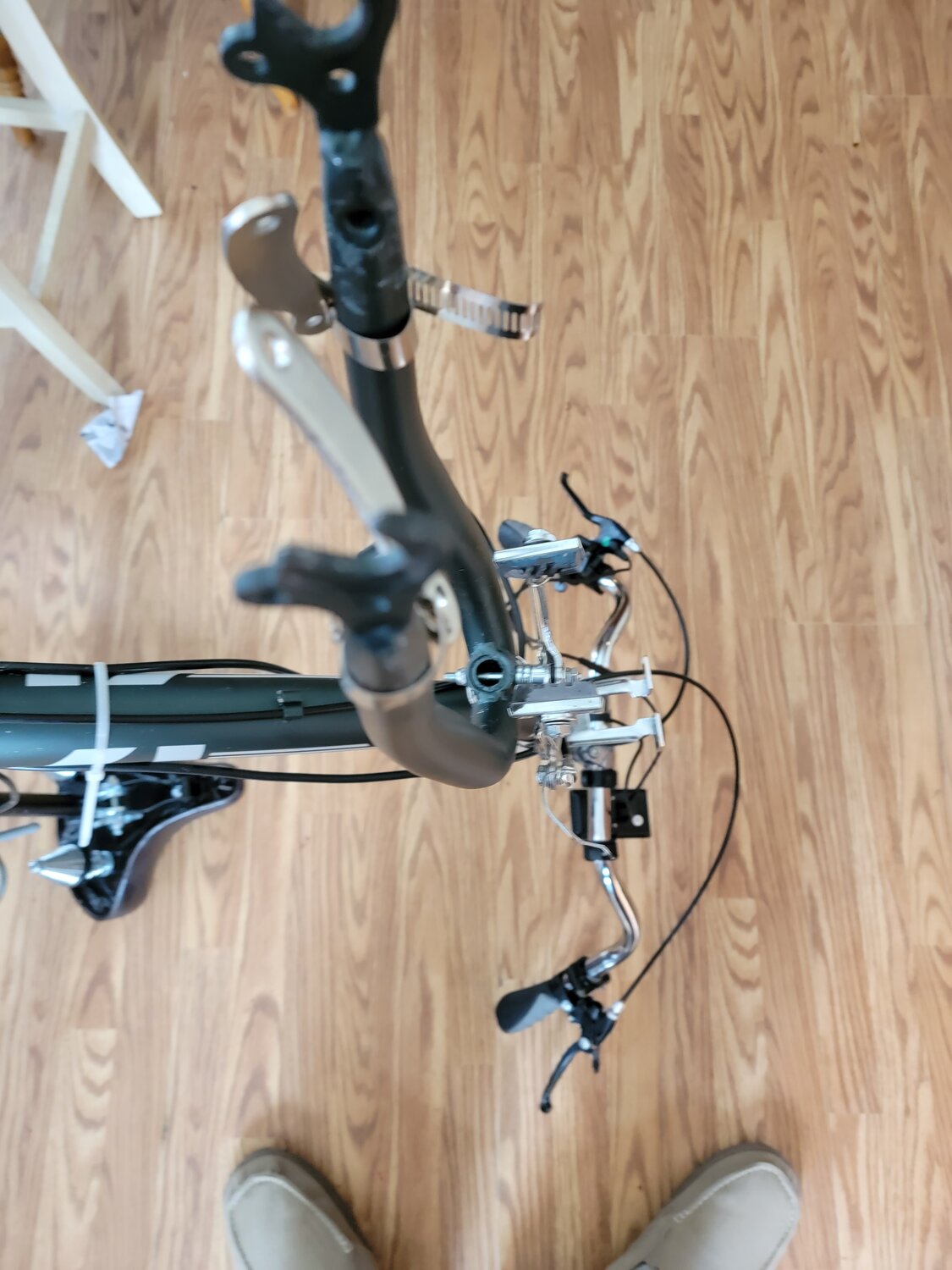

Front fork bent

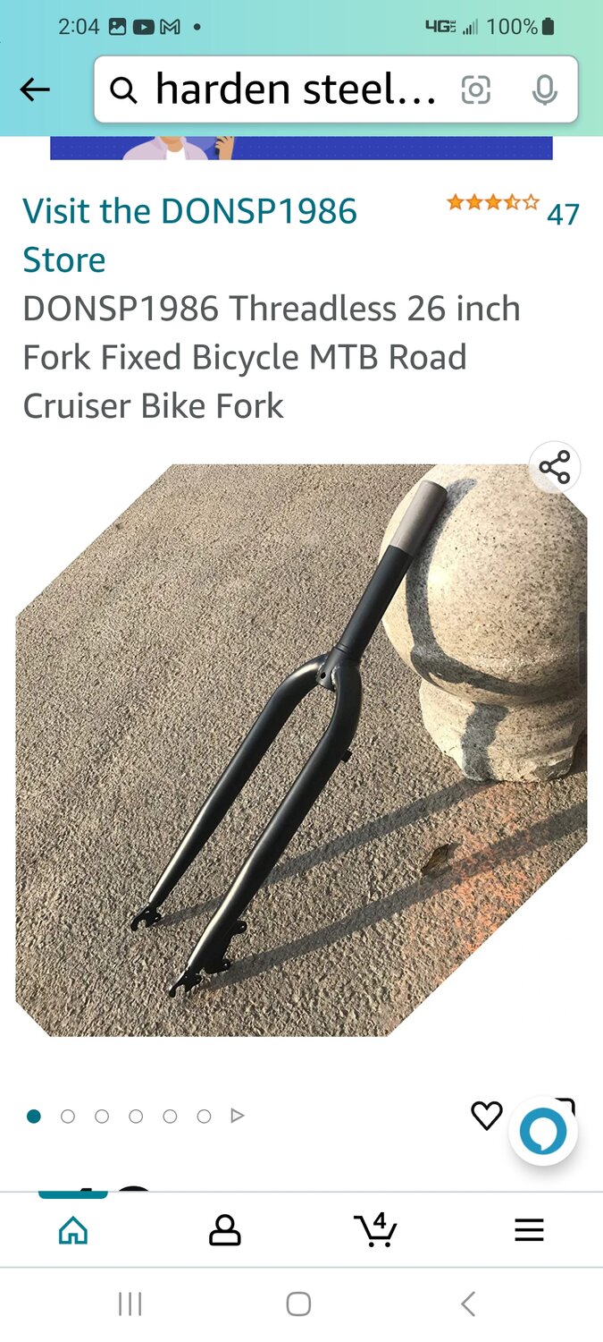

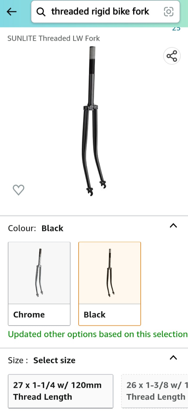

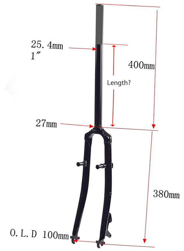

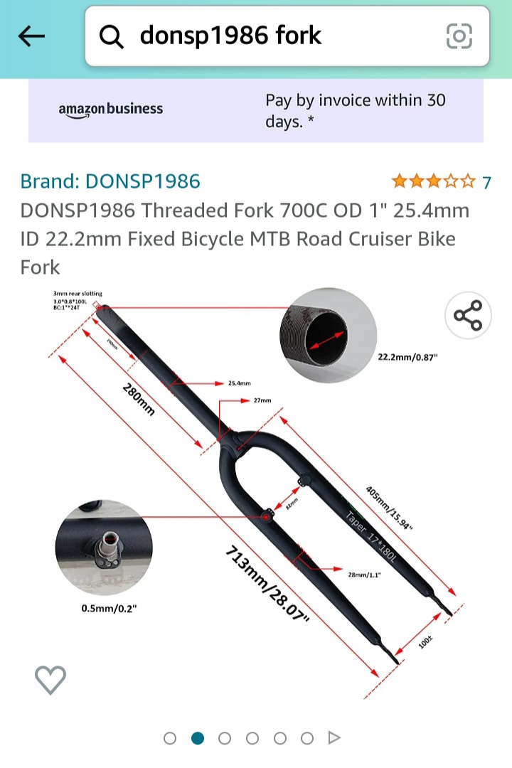

Nothing can happen until you measure the dimensions of the fork, First you have to determine if it is threaded or threadless, Not just a matter of looking at pictures. You have to get the dimensions,
The diameter is the next parameter. It's either 1" or 1-1/8" for both types. For a threaded fork, if you look at the stem that goes to the hand;bars. that will be either 1" or 7/8" for the respective sizes.
Then you have to measure the length of your frame to determine if the candidate fork is long enough. And if it is a threaded fork, if the thread are long enough to extend into your frame,

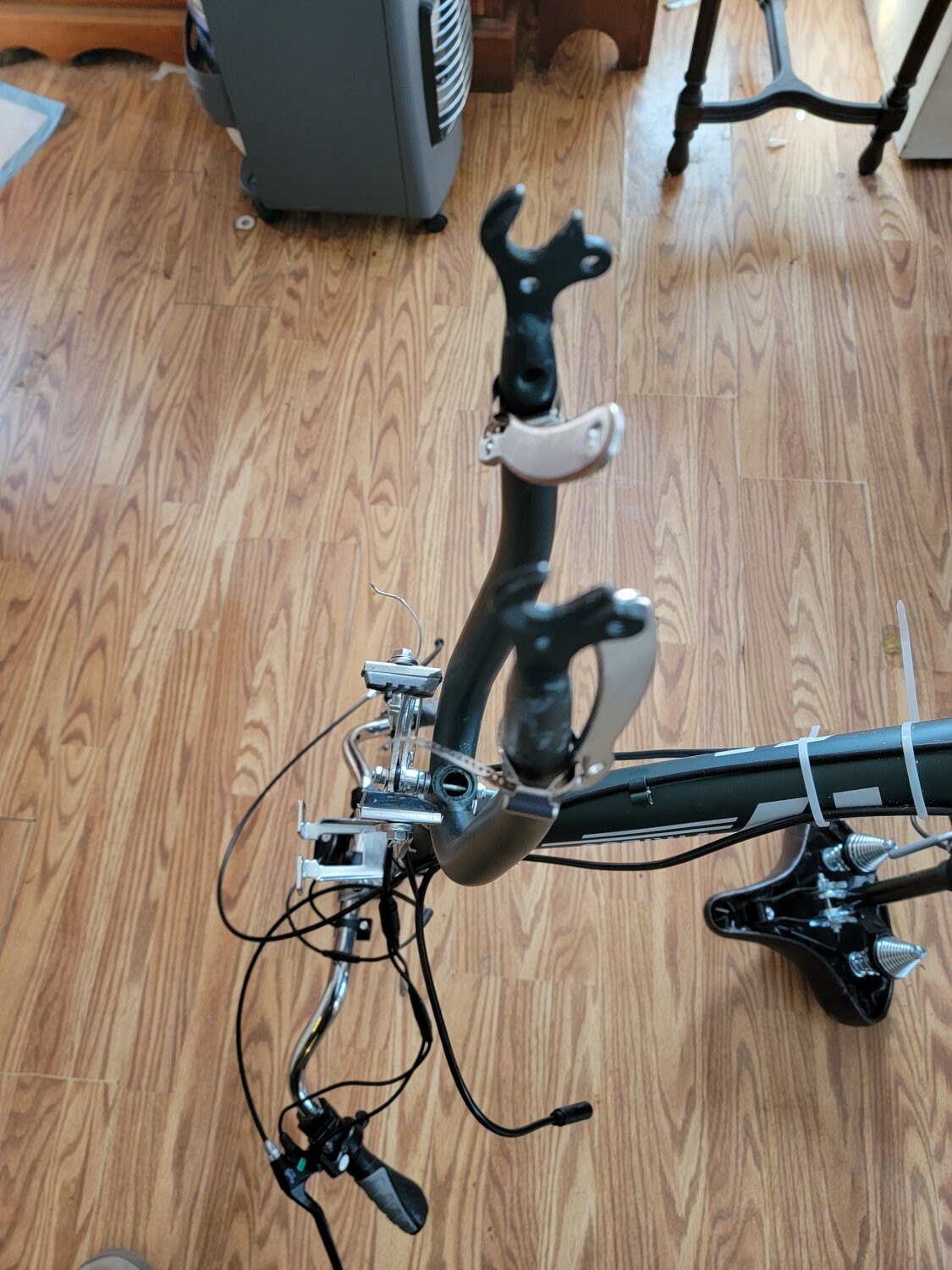

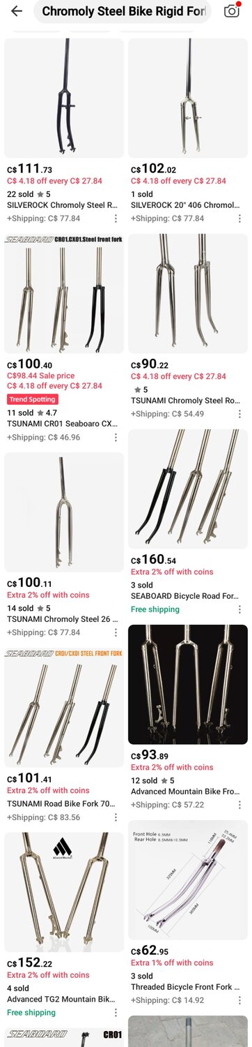

It looks like you have a threaded fork, and those can be hard to source. They nay often be long enough,. but not have enough threads, Also,with rim brakes it may not be possible to use a 700cc fork if you have a 26" wheel. The calipers may be too short or too long,

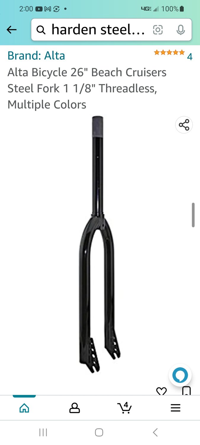

Suspension forks are almost always alloy and even weaker than steel forls when it comes to a motor.Your best bet is to have buddy that's a good welder. Find a steel fork and weld the top tube of the old one to it, Weld on taps for disk brakes. Beef up the dropouts by welding the torque arms to them.

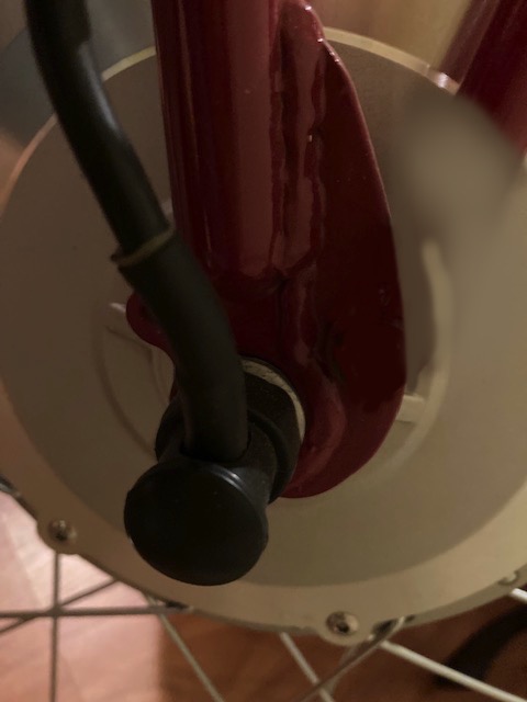

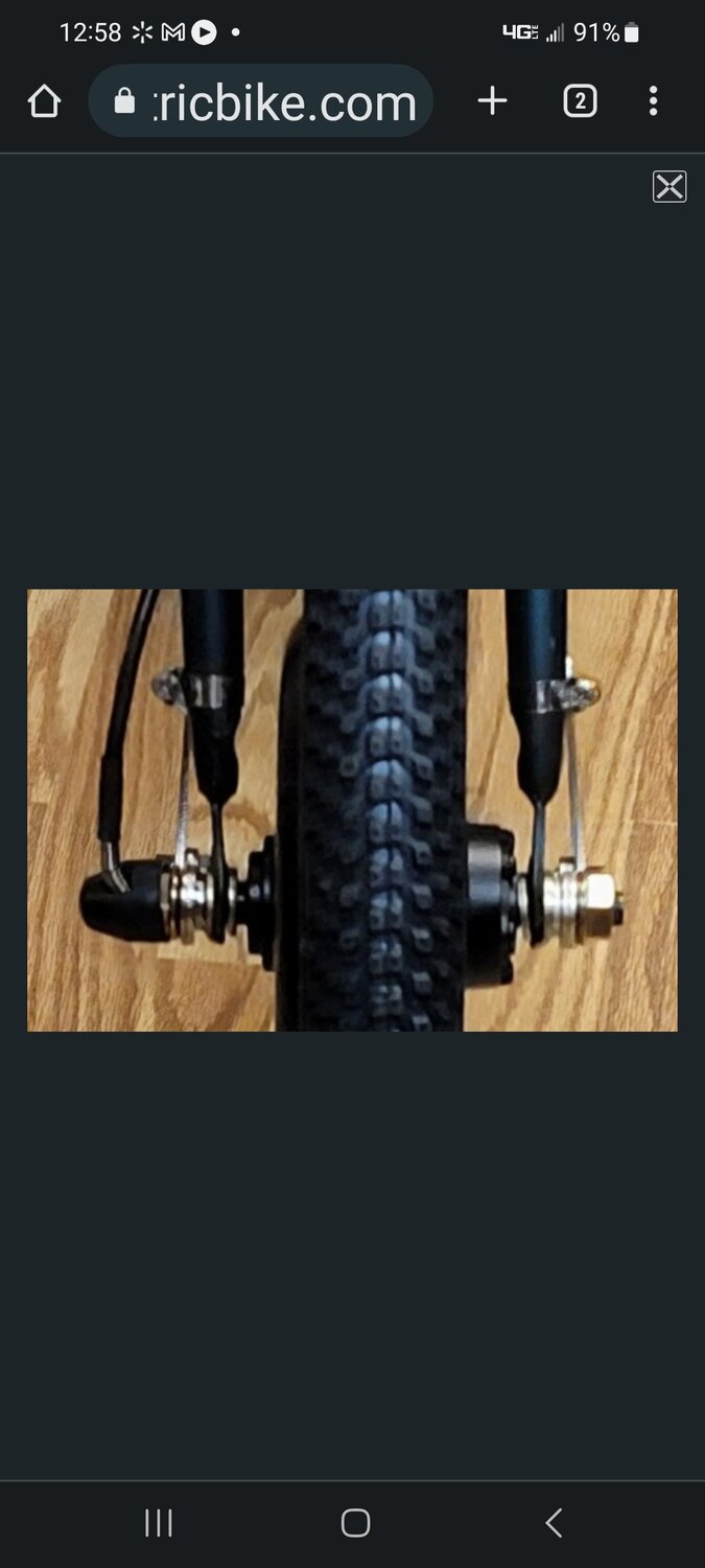

Could it just be, my torque nuts not able to keep the wheel from turning
No.
The torque arms and nuts are to keep the axle from spinning.
If the axle was spinning, then the cable coming out of the axle would be spinning around.
You could have your bearings too tight, but if your wheel spins freely (well, almost freely, there is some motor drag) then your bearings aren't over tightened.
Your forks are most likely bent from the power and weight of your motor/wheel.
