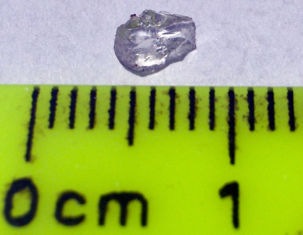

I had 30 miles on my Abound when a sandlike particle caused a flat. I bought Schwalbe Pickups, which are supposed to be highly resistant to puncture. After 1,000 miles, I had my first flat Thursday. This time the particle was bigger than a grain of sand. It went right through the thick part of the tread. I guess for low rolling resistance, modern bike tires use rubber that's not as tough as other tires.
Tubes or tubeless? Guessing tubes. Were you using any kind of sealant? You probably wouldn't have had a flat if you were.
