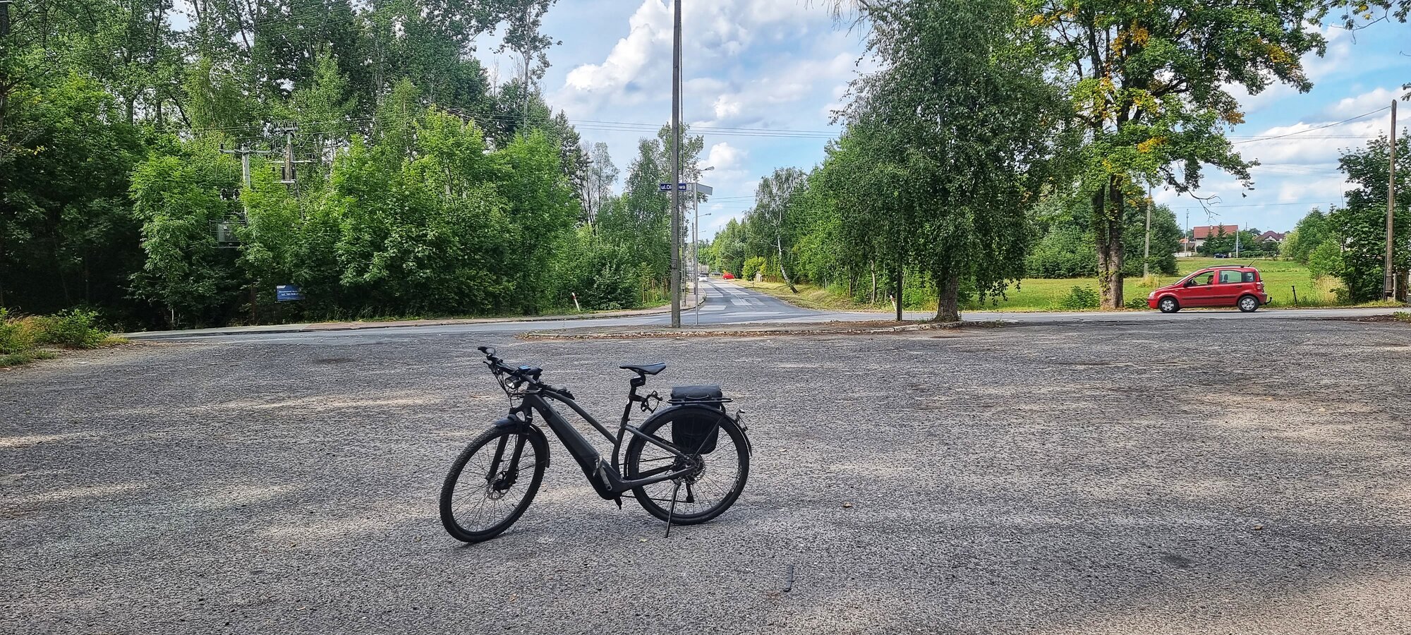

A current photo of my older Vado 6.0 on a 70 mile ride 😊
