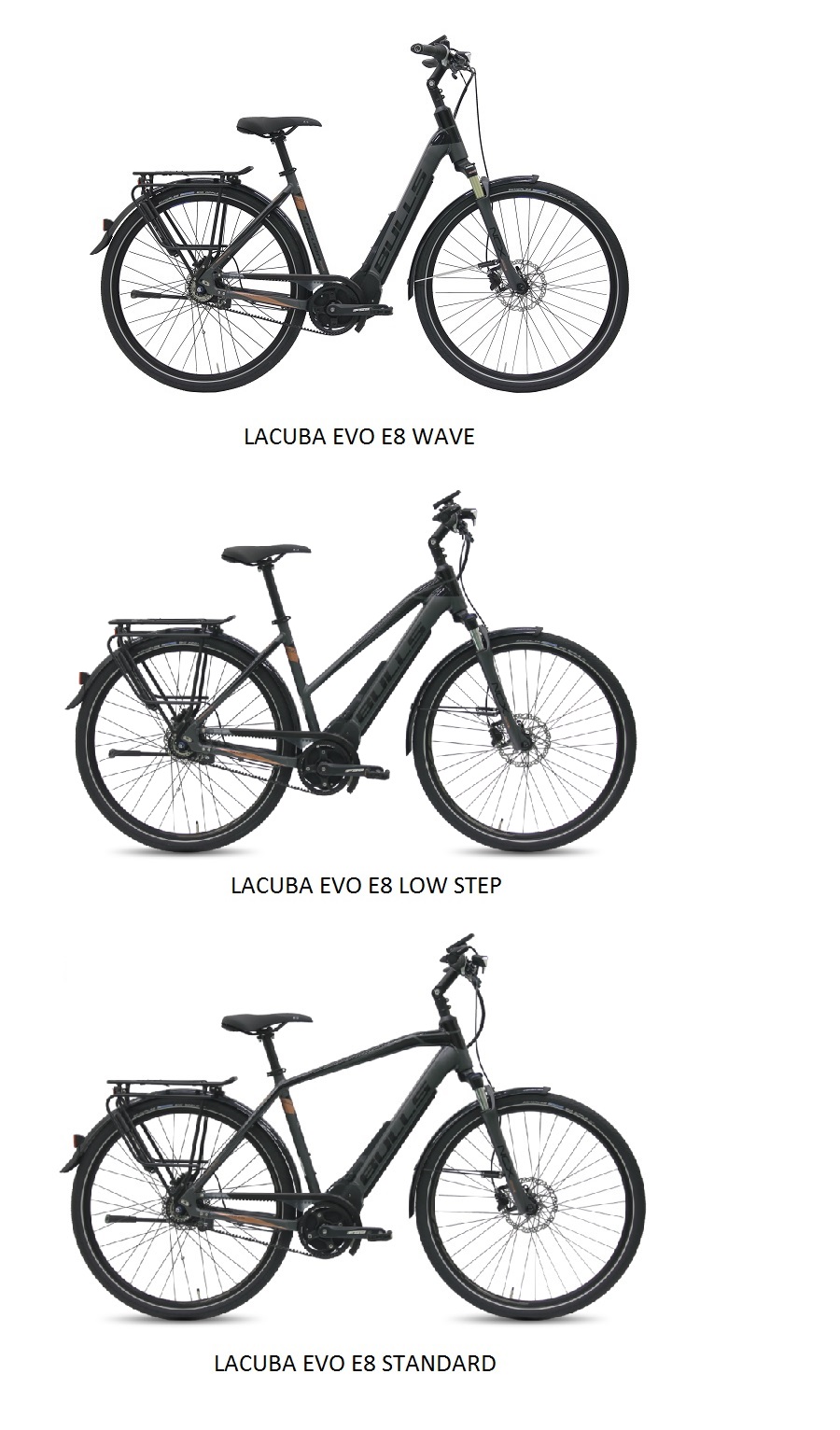

Looks like you picked the wrong frame style.
I have few female friends who have bikes very similar to this (deep wave) and it works fine. <20mph, light weight rider, they won't notice it.
You should have picked a step-thru as @Mark Peralta noted, not the wave frame. The step-thru frame has a reinforcement bar near the bottom bracket to eliminate any possible wobble.
Being a heavier than average rider myself at 230-240#, -varying during a typical year, I too have experienced speed wobble on a couple of different bikes. Before my 1st ride on the EG Zurich 350 IX (step-thru design), I wondered what was the purpose of the front fork "deflopinator", and actually, the deflopinator doesn't correct the speed wobble -so I continue to wonder.
A 30# steel frame bike (like a regular pedaled Bianchi Castro Valley commuter) induced quite the wobble on a downhill when I reached 44mph one time. That was terrifying when just ahead of me a group of 3 slower riders pedaled along side by side.
Experience with e-bike wobble has been more staid and controllable with nearly 7000 miles on an EG Zurich 350 IX Step-thru e-bike.

Thanks bikerjhon, glad you shared your 'wobbling experience'.
I believe from the beginning I had a wrong approach.
Yes, I started the thread by asking to recall and discontinue the bike without considering the main issue.
I live in a small community on the British Columbia coast. The location is a retiring favourite spot (among many reasons) because of its temperate weather (compared to the rest of Canada) where you can cycle, golf and do all outdoor activities year around.
As expected, demographics are 60+, overweight, a large proportion suffering from various degrees of disabilities - I included- who, still try to keep an active and healthy lifestyle.
The introduction of the e-bike is a revolution for people like me. It created a 'Market Sector' of people who for many reasons (read above) had to abandon cycling. The e-bike re-introduced me, and people like me, to the market and the possibility of getting back to an activity and sport we always loved.
No doubt, I have the bike already for a year and yes, I'm back on the road enjoying the activity. Several friends followed my experience and they are now also on the road (NOT with a Lacuba Evo Wave).
No steep hills were a challenge for me 10 years ago.
The e-bike brought me back the opportunity to deal with them -still pedalling-.
However, I was used to hitting 40+ mph (70 km/h) downhill on my daily commuting to work in Vancouver (a city with a topography similar to San Francisco). What a thrill! Wobbling? NEVER, ever. I used for commuting two different bikes, a road and a mountain one. I didn't know what 'wobbling' was.
True enough, a motor is helping me climb the hills now. True enough, I still crave for the descent.
And almost got killed, twice.
Who to blame?
Me as an experienced -and irresponsible- cyclist?
The manufacturer of a flawed design?
The dealer?
I don't have the answer. However, I do know now what might have prevented the situation.
A VERY LARGE ORANGE LABEL on the bike, stating something like:
This is a step-through bike. As per its inherent design, an extremely dangerous situation may develop leading to severe injuries or even death. Under ANY circumstances do not to exceed the speed limit of 20 mph (32 km/h) or extreme wobble of the front wheel, leading to the loss of control of the bicycle WILL occur.
KEEP both hands on the handlebars at ALL TIMES.
In addition, I would've expected the dealer selling the bicycle SHOULD HAVE KNOWN this model was NOT an option for me.
Somebody, anybody without technical background on bicycles, not reading forums or in-depth reviews are making their decision based on any number of considerations INCLUDING (1) the prospective rider expectations/limitations, (2) the advice of the 'experienced' dealer and (3) the characteristics/limitations of the bike as provided by the manufacturer.
In my particular case, I miserably failed to pick the right e-bike for me. I relied only on option (1). Options (2) and (3) were missing.
If you have patience an time, please refer to the review of the 2017 model (the one I have). If you compare it with the new 2018 model review, you will notice the 'wobbling' issue comes up as a 'con' for the reviewer. It was NOT pointed out in the 2017 model. The 2017 and 2018 frames are identical.
In summary, a step-through bike is a.... step-through bike, that looks like a step-through bike and behaves like a step-through bike, to be ridden on flat terrain at very low speeds keeping your hands all the time on the handlebars.
