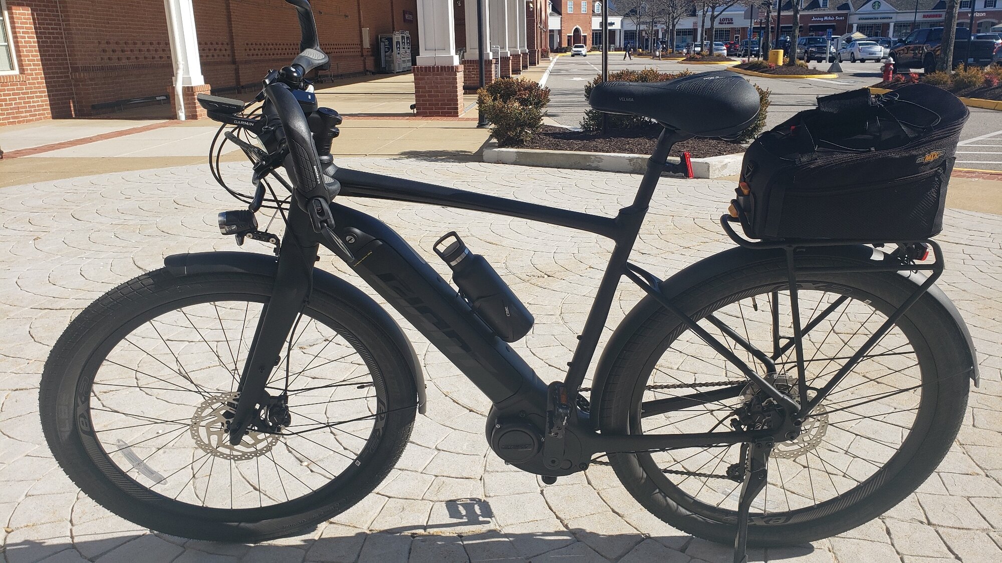

I have the 2021 Fastroad E+ EX Pro which is a great bike. This motor is really strong, and I ride exclusively in ECO mode, because frankly, the motor is so powerful, that I don't need a higher level of assist. At 6'3, and north of 250....I still get 50 to 55 miles out of one charge, which is perfect for my 40 mile loop ride. Of all of my ebikes, this is the favorite. It is so much fun to ride, I wouldn't mind having a second one as a backup....lol.
