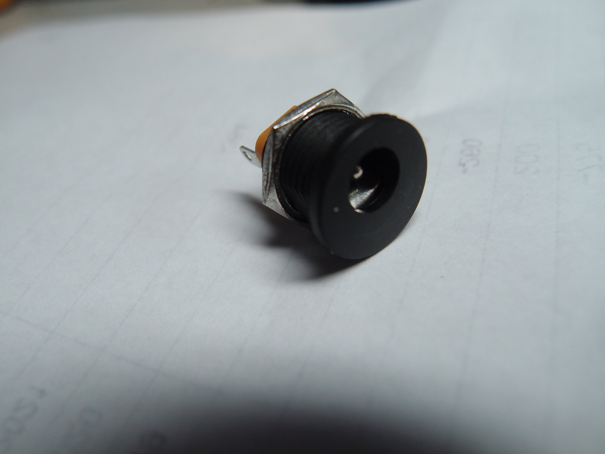

Bad picture of the jack for the popular Hailong-2 battery. It's mounted in a plastic bezel. Can't take much heat at all.
I'll grant you that the XLR and XT60, etc are the way to go if you're going to do 5A.,
